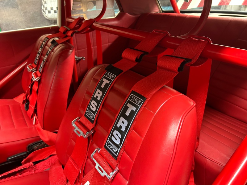

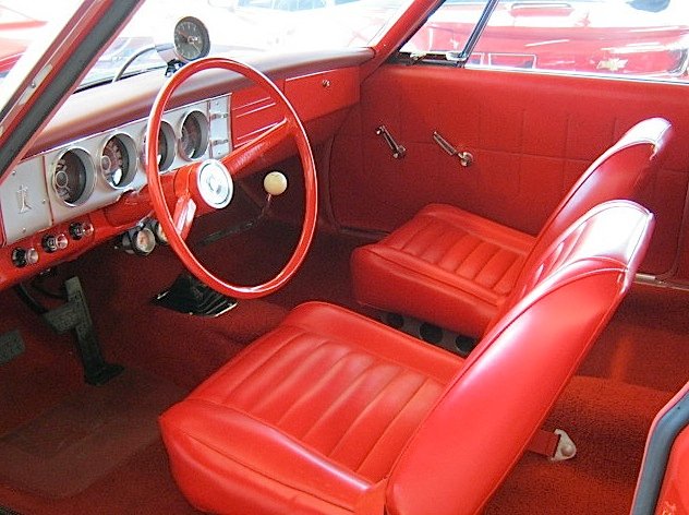

thanks for the kind words ,this photo is the one i sent to the trimmers ..Luckily i had the door cards that came with the car or this would have never happened ...the post car door cards are almost unobtainable and the tops are highly sort after as they are longer than the other types ...... one of the pictures i sent the trimmer which is of a 1964 Hemi lightweight

rocket70 wrote: Mon Feb 26, 24 4:20 pm Looks great Pete.
Who did you use for upholstering?
CW TRIMMING,, Henfield just outside Brighton ....I think he done a great job considering it was just from pictures...

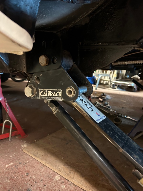

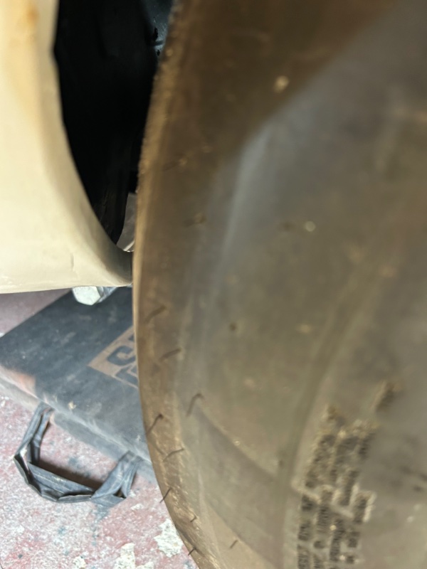

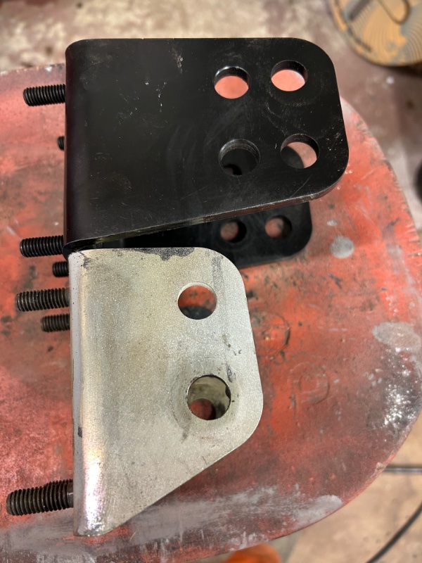

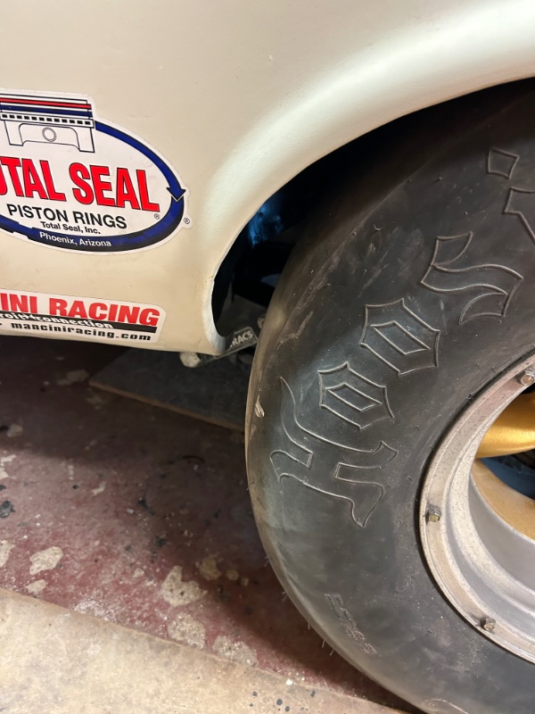

Another day in the garage moving the axle back this time .I should be able to run a 30 inch slick but I have had no room at the front of the slick .So after lots of googling I think my problem was a 20” front section monoleaf on a stock size front spring hanger .So I ordered a longer front hanger to move the axle back .Also my rear spring hangers were facing forward which I have learnt is a no no ..
pete walton
Posts: 1402
Re: 64 Plymouth Belvedere post car
Post by pete walton »

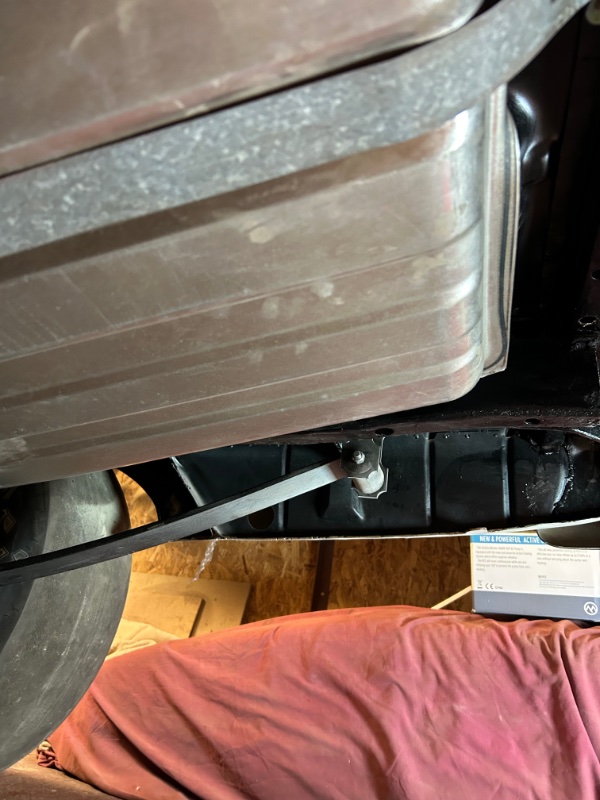

Marc Sheridan drilled the new hangers perfectly and it all seems bang on with the rear hangers hanging straight ..As with all these stories there is a negative rear flexible brake line is like a guitar string and the propshaft is to short but this I knew would happen ..Now we can order new slicks and move forward again ..we seemed to be back to sideways photos which I am sorry for ..
