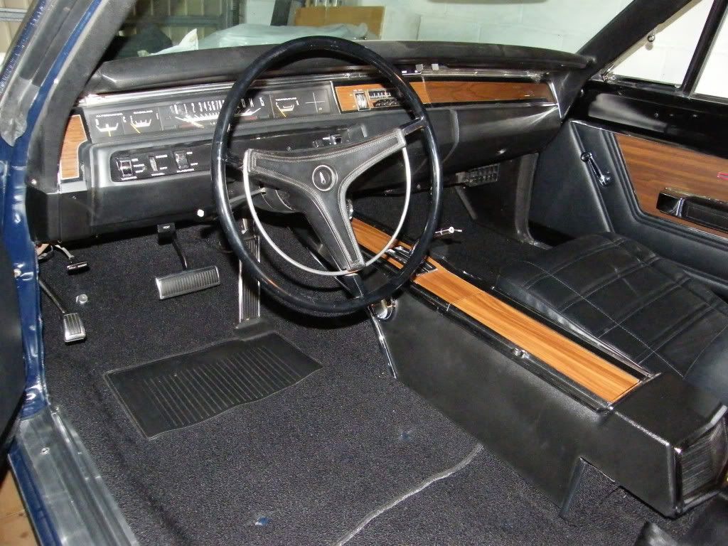

Got the steering column in yesterday, as planned, but not sure if it's in right tho
I posted a question HERE......
dunno if anyone knows the ins & outs of b-body steering coloumns?
Anyhoo, it's nice to have one thing less cluttering up the floor
