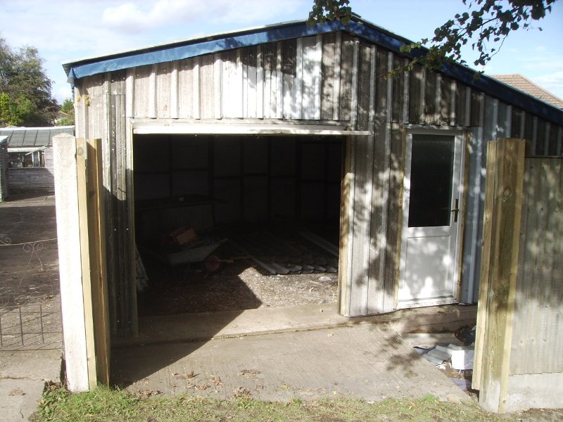

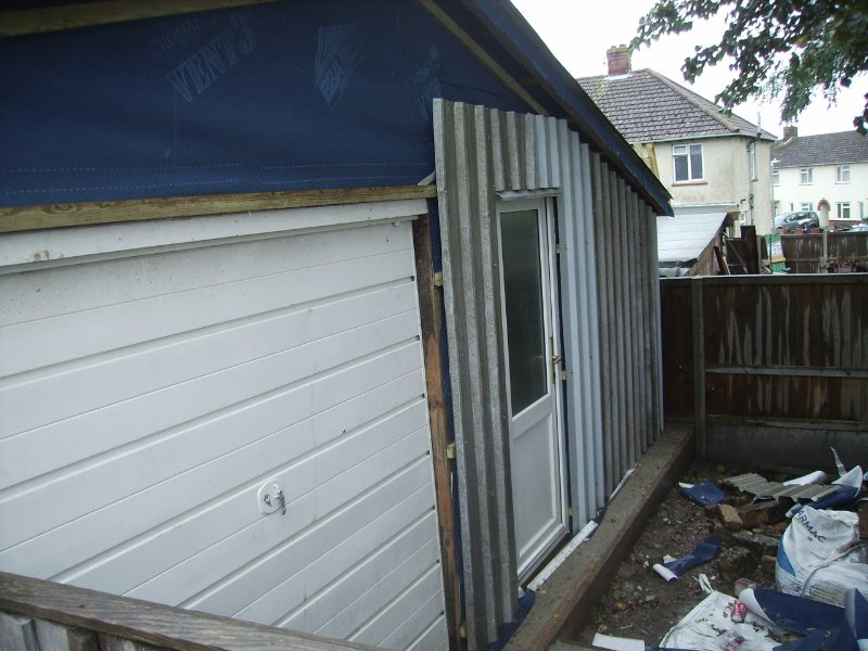

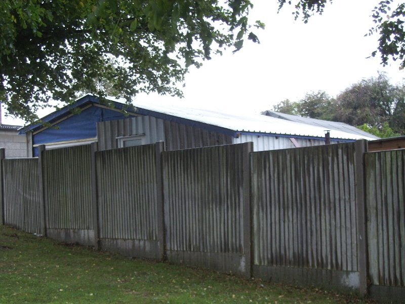

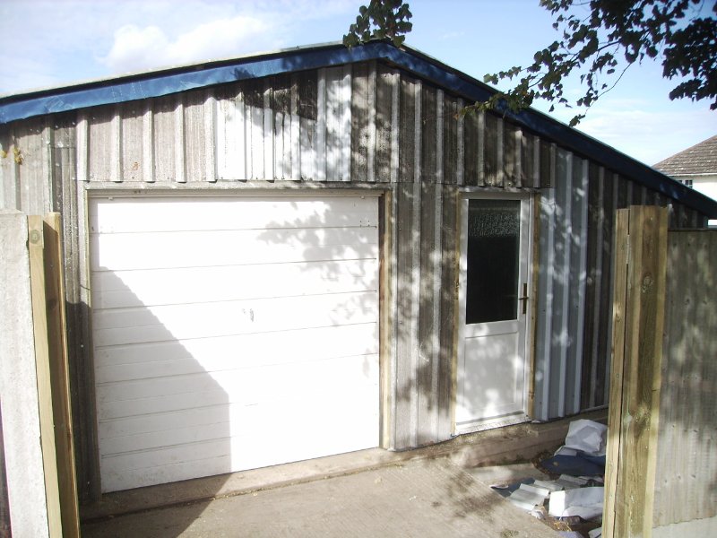

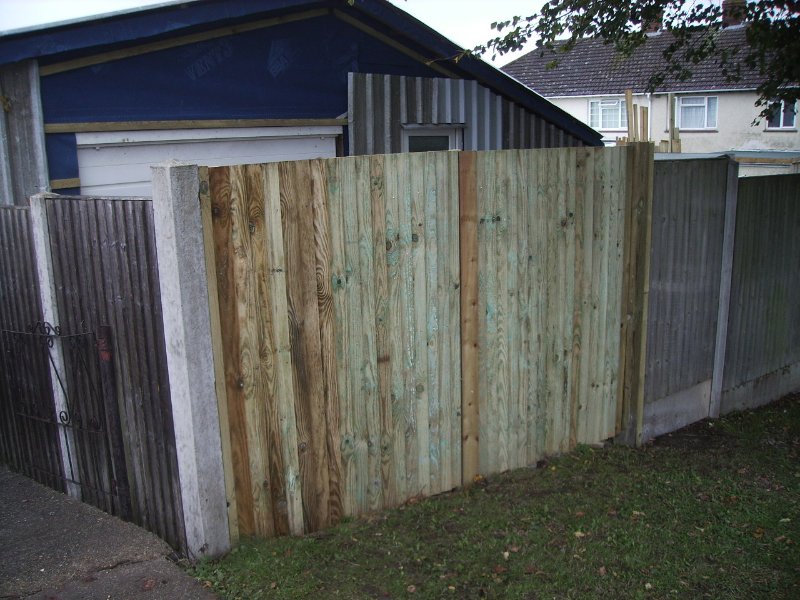

the rain eased a bit so i popped over and got some pics
nev (the fencing guy next door) is making the gates this weekend so access won't involve lifting fence panels out
i can't get much better pics of the outside as it's got a 6 foot fence all round and other than the front i've built right up to the fence line.
neil.

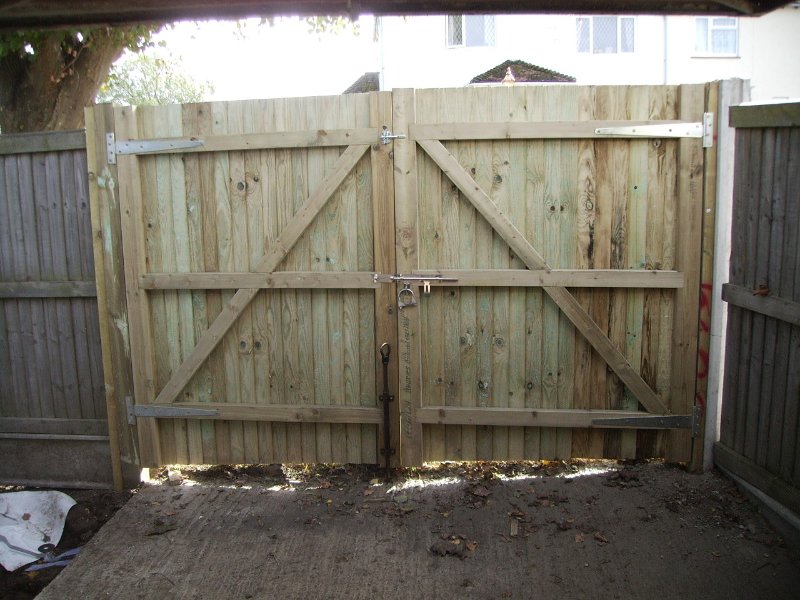

we fitted the gates yesterday in between the rain and nev's made me a personel gate to replace the half fence panel left after fitting the big gates. hopefully we'll get that up tomorrow.
neil.
neil.

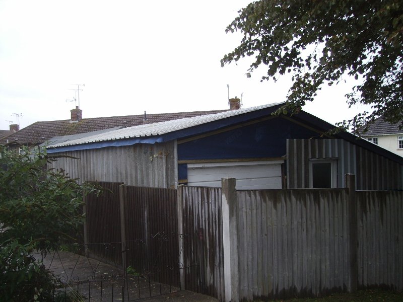

the rain stopped mid morning so i cut and fitted the rest of the cladding to the front around the doors and cut ridge tins from leftover cladding and fitted them. then i fitted some leftover battens either side of the 2 doors as trim pieces to neaten up the gap from door frames to cladding. lastly i fitted 2 bolts inside the up and over door for extra s4ecurity and fitted the gate catch and long padbolt to the new big gates.

the last gate's all hung and padlocked and nev gave me a top tip about fence panel security. screw a 2 1/2" screw diagonally at each end of the panel's cross braces pointing in towards the corner of the slot in the concrete posts. they pull the panel tight to the inside of the slot and prevent the panels being lifted out. he wasn't kidding either, all the panels i could get to are tight in place with no chance of moving them. i may do it at home too, we've got a couple of panels that rattle when it's windy. the small gate is just like the bigger ones so not worthy of a pic. oh, i also bagged up all the leftover crap and did a tip run so there's room for the next ballast delivery.
neil.
neil.
