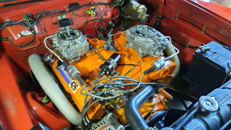

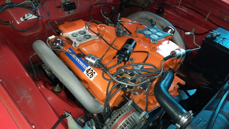

The fact that we haven't posted on this thread for so long shows how reliable the car's been over the years, so we were a bit surprised and disappointed that it started playing up around the time of the 2022 Euronats
Just put this on fb so I thought i should get it on here before I get told off

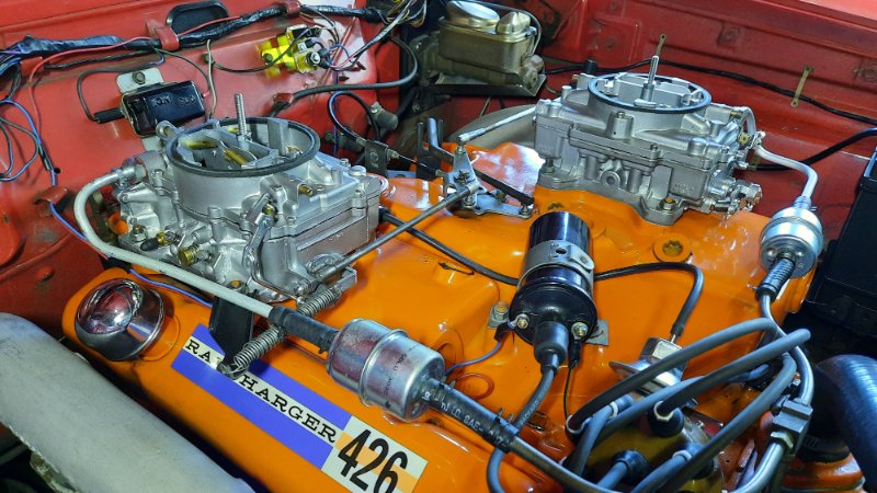

Haven't used the 63 for over a year as we've been chasing a misfire which became a no-fire!
We replaced all the ignition parts (Firecore distributor, coil and leads) but found the dizzy didn't rotate freely
so with a fair amount of help from our MMA mate Ian Mitchell (Herts meeting regular), we got it stripped and rebuilt back to where we could fit it.
In the meantime, Geof Hauser gave the carbs a once-over... not the full refurb we wanted but a quick clean and check there was nothing obviously wrong with them.
Ian came over last weekend to help install the dizzy correctly
and we got it started and idling without a misfire for the first time in ages
Took 'her' out today to make sure it didn't misfire or stumble under load. Which it didn't thankfully.
Driver side plugs are still very sooty and the carbs don't really respond to mixture screw adjustments so they still need a proper looking at, but happy the car's up and running again
I did add a couple of short vids on facebook but you'll have to make do with this obligatory engine shot

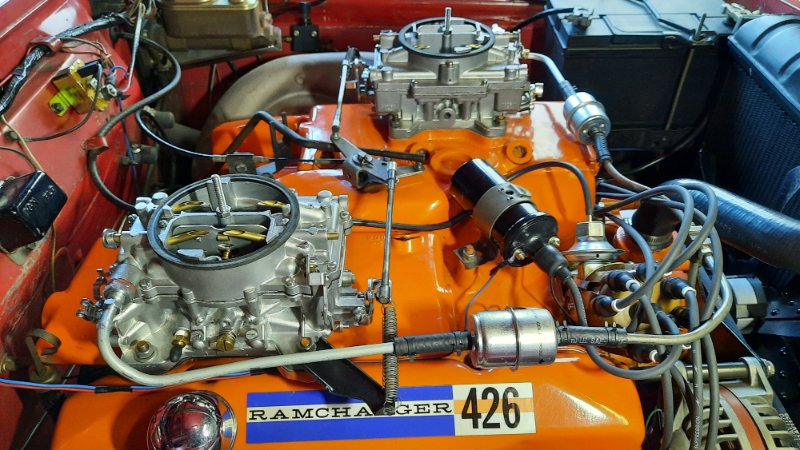

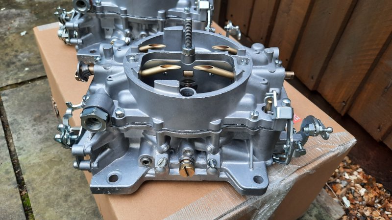

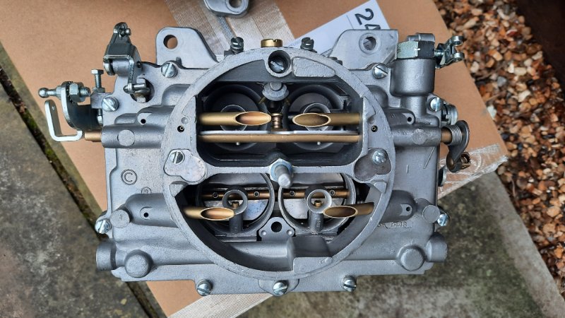

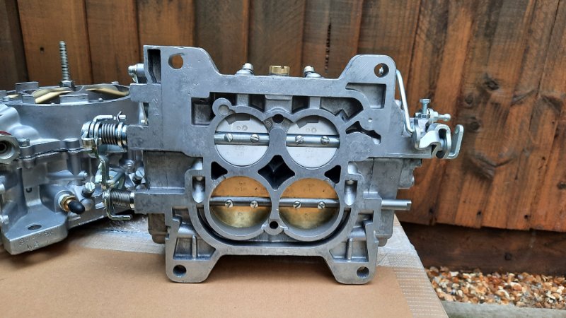

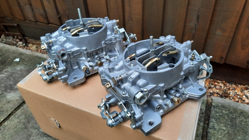

So... a couple of months back we got to the point where we realised our original (to the engine) carbs really could do with a proper rebuild. They were supposedly rebuilt 20 years ago just before we bought the car but judging by how the rest of the engine was thrown together, they probably just had a rudimentary clean up at best
As no one we knew wanted to get involved we had to take the chance on finding someone ourselves and settled on the safer option of a UK company rather than shipping them over to the States or Canada. Best option we could find was Coln Engineering down in Gloucester. They had some experience with Carters which is quite a rarity over here so we took the plunge and dropped them off with them the week after Easter.
https://www.colnengineering.co.uk/
After discussing what we thought was needed, and what they could offer, we agreed to have them disassembled, ultrasonic cleaned, spindles rebushed, steel parts replated, reassembled and bench set-up and tested. We supplied a rebuild kit from Mikes Carburetor Parts https://www.carburetor-parts.com/
which arrived within a few days and a screw kit from Laysons Restorations
https://www.laysons.com/
which took a few weeks... true to form, but at least it arrived!

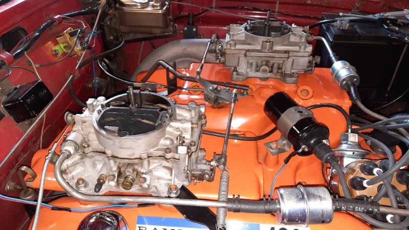

I'm still waiting for any photos that Coln took during the strip down and rebuild but here's an idea of what we started with...
Then after 5 weeks (3 weeks waiting and 2 weeks work) they came back good-as-new

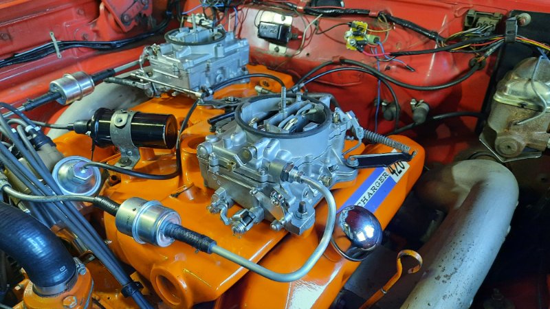

Then today, with the help again from MMA-mate Ian, we got them fitted with new fuel lines and spent a bit of time (understatement) setting the idle mixtures and getting them balanced.
Then on the 2nd turn of the key 'she' started right up and was idling smoothly within a few seconds - rather than the usual few minutes after a few turns of the key!
Road test started off well too; no stumbling or pinking under load, but after a while we did notice a bit of hesitation under load
Back in the garage, earlier suspicions of a vacuum leak were confirmed by spraying some WD40 and brake cleaner around the base of the inlet, in the only place it's accessible (centre of this photo, where the inlet meets the head). We confirmed there was a leak using the the rubber tube in the ear method - we could hear a similar noise to when we put the other end of the tube in the carb, for balancing
So just when we thought we were all set to use it for Brooklands, we now need to replace the inlet manifold gasket(s) and may as well do the valve cover gaskets while we're at it as they are tricky with the inlet in place.
One step forward, one step back, but getting there

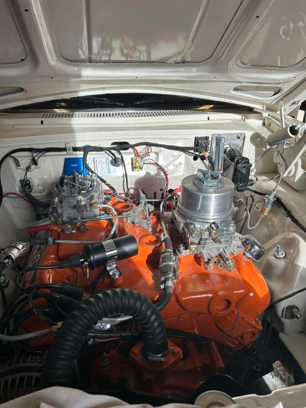

Re: Rob & Stu's 63 Polara 500
get Marc S to make you one of these ,i find it easy to use better than vac gauges ,,,,Sorry about the problems but they are easily solved if not rather annoying ...One thing i have found out is the stock MW air filters choke the life out of my engine ,,,It runs very rich with them on and i do not want to go down the route of rejetting as it runs perfect without them on ....Looking for some mw velocity stacks but they are no longer available as copys ....keep struggling on
- 424624593_25041534478795405_4495341666087367648_n.jpg (104.69 KiB) Viewed 8293 times

Thanks Pete, it's good to hear you have yours running well nowpete walton wrote: Sun May 19, 24 8:22 pm get Marc S to make you one of these ,i find it easy to use better than vac gauges ,,,,Sorry about the problems but they are easily solved if not rather annoying ...One thing i have found out is the stock MW air filters choke the life out of my engine ,,,It runs very rich with them on and i do not want to go down the route of rejetting as it runs perfect without them on ....Looking for some mw velocity stacks but they are no longer available as copys ....keep struggling on
We modded the base of our Sport Satellite's stock type air cleaner to add a bit more gap where the air gets in - it's about 1/4" now instead of 1/8". still not much but enough to make a difference, hopefully
I saw that/those contraptions when you posted it a while ago but still dont know what they are? Presume that's a manometer on top? Do you only have one?

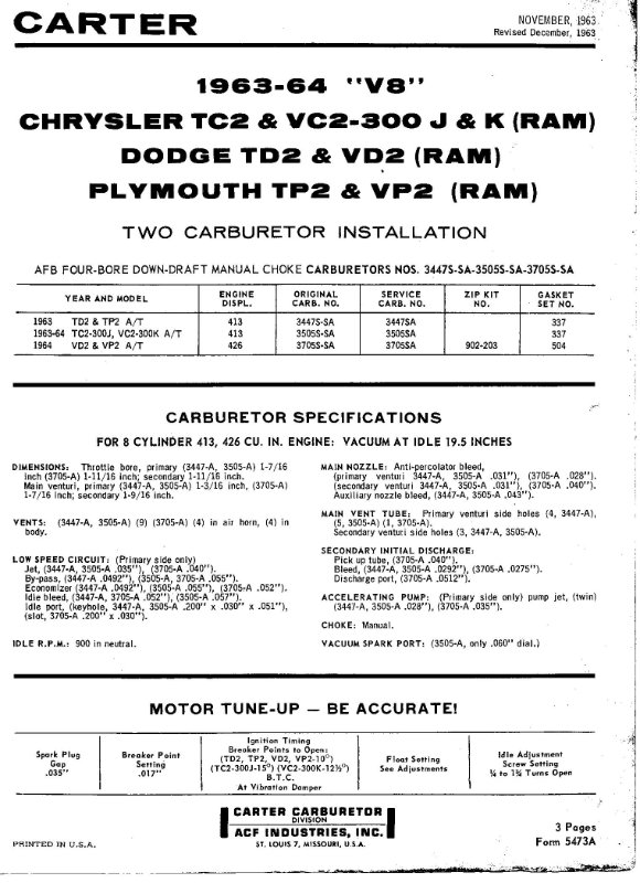

I meant to add, another indication that we still had a vacuum leak was, using the vacuum gauge, we could still only get around 5 inches at 900-1000 rpm idle. The data sheet we have for these carbs on this engine say they should have 19.5 inches at idle (idle being 900 rpm). Sounds optimistic
It'll be interesting to see what we can get when the inlet gaskets have been renewed
