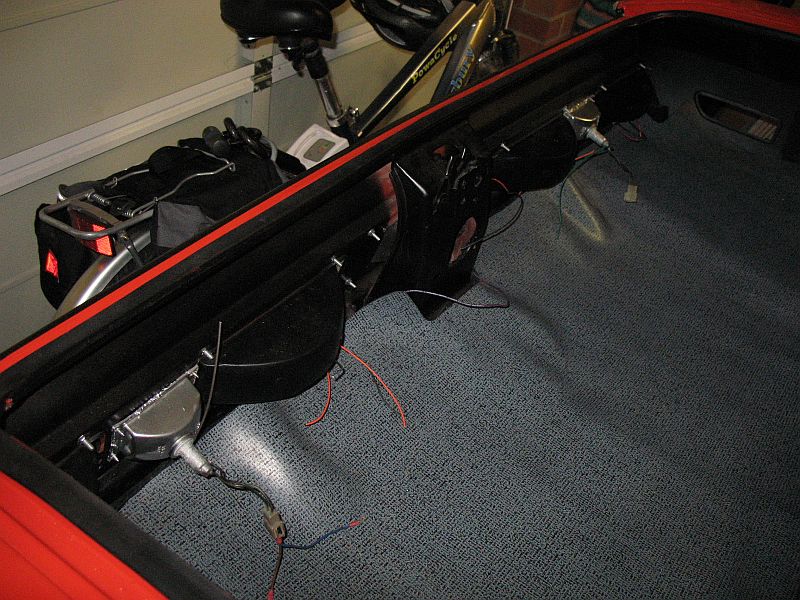

The rear lights are an minor example. I fitted separate turn signals years ago to save MOT hassles. So I have to wire them different to stock of course.
Luckily Painless include a "third brake light" wire so I can use that for the brake side of the stop and tails and wire the other end directly to the brake switch.
The stop and turn signal wires then just get wired as turn signal only.
It does mean however that I have to use crimp joints for now to get it all working. These I will later cut, solder and insulate with shrink sleeve. Once I am sure everything is wired right.

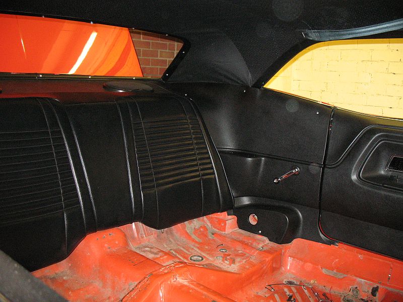

Since I am sure I have all the cables I need running to the trunk I have wrapped them and fitted the interior panels and rear seat back.
I did that to give myself encouragement by making the car look like it is coming along.
Bit more interior added Just to make me feel it is coming along. It needs a good wash before the carpet goes down.

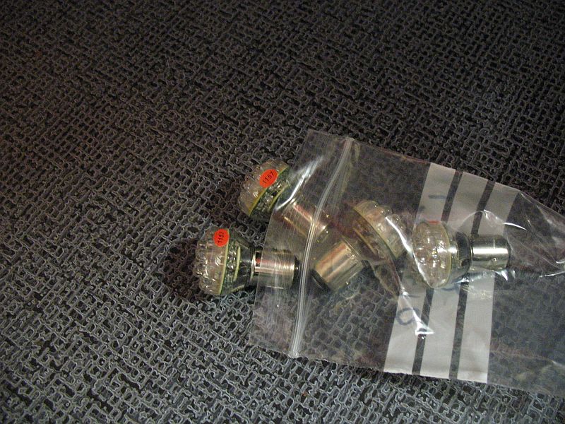

I am using LED lamps as much as possible on the car to minimise current demand. These are the stop/tails.

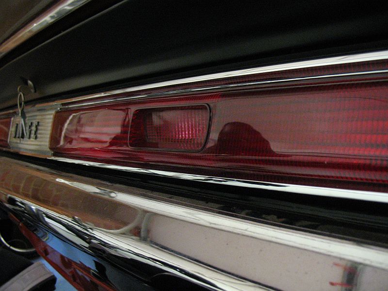

The turn signals (silver) sit between the tail lights.

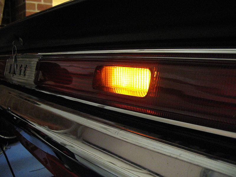

Indicator on for test.
My rear lights.
My rear lights.

Dave,just check the led bulbs showing through the tail light lenses as leds produce pure colour,which looks best through a clear lens, and I have noticed that showing through a red lens will dim the effect of the normal brightness of a led.
Hope that makes sense as Monday night is pub night!!! :drunken: .
What I`m trying to say is put a led in one side and a normal bulb in the other and compare........Easy when you put it that way huh??? :thumbright:

RichDeb wrote:Dave,just check the led bulbs showing through the tail light lenses as leds produce pure colour,which looks best through a clear lens, and I have noticed that showing through a red lens will dim the effect of the normal brightness of a led.
You can get white ones as well Rich thats what I purchased, when tested they were fine and a lot brighter. :thumbright:
Very Neat Dave.
They always tell you to use a RED LED in a red lens when you buy them. So that is what I have done. They look pretty bright to me. :thumbright:
I have not actualy seen any white ones.
I would like a white or amber stop/tail for the front turn/park lights but cannot find one on the internet for love nor money.
Anyone seen any?
