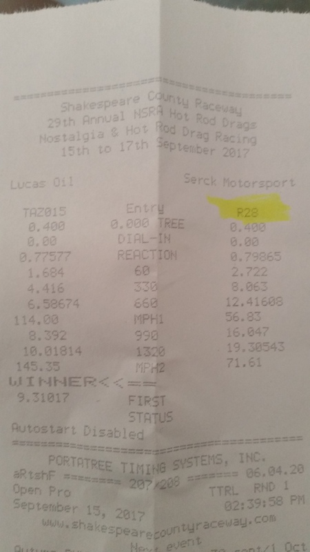

The next round of modifications are a bit more significant in getting the car the way I want it.
With all this bolt on stuff I'm always interested in the improvement/reduction/increases etc. That being said I wanted to get a benchmark so I can see if what I'm doing is going in the right direction.
Up until now I've postponed doing anything in fear of breakages and embarrassing myself, but after watching various cars do their thing at the NATS, I'd decided the HRDS and the 1/4 mile would be the best bet (also closer to home for the AA).
So took Friday off work in a hope it would be a little less busy then the Sat and Sunday and dry.
Morning weather was typical UK in as such that any time the track got near being ready the drizzle started for 5 mins. Scrutineering cue was massive so kept putting it off. Mid afternoon the weather played ball and the cue was small, so I managed to talk myself and Chris (Birdman) into helping me get the car on track. It was also a chance for me and the car to tick another thing off the bucket list.
At this point:
1978 318 LA motor in stock low compression trim. Holley 600 running through an Eddy Intake. Dougs Headers and true dual exhaust. Ran without the hood and no rear interior, so realistically it's as light as the car is going to get. Street tyres 235/60/15 on rear running through a 7.25 open with 2.76 gears. Old tired rear suspension to go with it. Temp was around 15 deg.
Both runs were done in Drive so all I had to do was point and shoot and listen for bangs and smoke. :D
First Run:
20.66 at 66.83
Got to the end and happy that the car was running okay, but knew I'd left some in the table
So drove straight back round and pushed the car a bit harder!
Second Run:
19.30 at 71.61
Bit of wheelspin off the line and into second no issue but after 45/50mph and 3rd it just falls over.
Without a tach I didn't want to risk manual shifting, so that's on the list of things to do. Feel it maybe shifting into 3rd too early. In reality I recon there maybe a high 18 in it as it is, but that'd be about it for the car as it sits today.
So thats the benchmark set....19.30.
The Proof:

Super Sloth wrote:Good effort, Dave! Bet you enjoyed giving it large on the track!? 8-)
Don't bother taking the hood off next time as that will have cost you quite a bit at the big end - maybe a second and a half? It really upsets the aero having no hood.
You know how closely matched our Demon and your Dart are both being '72 california cars and all the oddball parts they share?
I think your current setup has a lot more to give.
I can get our car down to a consistant 18.3 but the MPH is the same as yours. That suggests to me your engine has more grunt than mine and is pulling harder at the big end. I guess thats the superior inlet carb and exhaust that you have? We're still on a 2 barrel and factory two into one collector/ single tailpipe.
I manually shift our car - no point in winging it to the moon I just let her rev out to the point I think the engine revs will drop down to the peak torque point when the new gear engages.
I think if you get the opportunity you aught to run her again before you pull the engine. If you put the hood back on I reccon you'll smash my ET and get the mph figure up a few points.
I've just got a hunch given she's so similar to our car and the benefit of your bolt on goodies she might have a 17.99 in her as she sits??? :thumbright:
See what your saying but in reality my fiberglass hood with its massive scoop is not really the height of aerodynamic efficiency. I'd be interested to see your timing slip, as if your crossing the line at the same speed I'd expect out ETs to be the same, not 1 second apart.
Being honest I was expecting and would have been happy with something in the 17s. The 19.3 to me proves that the motor, though reliable is a performance dog with a crap CR. All I can find is that in 77 it was dropped to 8.5 1 at 145hp. Given that it's an unknown entity and an old rebuild, then I'd expect my HP numbers are quite a bit lower than that.
I may actually be loosing a bit of low down torque with the exhaust system and such a low hp output.
Thought process at the mo is to get the rear end modifications done and add a tachometer so I can see rpm to manually shift. Then I'll run it again in spring and see what I have improved hopefully.
