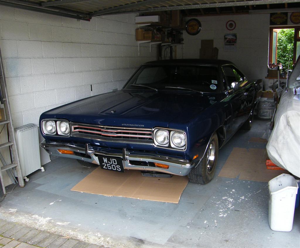

- At least the air filter assy fits under the hood, on top of the Edelbrock Performer - something we werent sure about till a couple of weeks ago. Phew
- DSCF1128 (Large).JPG (134.82 KiB) Viewed 2030 times
- Back in the garage, with the oil catching precautions back in place
- DSCF1125 (Large).JPG (109.35 KiB) Viewed 2030 times
- Cant quite see the oil mist from here but you should be able to smell it
- DSCF1123 (Large).JPG (102.15 KiB) Viewed 2030 times
- Satellite sees the light of day for the first time since 2006
- DSCF1122 (Large).JPG (112.99 KiB) Viewed 2030 times
