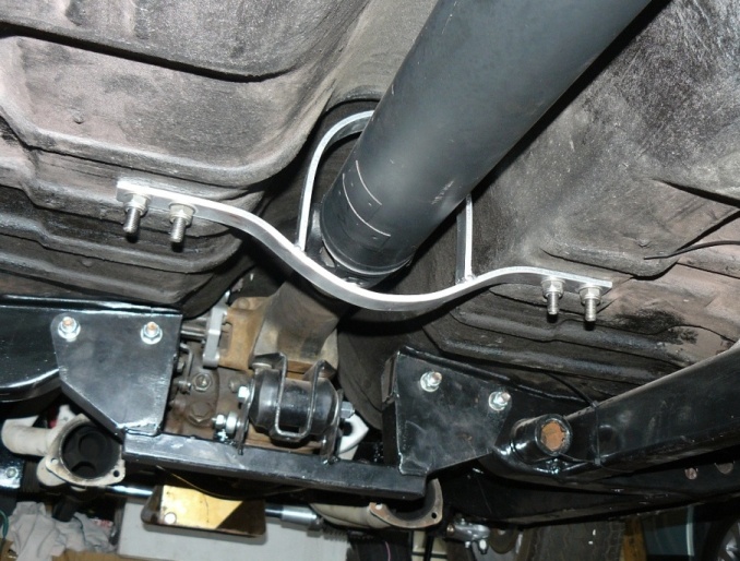

So... I fitted my prop loop. Ah, how I needed that little achievement!
Though this led me to find another little 'issue', the exhausts and the gearbox crossmember are gonna be fighting over the same space...take a look at the pic...
I may even end up with side exits as there's so little room around the 4-link and axle.

- Prop loop.jpg (168.37 KiB) Viewed 790 times

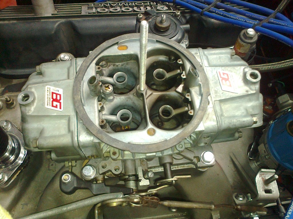

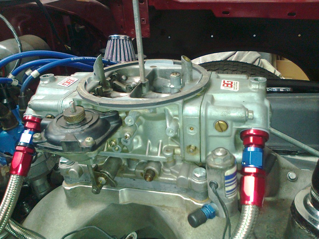

Your problem is a simple one. Don't worry. It is just carb tuning.
If it has a big cam then a carb set up for a stock engine will not allow it to idle. This is because the engine needs a lot more air at idle.
Did you say that is a BG Demon carb? They normally have an air bleed screw you need to open up.
If not then their may be an adjustment for the secondary throttle blades. Crack them open a bit. You will then be able to turn the primaries closed so it idles.
Ah, the voice of reason has arrived
Thanks Dave!
I bought the carb off Mick a couple of years ago. I spoke to him today, he says it's an early BG, not a Demon.
I think he said it was set up for bracket racing? It has jet extensions in the rear bowl, vent baffles and things you'll see in the photos that I don't know the name or purpose of...
It's massively overfuelling i'm sure- you can see petrol pouring from the venturis, I need to sort that first.
I found a damaged O-ring on one float valve assembly, also as Pete says the seals could well be failing, the carb has been stood dry for 2 years since i've had it. I'll order new float seals tomorrow, Real Steel have 'em for about £20 the pair.
I'll strip the carb fully and surgically clean it, i'll make a note of jet sizes and settings and do some serious research over the next few days.
Idle screws are 1.25 turns out.
The BG site only has info on newer Demon carbs, anyone got ideas where I can read up on these older carbs?
Ade (Charger01) has offer to loan me a spare carb to try if I don't have any luck with mine- top fella!
Thanks again for your help folks
- Carb 02.jpg (175.42 KiB) Viewed 724 times
- Carb 01.jpg (187.02 KiB) Viewed 724 times
