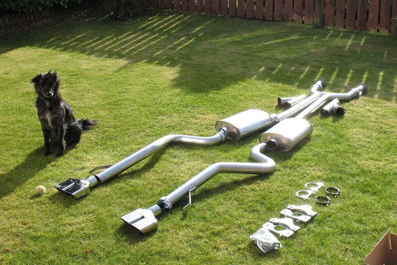

I think I have everything I need to put the exhaust system on now. I just hope it clears the overdrive OK.
Some welding will be required as well. Because of the cut-outs.
I will make a start after dinner. I need to put the prop shaft on first though. If Billy will let me!
- IMG_2178.jpg (181.21 KiB) Viewed 647 times
- IMG_2173.jpg (139.1 KiB) Viewed 647 times

Bugger.
I did worry about the overdrive getting in the way of the exhaust system. However I know a stock exhaust clears so hoped the TTI system would be the same.
No chance. Not even close to fitting.
In fact i am not sure it would have fit that well even without the overdrive to be honest. Seemed a bit short unless TTI headers are a lot longer than my "Dougs".
I am going to have to cut the mufflers-forward sections into at least 4 bits each side and re-arrange them. The cross-over H-pipe will have to be in a different location too.
Hopefully i will be able to do it without changing the way the mufflers hang so that changes to the tailpipe as it comes over the axle will not be needed. But I might need to cut and twist them if the mufflers need to move.
Probably take a fair bit of time to do this. Hard work too. Good job i have a length of 3" pipe handy.
Oh well. Bananarama! happens. And happens and happens....
