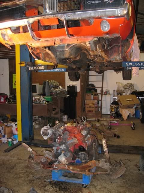

Well i hit my target for the weekend, and got a few jobs done around the house to boot.
So out/off the charger, engine, manual gearbox, together with K-member and steering.

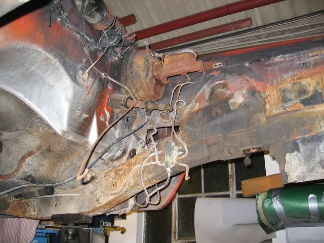

Don't like the look of the brake lines, so looks like i'll renew all this.
If i decide to stay with the 4 speed i'll tidy all ths area too.

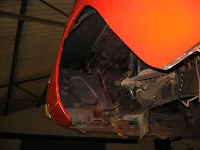

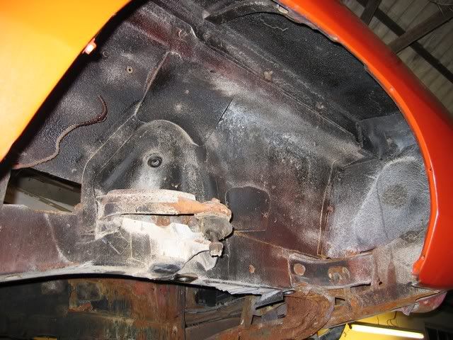

No rot on the frame or wheel arches (what a find).

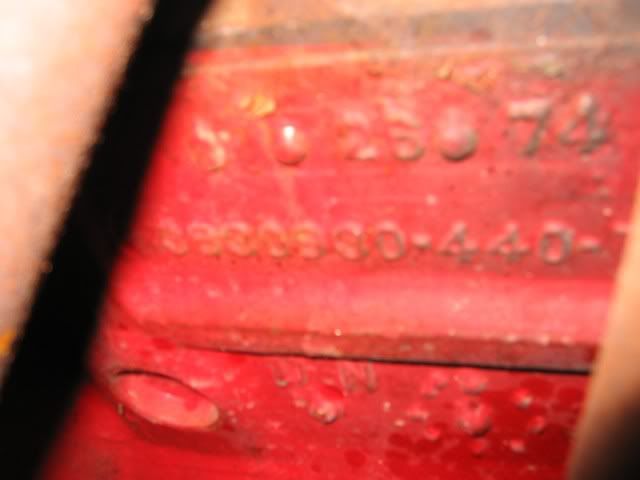

74 block
Thats about it this weekend.
Need to start taking removed parts to bits to clean, and start that shopping list.

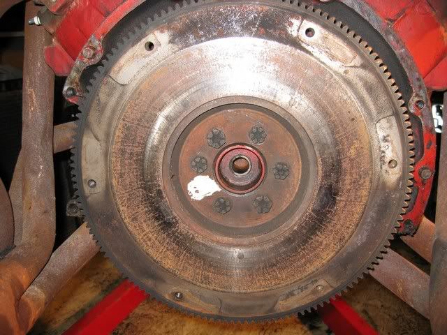

A couple of strange things, flywheel was bolted on with 2 sizes of bolt??? 2 of one size 4 of the other. IS this right, cant find any referance in the manual.

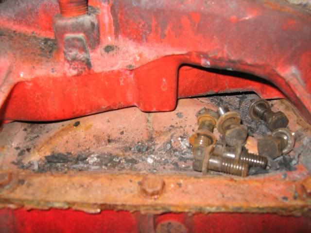

And could this be trouble? The valley pan looks like it has been pushed up, Air expansion from the heat of the fire or detonation damage. No sharp dents visable.
