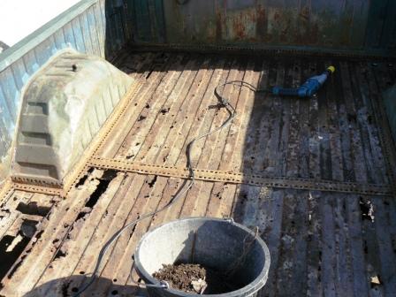

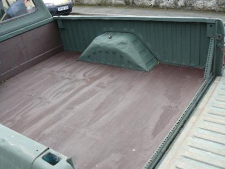

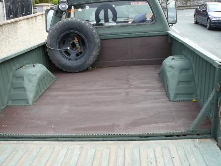

Done a bit of repair on the rear bed.
I say repair, what i actually mean is i've hidden a nightmare of rust under some nice painted wood... You can see the Dexion frame i welded in about 5 years ago which is also rotting now.
BEFORE i did this bodgery, i transported my complete 360 & trans in the back with no ill effects! It's amazing how much strength there is in almost bugger all
Once we've moved house i promise i'll take the back off and rescue it
