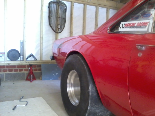

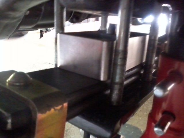

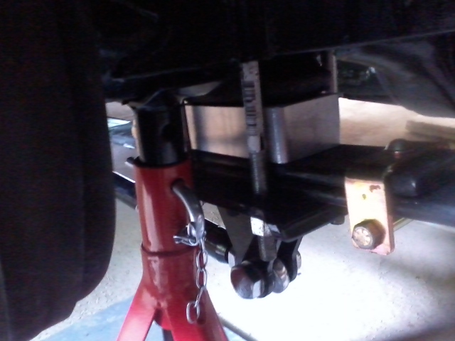

Stuck the lowering blocks in today,not a big fan of them but its a quick fix . They are made nice ,only problem was the pin was a touch to big for the hole on the axle perch.Five minutes with a file and jobs a goodun....
pete walton
Posts: 1401
Post by pete walton »
The car sits about 3inches lower at the back,which is better than i hoped for.....The overall look is better and i am well pleased with the outcome.It needs some 28inch front runners next ..... before and after pictures ,the gap was just over 3inches and its now more than half that ....

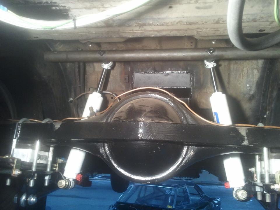

Cars being done by Andy Wright who races the Hot Rod Ford pro mod.... Not welded yet just mocked up ,but here is the new shock mount....
ba racing.jpg (24.44 KiB) Viewed 4682 times
Posts: 6738
pete walton wrote:Cars being done by Andy Wright who races the Hot Rod Ford pro mod....
Andy is a top bloke, he even used to run a B1 motor many moons ago.
Always helpful, talented & loves a good laugh too :D
Surprised you did not go coil over given all the work that has gone into the shocks, and then saved loads of weight on the springs; but I guess you wanted to keep it old school............

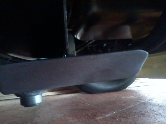

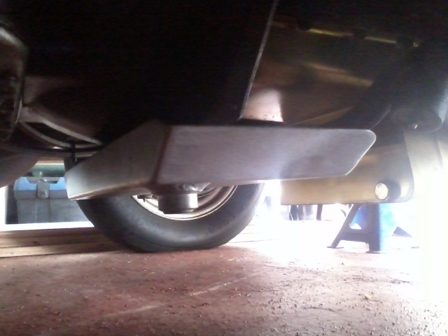

When i had the struts sorted i asked Andy Wright to knock me up a drip tray for under the car.....I have always had this niggly oil leak ,and its fine if you do not mind getting shut of on the line ,or sticking yourself into the rail or even worse sticking the next guy down the track into the rail....Word is the NHRA are going to make belly pans and diapers a must have in all sportsmans class so i had mine made ,,,,,Rear seal and trans always seem to drip of the bell housing ,or in my case moter plate ...It works :thumbright:
It's a sorry day when the car and driver are so old they BOTH need a bag... ;)
Good work there, I wish I had that much ground clearance.........

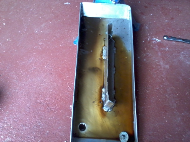

After a not so good Dragstalgia the time to take the gearbox out and get it sorted was upon me....First picture shows that the drip tray i had made ....I guess you could say it works :shock:

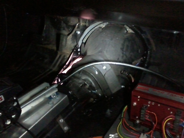

Second picture remove the unremovable removable trans cover :lol: Some of you will get that ,,,,some of you will not

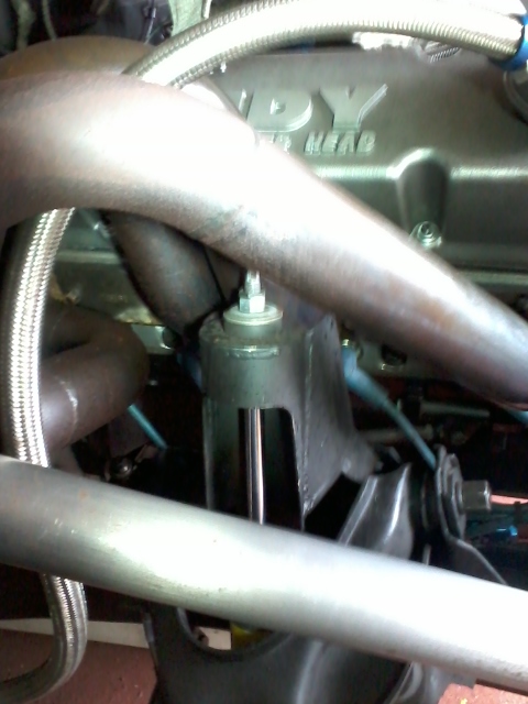

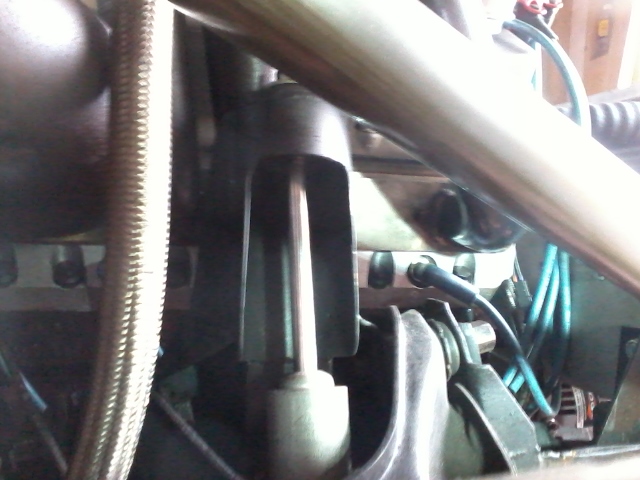

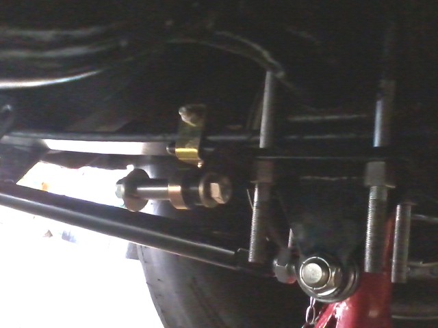

Some time a go i had my front struts sorted out by Andy Wright.He came up against the same problem ,,the headers.....He made the struts freestanding and allowed for the correct amount of front end travel...next week how to takeyour gearbox out using basic kitchen utensules :thumbright:
