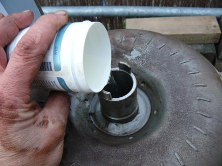

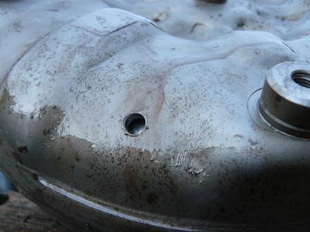

Following Duncs instructions, i've spent a couple of hours today flushing the pipes & convertor with thinners. There's no drain hole in the conv so Dunc said to drill a hole in the front so it could be properly cleaned. I've done several flushes til it ran clear, given it all a blast with the airline and left it to dry out overnight so i can weld up the hole tomorrow.

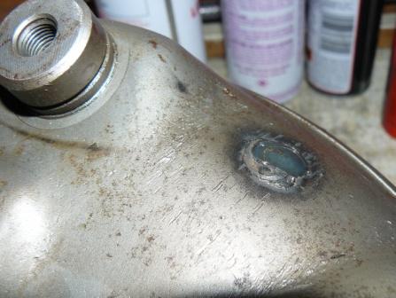

Now welded up, ready to put it all back together tomorrow! :D
