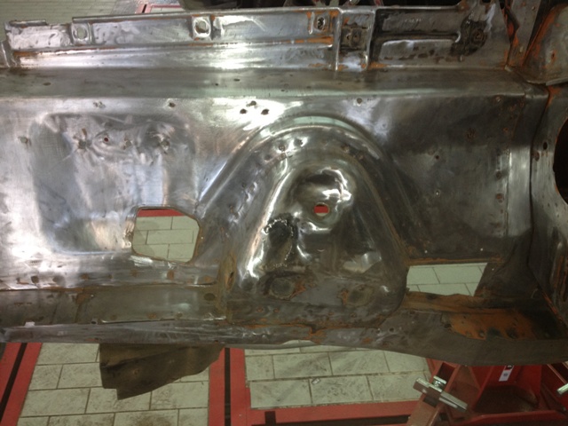

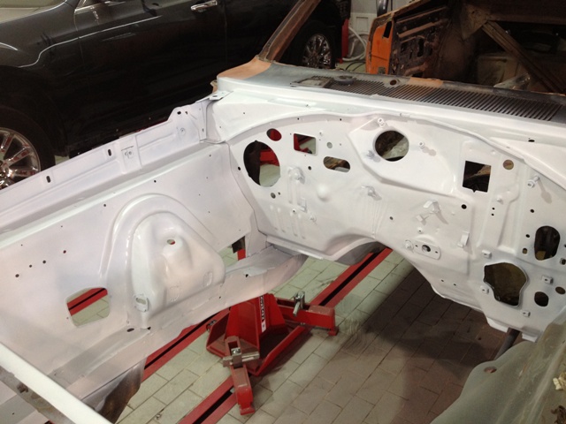

So anyway back in Bahrain, been in the body shop, bare metalled the engine bay and primed her.

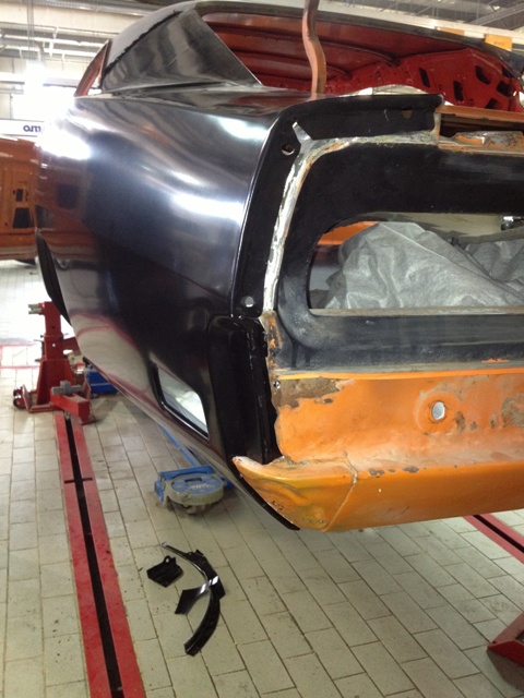

Removed the trunk floor and removed the quarter and wheel housing.
Going to spend the next 2 nights scraping all the old underseal off ready for welding in the floor and painting.
Wheel housing arrives anytime soon and we can fit the AMD 1/4's be interesting to see how they fit as all I have heard is folk moaning about the fitment.

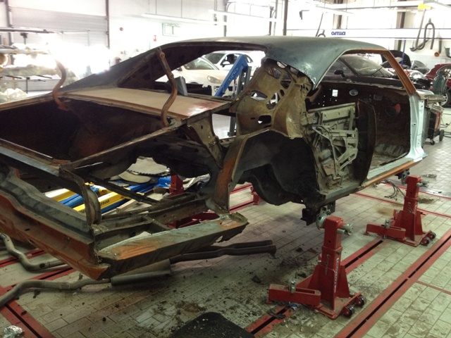

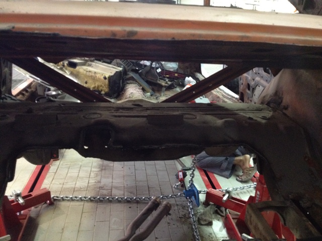

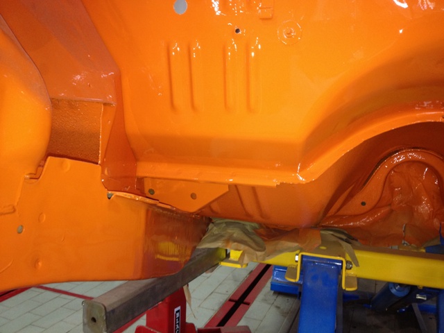

The Jig pulled down the rear frame where it had gone up into the floor about 1.5"
Used a pump to lift the chain and hey presto! she came down
Pulling down the floor.jpg (116.64 KiB) Viewed 4176 times
This had been badly repaired before after a smack
Charger rear gone.jpg (141.95 KiB) Viewed 4176 times
Engine Bay.jpg (110.48 KiB) Viewed 4176 times
Engine Bay stripped.jpg (114.46 KiB) Viewed 4176 times

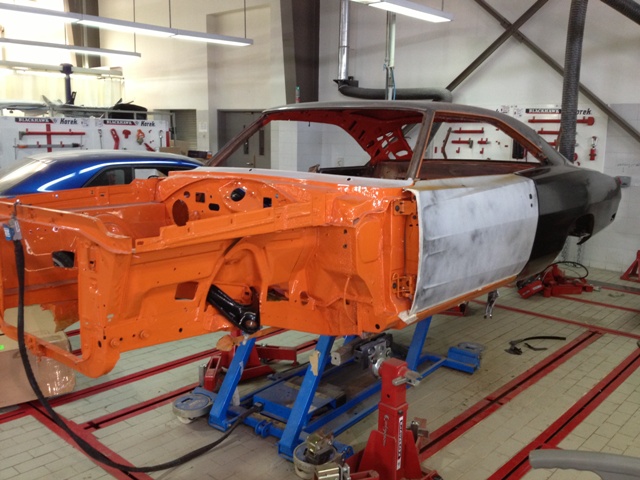

Well I have been doing a lot of work on her, shes coming on a real treat now.
Mock up.jpg (124.29 KiB) Viewed 4059 times
Lining up the quarter and door.jpg (132.65 KiB) Viewed 4059 times

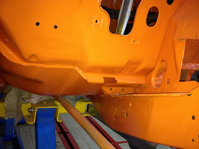

Firewall and frame.jpg (91.44 KiB) Viewed 4059 times
Firewall and frame 2.jpg (94.18 KiB) Viewed 4059 times

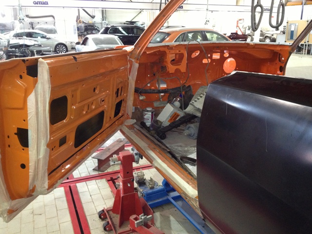

Its getting there slowly!
Door Fitted.jpg (135.43 KiB) Viewed 4056 times

It's amazing what you can achieve with a chain and a lot of brute force!!!!

Needed the chain and the ram pump to pull it straight it was pushed in quite a way.
Yes the whole body shop is AC, it gets into the 40-50's in the summer.
This is a nice time of the year it fluctuates between 18-25 now.
That floor jig thing was shipped in from the UK, its seen plenty of repairs, amazing how it works out where to pull down etc.
