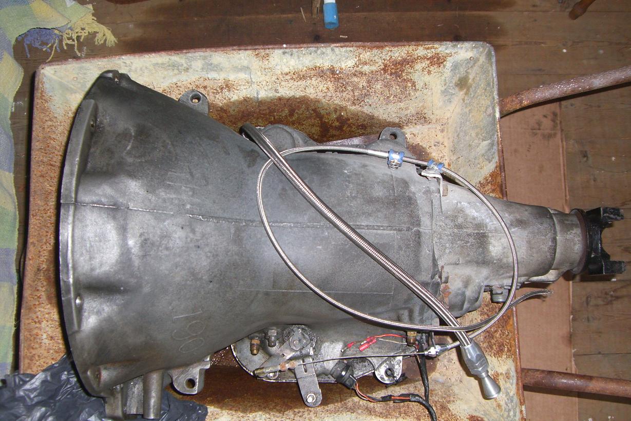

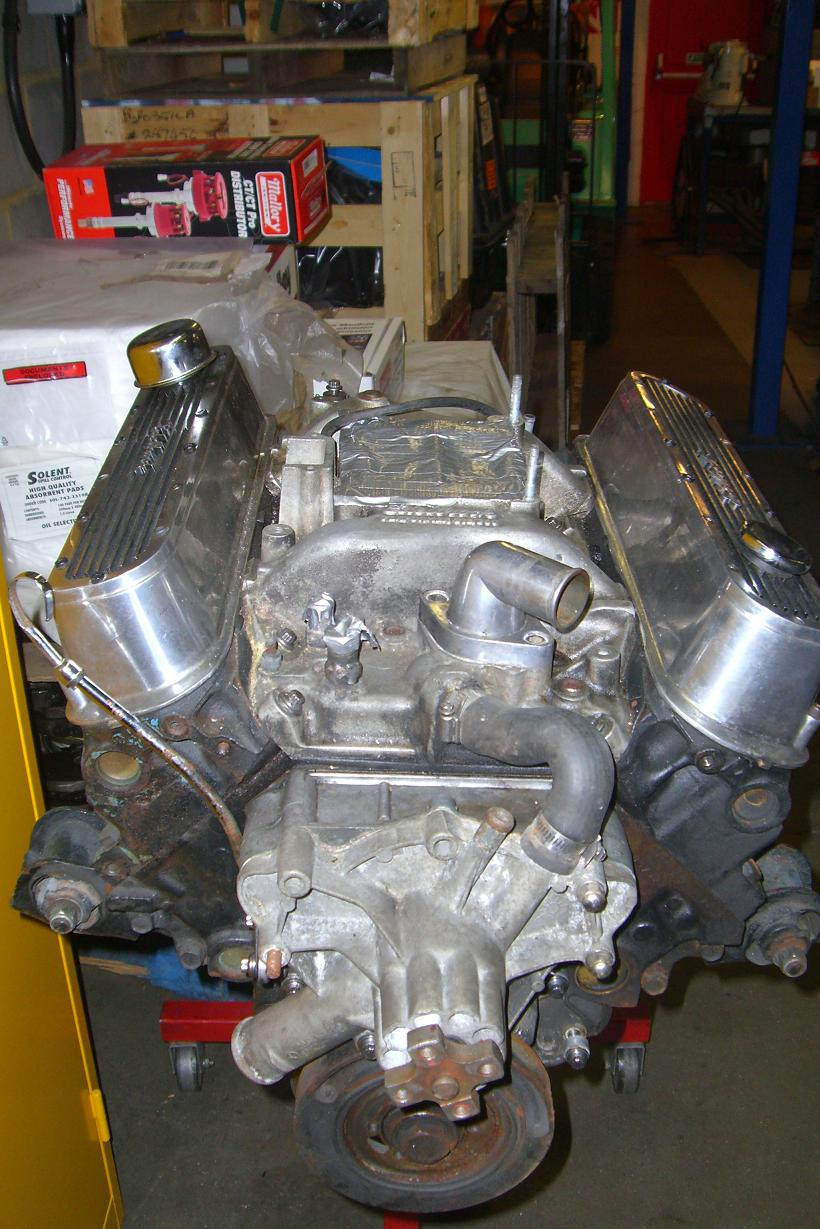

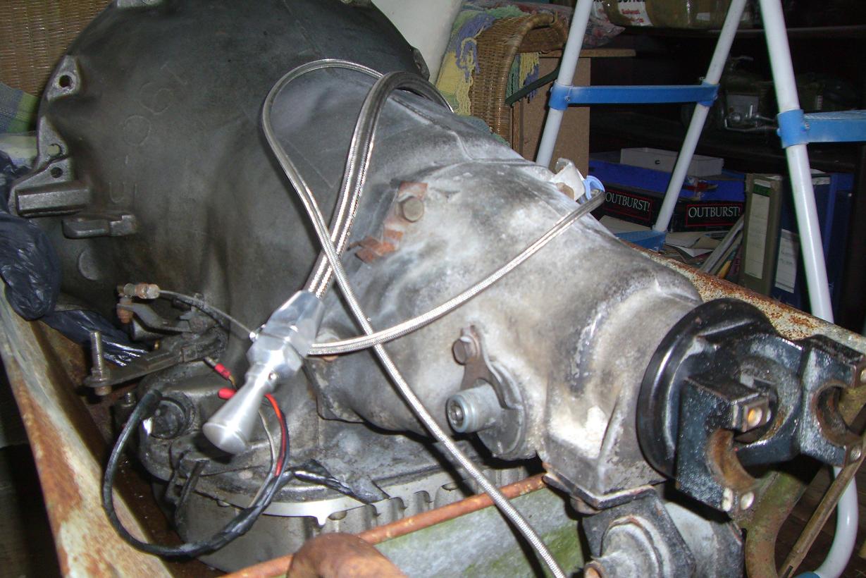

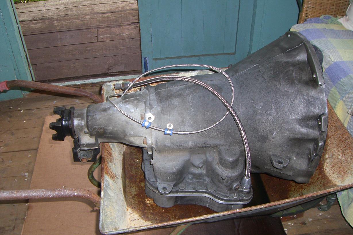

Continuing to make (slow) progress. Body is coming on well with most of the main work done.
eBay has provided us with a solid 360 engine that is now going to be refreshed back to rude health. It came attached to a 727 transmission which we were hoping to use but the output end of the box is obviously different (truck?). It had previously been in some sort of rod, but details are vague...
Not knowing much about 727s, I am hoping this box going to be usable in the Charger, assuming we can change the output end ? Any thoughts appreciated.

yes out put shaft can be swapped but is the first part in case last out so full teardown i can sort and have the bits you need if required,

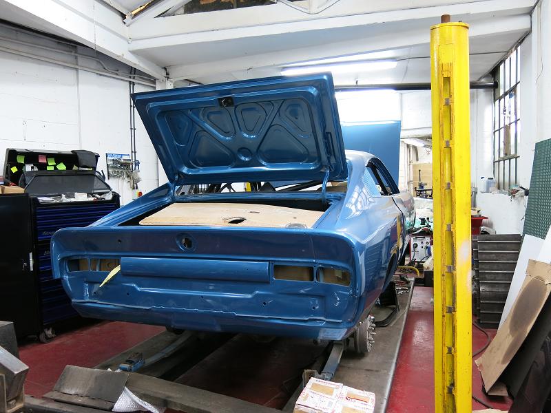

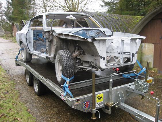

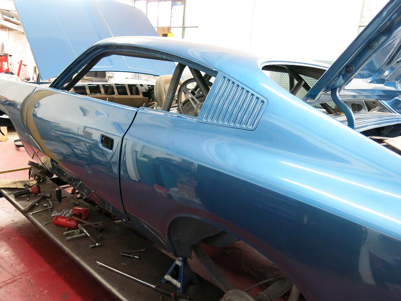

No updates for a while - we've been making gradual progress on the Charger though. Now have the 360 motor finished and that will be mated with the 518 box I got from Duncan - might need some advice there Duncan please...
Gone with a blue that is close to the original we found under the poor black respray; it is actually the Daytona Cobra blue. Roll cage fitted and now we have to get the drivetrain and suspension sorted - plenty of boxes of bits from Aus sitting around. New loom, clocks etc as well. Going to run on 15" wheels, possibly Torque Thrust is the current thought. Plenty of snagging still to go...
Getting there...
Getting there...
IMG_1713 1.jpg (100.22 KiB) Viewed 2177 times
Looking good in blue
IMG_1712 1.jpg (82.09 KiB) Viewed 2177 times
Off to be caged
Off to be caged
IMG_7165 1.jpg (75.54 KiB) Viewed 2177 times

bratfink
Post by bratfink »
Looks fantastic! Great to see another brought back.
Posts: 9571
looks fantastic mate
Posts: 13002
Oooh yes! Well done sir, what a cracking colour! :thumbright:
Posts: 9571
most boxes from a car would have a slip yolk
without one you will have a bit of trouble i'd guess becasue the distance from box to pinion on the axle changes as you compress the suspension
a 727 will fit a charger. it was part of the aussie police pack, K options, however i have no idea if there are A body and B body rear mount positions and you may need the cross member from an A body equipped with a 727 to get it in
it will also need a different length tail shaft the 904/4 speed manual one would be too long i expect
it should however not be an insurmountable issue aussies been doing it for years with small bock 727
the tunnel on your charger will have been split and widened with a big mallet on the production line to disguise the fact that the floor pan is an early 60s pressing and they needed it to match a bulkhead with the later sized tunnel hole.
and of course the slightly smaller 904 was standard fitment on anything with 8 cylinders in a charger same or similar sized smallblock bell housing.
six cylinders got a toughend up Borgwarner 35
the auto 4 speed/5 speed later boxes with box number begining 5 are a bit more of a fiddle and might involve cutting out the hump* in the chassis above the bolt in cross member
*replace it with something else
use a US starter with a US box and US torque converter otheriwse teeth mis match might occur
