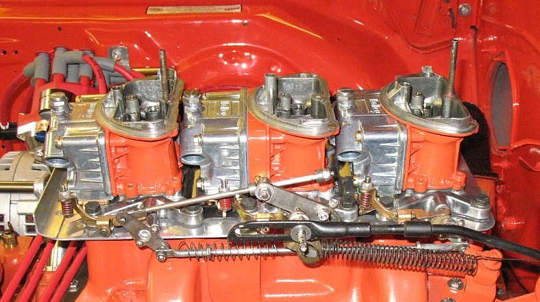

Steve wrote:Gotcha Pete, wonder how many, if any, other setups like this!! I could quite easily put that on a block of wood and have it as an ornament in my house!! Is fantastic....could you imagine going into a dealership and ordering the stock version of these babies on a new car??!!! :shock:
Well there are quite a few stock six pack inductions in the UK. Fair few on Jensen Interceptors too. Some have been crudely modified for mechanical operation.
The one Pete has there on that car is the only "Six Packs to Go" conversion I have seen since my own. Certainly when I had mine converted it was the only one in the UK done like that.
On mine I went further and removed the vacuum cans and fitted a secondary return spring. I painted mine to look a bit more flash too. ;)

Dave.... Thats pure porn mate!! =P~ =P~ =P~
And then there's the crazyarse Weiand super stock Six pack cross ram as fitted to Jem's Belvedere. I too had to fit an aftermarket metering block and an 8.5 power valve to get it rich enough at idle. I also had to make adjusters for the outboard carbs to hold them slightly open at idle. All in all a right pain in the arse to set up, and you better have an AFR meter or you'll get totally lost. Once done though, it pulls like a train.
I should add that Vince Donnald did the original installation so I can't really take any credit.
I also have a complete 6 pack set up sitting in the garage in case if feel the need for an original 6 pak "lag" ;)

Lost for words on this other than =P~ Pete

how come you used a b manifold pete,noticed spacer plates ,are the r\b manifolds hard too find
Terry, it is an RB manifold. Those are Stage 6 heads which are raised port, they use specific manifolds which are wider than an RB intake when using a 440 block. Spacers are the only way to get this particular combination of parts to bolt together, there is no other 6 pack intake that would bolt right up. Stage 6 Heads on a 400 block is considerably easier, any RB intake will bolt straight in.
Blue is spot on.
It has the original Aluminium Edelbrock manifold on it as opposed to the Chrysler cast iron boat anchor manifold..........

now i understand,i thought cheapskate :D
