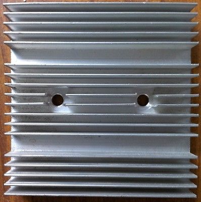

Found this on ebay...ordered one for a fiver and I will adapt it for use as a heat sink...
Ive also got a brand new Mopar electronic ignition harness that I can use to get the proper rubber dizzy connector and fresh wires for the rest of the upgrade.
Itching to get started now, just waiting for the bits to arrive
heat sink.JPG (30.88 KiB) Viewed 421 times

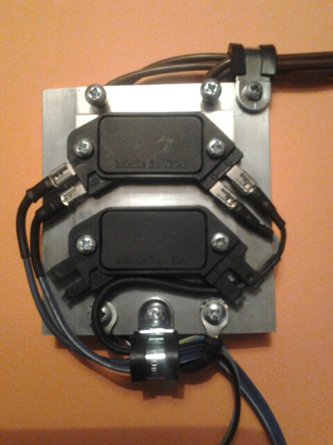

Just waiting for my coil now and will be ready to fit.....Ive mounted my spare HEI unit onto the heatsink so if I have any issues I can just swap them over. Made up some terminal protectors just by pushing some heatshrink on then heating the very end just to crimp it shut to protect from any dampness.

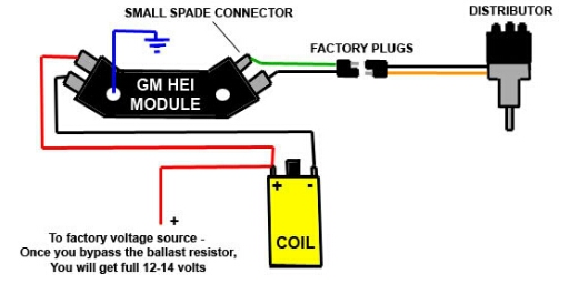

Can anyone tell me for definate, if the black wire from the dizzy is the positive and the red is negative please?? Looking at all the diagrams etc, they point towards the black being positive but the only way that is indicated is by the configuration of the black rubber plug on the ends of the wires. The fully shrouded pin at the plug (female with black wire from dist) joins the male side of the new loom which in turn runs to the small + pick up coil terminal on the HEI. As I have put the connectors on myself...this could be wrong. If the red wire from the dizzy is positive, then I would have to swap the connectors onto the opposite wires. I think its right but dont want to leave it to chance.
Added a pic of what Ive done so far. If it all works I may make up a plain black cover just to tidy it all up
cheers
HEI unit.jpg (203.35 KiB) Viewed 408 times

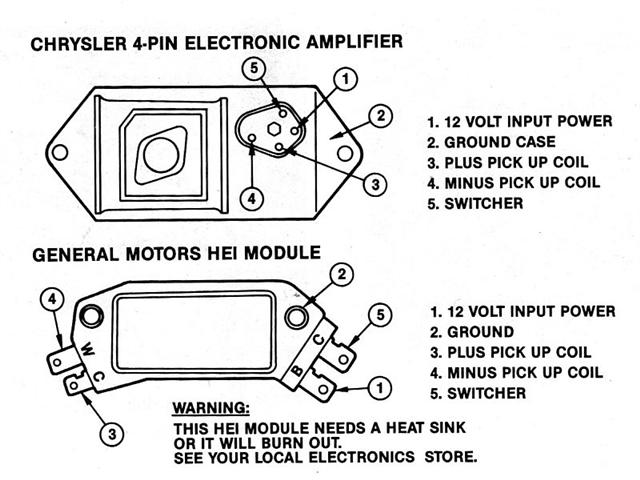

Here is the diagram I am using to work out which dizzy wire is positive...
HEI wiring.jpg (52.18 KiB) Viewed 405 times
Posts: 7465
And then using this diagram to work out the HEI box end....

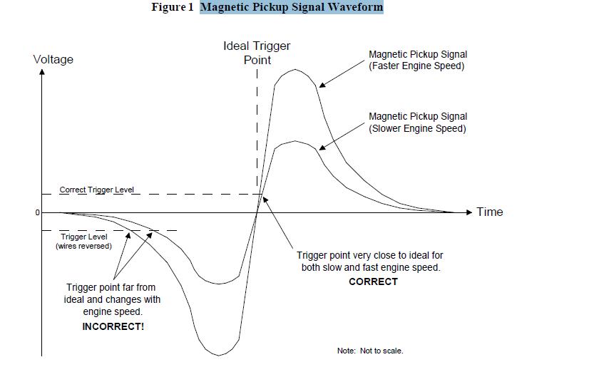

connect up ya dizzy
start the car
if it won't start
or is really flat performance wize
swap the dizzy wires over
if its better thats the correct way
you will have to adjust timing but if you have them the wrong way round you will need to turn the dizzy about 1/3 of a turn to get it to run correctly.
even when you think its right
take it up to 3000+ rpm under load
misfires and its wrong
or rev it to 3000 with timing light on it
rev from 3000 to 4000 rpm the timing should stay at the same place
if it changes then you have it round the wrong way
the graph explains
follow the line from the left axis to the point on the wave form for correct
see at high strength wave form and low strength wave form relating to engine speed the cross over point is the same for correct way round
follow the line for wrong way
as the wave for gets bigger due to faster engine speed the cross over to trigger the module changes dramatically
hence timing change when rpm increases that is not caused by Dizzy advance (which is why you test at 3000 rpm after the mechanical adavnce is all in..) vaccum disconnected for testing

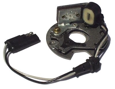

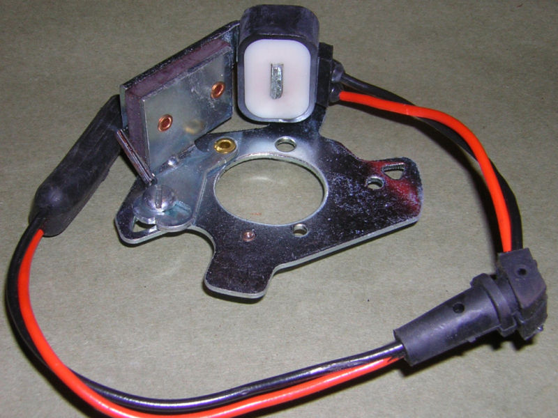

there are so many diffeent colours to the dizzy wires
mopar black and yellow
aussie mopar different white with coloured trace on wires
MSD green and purple
eeeeeeaargh
if you get the wires backwards
a backward trigger.JPG (39.21 KiB) Viewed 380 times
pickup bosch hemi 6.jpg (18.99 KiB) Viewed 380 times
If you get the dizzy wires the wrong way around the ignition timing will seem to be much further advanced.
I made this mistake on my Challenger (the wire colours were the wrong way around on my MSD dizzy) and the car still ran OK and got me to the Nats but on the drag strip it was running a full second slower and stumbling when under max load at WOT on slicks.
This is because the spark is getting triggered as the rotor approaches the dizzy cap terminal and before the coil is fully charged up.
So which ever way around makes the timing more RETARDED is the RIGHT way.

I will work through this very carefully just to be sure....luckily, I am using a new mopar performance electronic ign loom to wire the box and coil etc up. I am using the black rubber connector from this loom and the blue wires coming from it to wire in the + and - pick up into the HEI. Its a one way only fit so Im reasonably happy that if I use the + wire that would have gone to the orange box + then it should be ok. That wire worked on the orange box so it should work on the HEI as the MP 5 pin cap only fits one way and + can only be + on that set up. Think it would be harder to work out if
