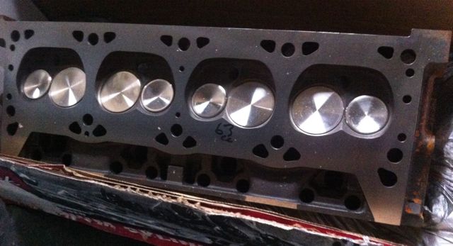

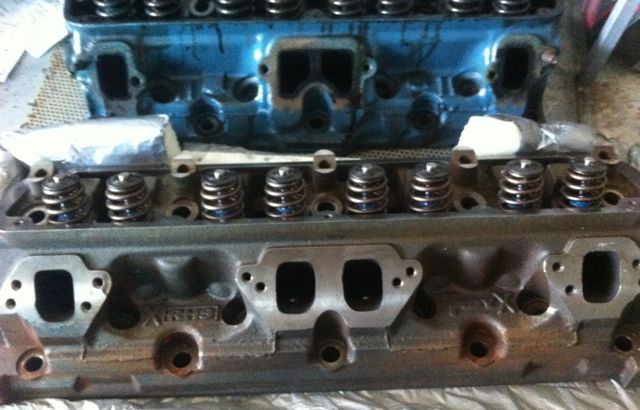

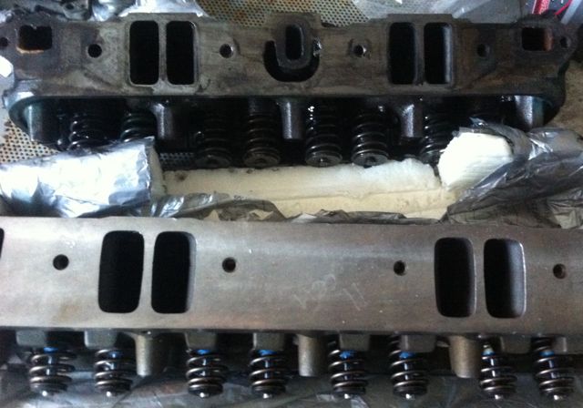

Some pics which show the valves and also port comparison. Difficult to see in bad light but the new exhaust ports are bigger than stock J and flow much higher. The inlet ports are also bigger. J heads are just shy of 1" wide, but the new LA X head measure 1 1/8".
More to follow when current man flu respites :cry:
