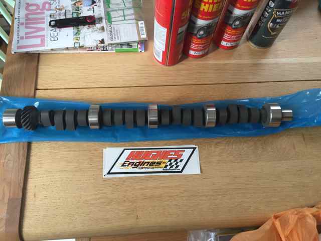

new cam ready to be fitted when the engine is out
new camshaft
new camshaft
Posts: 7309
Location: Cornwall
Post by MilesnMiles »
That's a full on attack! What's the cam spec on the Hughes item. Be interested to see how it performs. Any new converter in that pack of goodies?
rossk
Posts: 199
Joined: Wed Aug 31, 16 1:27 pm
Location: Watford
Post by rossk »
Hi, this from the website
Whiplash Flat tappet hydraulic small block "LA" camshaft.
WARNING: Our Whiplash cam is designed for low, basically stock compression engines. This cam will run on pump gas in a 318 with 8.4:1 or less compression and iron heads. If your compression is higher than this you may need to use a higher octane race fuel. Your vacuum should be in the 9"-11" range using this cam.
(Figures calculated using stock stroke & compression at 750' altitude.)
Basic guidelines (These are not absolutes, just guidelines to help you get close on a cam choice)
Use: Street and some strip
Idle: Like it wants to bite your head off! Very aggressive
Vacuum: Low
Converter: Stock or a mild stall
Rear gear: Stock or up to 3.55
Benefits: Tons of low end torque and a super aggressive idle that scares Mustangs, Camaros and rice burners from even thinking about messing with you

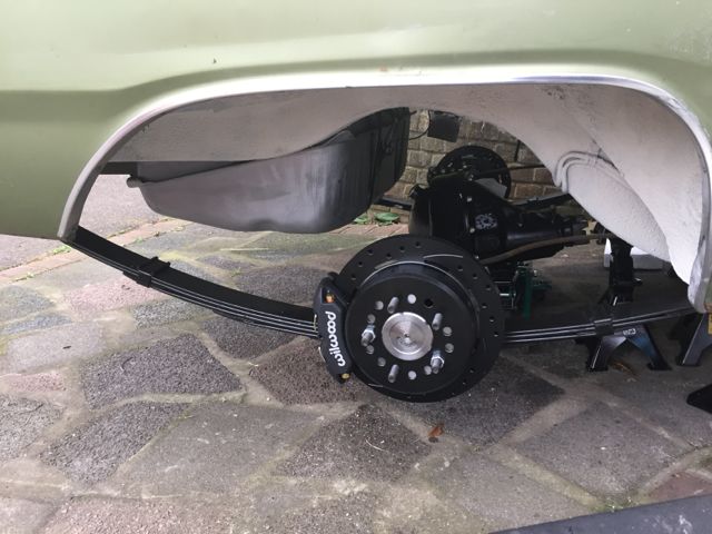

So I finally managed to get the axle in today, very heavy and loads of swearing involved!
Having a bit of trouble with the shocks as the angle seems to be off where they connect to the leaf spring shackles, may have to drop the springs at the back tomorrow and lower the whole axle down, hopefully that will line them up enough to pop them on.
Anyway, really happy with how it all looks, now for the fun of measuring wheels!

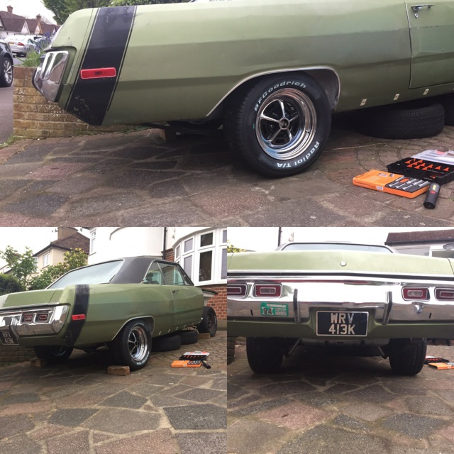

wheels now on
octanejunkie
Posts: 399
Location: Somerset
Post by octanejunkie »
Good choice of rims 8-)
When you get the engine sorted could you please take a video........Cam looks interesting and would love to hear it!!!! :thumbright:

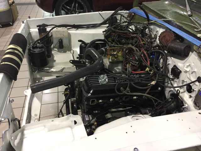

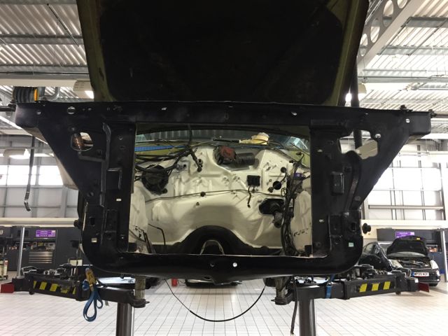

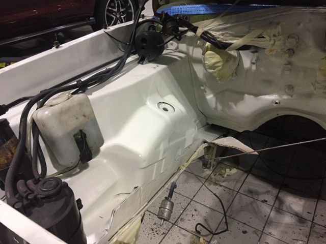

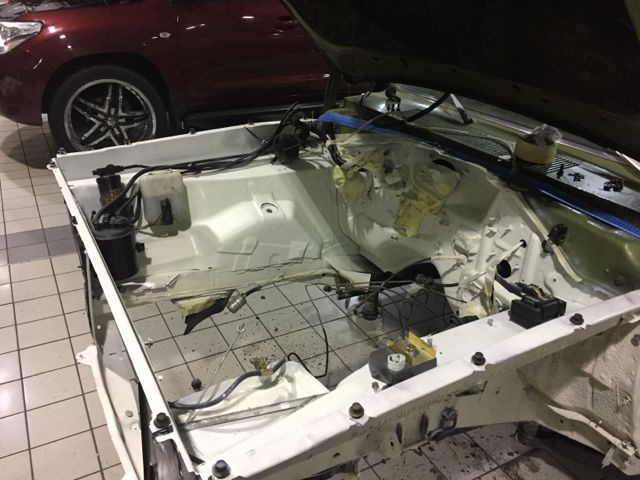

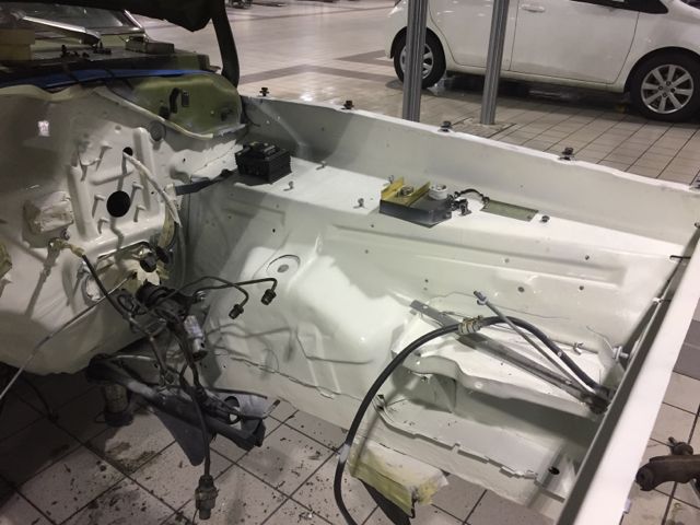

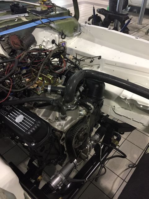

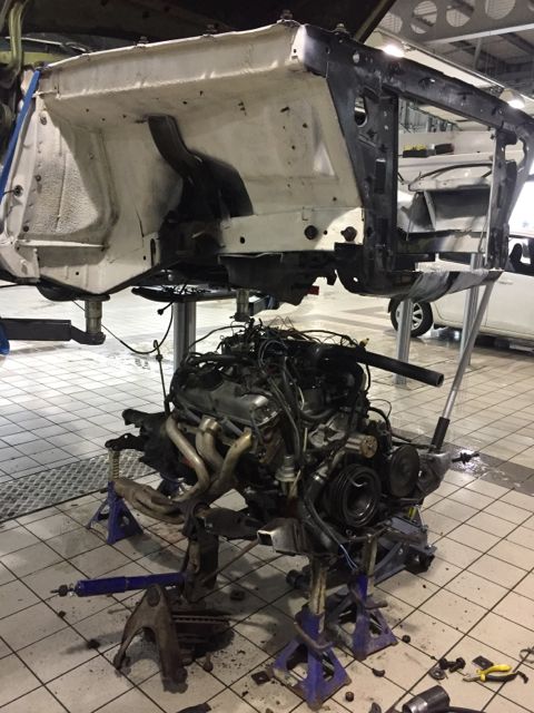

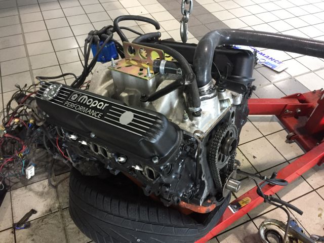

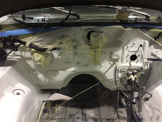

So been busy this weekend, luckily every now and then I get to exploit the perks of being the service manager and get to bring the car into the workshop and make use of the lovely facilities!
Engine out, bay painted, new camshaft fitted, engine painted, new RMS alterkation kit being fitted, Willwood brakes to do and a few things to finish off but getting very close to getting her back on the road!
Can't believe how well the tunnel cleaned up, almost didn't want to paint it because the paint was so good
more painting
more painting
fresh paint
fresh paint
engine out
engine out

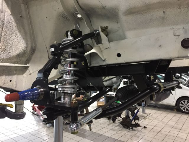

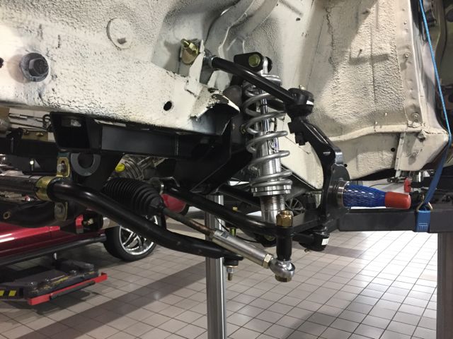

more pictures
brilliant kit, loads of money but went together so easily
more paint
more paint
rossk
Posts: 199
Location: Watford
Post by rossk »
more pictures
Posts: 22138
Yes, those Alterkations are really top of the line 8-)
rossk
Posts: 199
Location: Watford
Post by rossk »
Pete, when we started to put it together I could just see the quality, the welds are perfect, everything fitted together as it should was really impressed with it. It was a massive investment one that i deliberated on for a while and years of saving the hard earned money, but as soon as I started to fit it to the car I realised it was a good choice.
