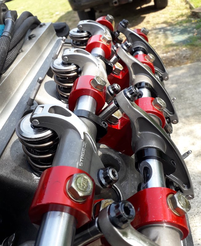

Push Rods were perfect. Top end was spotless, no nasty surprises..
Rob pulled the System 1 apart after the Dyno and pronounced it spotless....

Non-Blue Push Rods (now 7/16" Diameter, not 3/8")
- New Pushrods post Dyno run.jpg (125.01 KiB) Viewed 1803 times

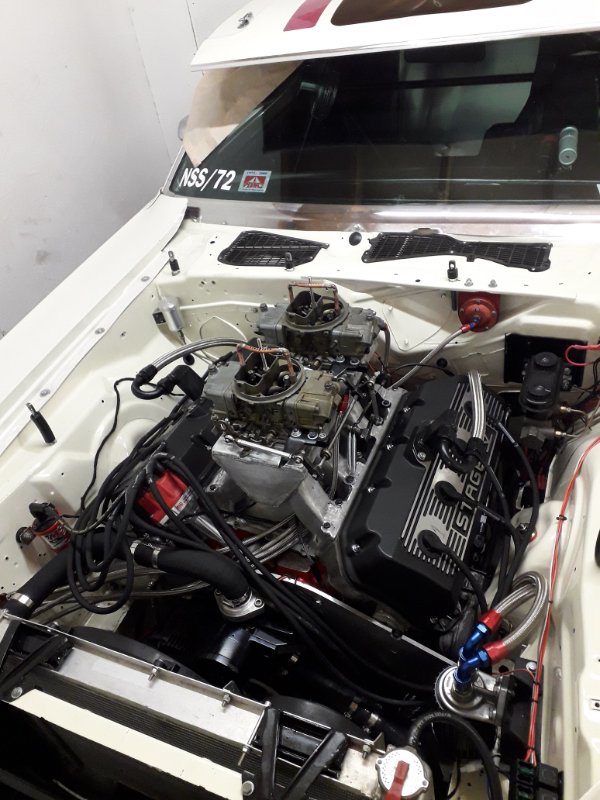

Well, after a full engine re-fresh, transmission re-fresh, Torque Convertor repair, new Billet Starter Motor, revised front suspension and about 300 other things, the car is back together!!!
Sincere thanks to Blue for performing the Transmission upgrade and rebuild, and also for helping me with the Installation.
Everything has been measured to death and all is within limits, so I grew a pair and hit the "Start" button...
Fired up at the fist attempt and it has 3 forward gears and 1 reverse gear, which is nice.
It might have scared the chickens next door a bit though....
- Hemi back in!.jpg (118.29 KiB) Viewed 1699 times

Sorry, Dom - I did not record it, I was too busy looking at all the gauges, taking instruction from Blue whilst checking the transmission operation, and pooing my pants in general... like Child birth but worse....
