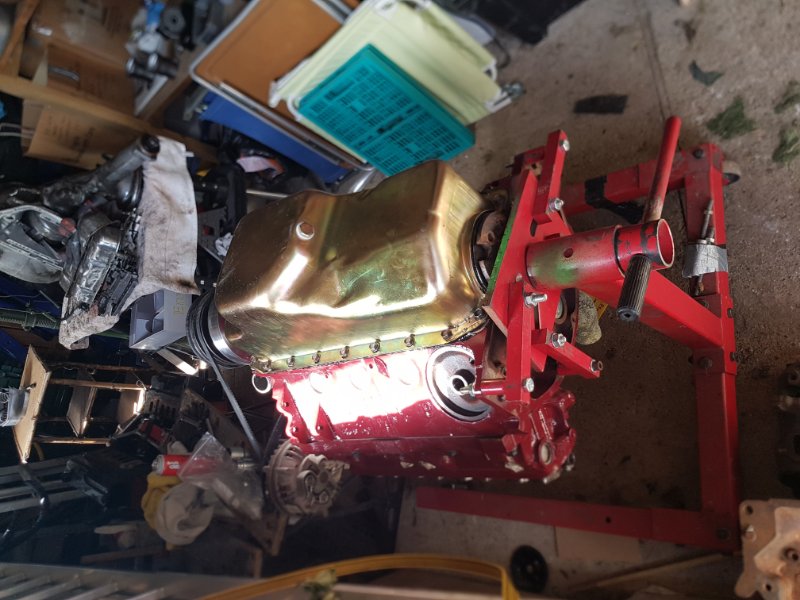

Back to the Plymouth! Lockdown project has been the resto of my Portafold, so now that's done, back to the LA!
Sump on, 727 refreshed and aiming to drop them in as one piece by the end of the week (as it's nice and sunny!)

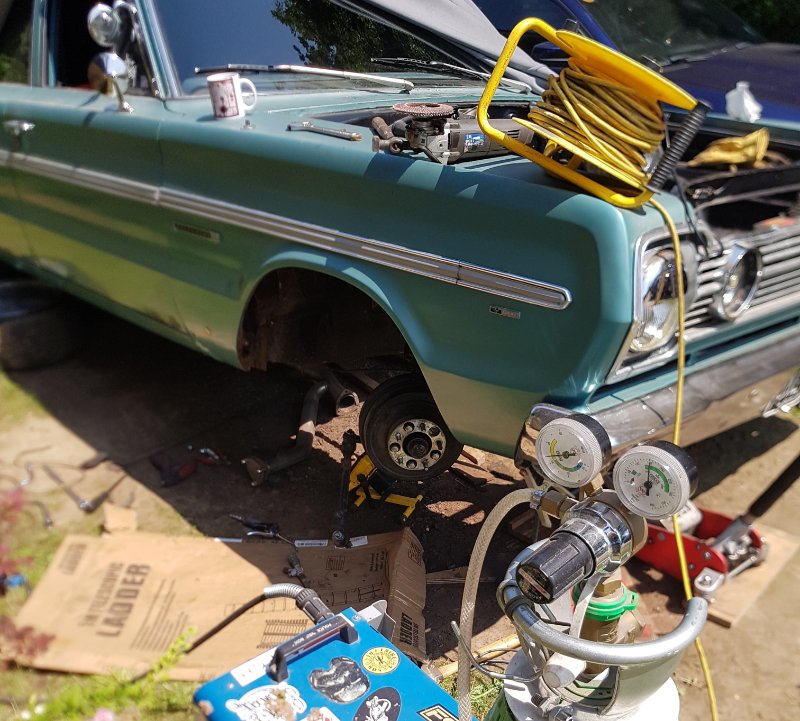

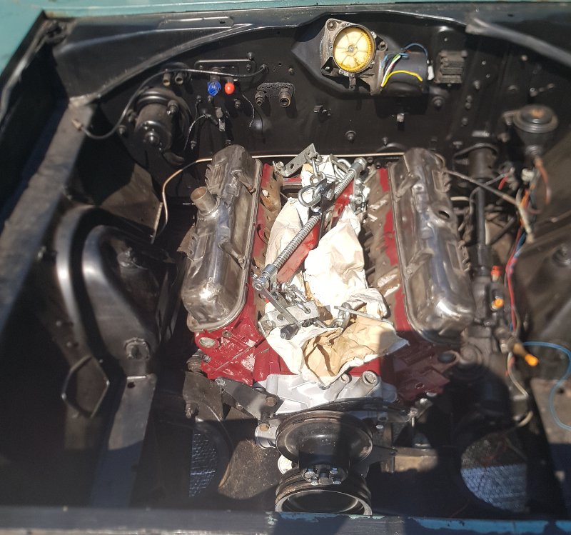

Sorting out a couple of holes in the chassis leg way laid plans for the engine today
I reckon this wagon had lots of fun at the beach in its time considering how much sand came out of the chassis leg! It just seemed to keep coming!
Back to the engine tomorrow I hope

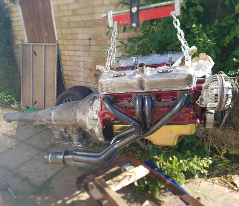

And thanks to Duncan Watts who got some new trans seals in the post within an hour of talking to him!
- deppmobile
- Posts: 137
- Joined: Mon Oct 03, 16 4:00 pm
Re: And so it begins! 318 Poly to 360 LA Swap

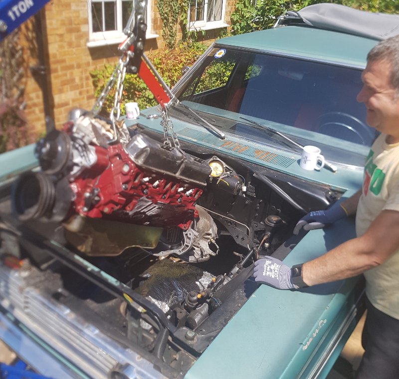

And in! First time I've tried box and engine in one - surprisingly straight forward
Cripes it was hot.....
