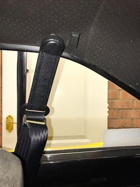

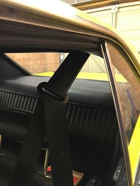

Re: Shoulder belts
i put these in my Dart a while ago. They bolted straight in and the drop link positions the belt well on me ,I'm 6ft 4in Unfortunately they seem to out of stock at the moment. Good quality product.
https://xvengineering.com/products/xv-r ... eats-black
- 82226676_567379147252075_9063389319737114624_n.jpg (18.26 KiB) Viewed 4549 times
- 101829798_594101154548368_5835741265311825920_n.jpg (18.43 KiB) Viewed 4549 times
- 101058609_246383243126315_1663107003112751104_n.jpg (20.72 KiB) Viewed 4549 times
Re: Shoulder belts
Oh now thats interesting.
I’ve been pricing up the bits - can i ask how much the kit was ? The website doesnt say.
Re: Shoulder belts
Sorry I can't remember how much I paid as it was a while back however the website quotes $71.95 each belt. You can see the price if you click the "products" link on the page I sent and scroll down. Perhaps worth a quick E mail to see if they are coming back into stock soon.morgan wrote: Mon Jun 01, 20 7:39 am Oh now thats interesting.
Re: Shoulder belts
Will do. Thats reasonable. The Aussie drop links are £50ish by the time posted and similar for the generic belts. If its $72 all in thats very good IMO.
Thanks.
Thanks.

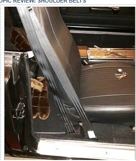

Re: Shoulder belts
Hold on. Just to waken this up again... my brains not quite firing
Shoulder mounts and drop links; thats fine. Got the holes and mounting point.
But the bit on the sill where the retractable bit goes - my current setup only has one mount point. (for the lap belt). This setup will need 2 wont it ? One for the retractable and one for the other end.
So how did Dave(R) do this ? Did he drill the sill and add a new mount point ?
From Daves pic - this is the bit I mean - 2 mounts -
- belt_mounts.jpg (22.02 KiB) Viewed 4366 times
Re: Shoulder belts
1 hole
long bolt
sill, small spacer/swivel, flying end of belt, washer or flat spacer, reel, lock washer, bolt head. all good
ideally the flying end swivels and the reel must not, but no big deal. set the best angle of both parts and do up tight
you can sleeve the first 6 inches of the flying end in battery heat shrink wrap, get the right width but don't shrink it on the belt ,just on the flying end mount to keep it in place .warm the mount with hair dryer. suggest black would be best
but you may have 2 holes just no hole in carpet
i ran about like this for ages until my curiosity got the better of me, the aluminium inner sill trim on my car had 2 cut outs, one an obvious half moon for the hole i was using and a second a small crescent that just looked like shoddy workmanship turns out that was another hole under there in the sill, it needed a good clean out with a tap due to never having been used.

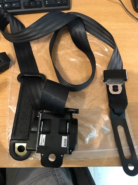

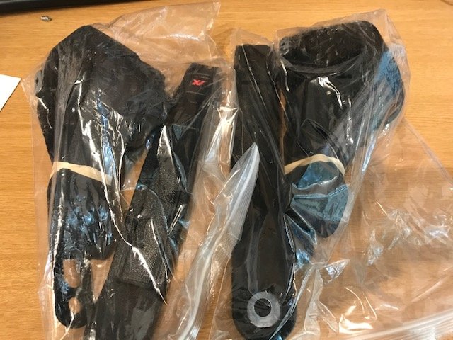

Re: Shoulder belts
Ooh ! Look what arrived today ? Dont you love packages from America...? This is the XV racing products B-body 3pt conversion kit.
Waiting to see if the customs charge and 'uninvited handling fee' rocks up now too.
First glance, looks really nice. Proof will be in the fitting I guess.
You can see the droplink in the 2nd pic.

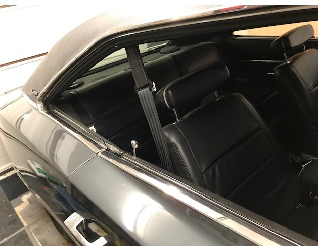

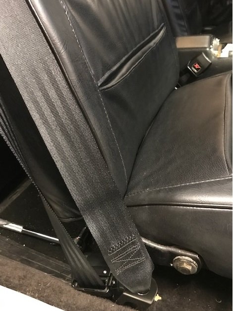

Re: Shoulder belts

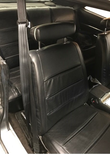

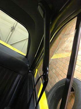

Well, its not bad. Couple of teething issues (had to turn the buckle etc as twisted).
They work fine, MUCH better than the stock hang-from-ceiling. On a Charger they dont clear the plastic trim on the side of the seat so had to remove it. Not a big deal, it goes in the box with the rest of the old belts, but it was the only way to get clearance. Couple of big washers too. Other than that, 30 mins start to finish.
- 3pt1.jpg (51.66 KiB) Viewed 3875 times
- 3pt2.jpg (47.65 KiB) Viewed 3875 times
- 3pt3.jpg (62.29 KiB) Viewed 3875 times
