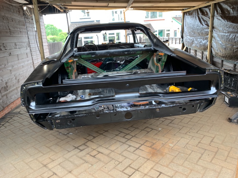

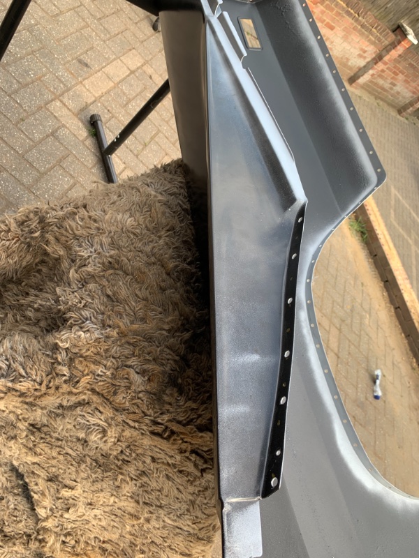

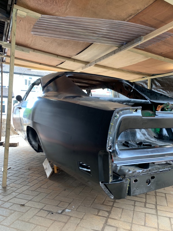

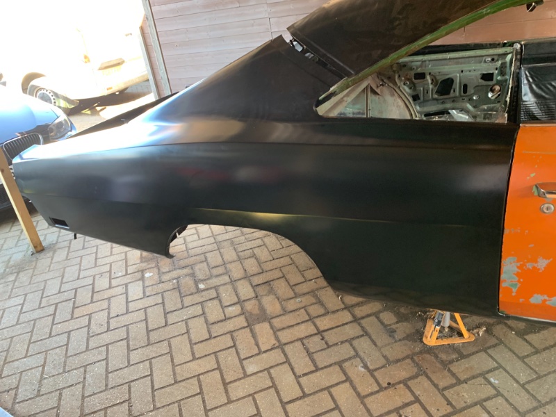

Thank you all so much for your comments. There is always that question in the back of your head when you are doing something new “am I doing this right?” So to hear feedback from people whom have been in the Mopar game for so long is, well, it definitely inspires confidence and fuels me to keep going. So thank you!

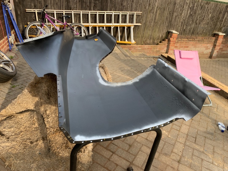

I am inspecting each part coming off to see how it was assembled and trying really hard to weld it back in the same way. I count spot welds and add an extra few just to feel “safe”
So far the AMD parts have been great. I have had to install the wheel wells about half an inch lower than oem in order for them to comfortably meet the quarter, and the side trunk extension needed to be “re worked” a little. Other than that everything is coming together really well.
Most of the time spent is test fitting. Honestly, quarter panels have been on and of so many times I can literally slot them on and off now all on my own, which is great as I don’t have to keep calling the mrs out to help!

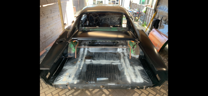

I am at the stage of test fitting everything currently. I have jumped the gun quite a bit on this post, as I’m going to transition this thread using this post in to where I am today, and then continue from here as I will be able to be a little more organised and thorough with these posts.

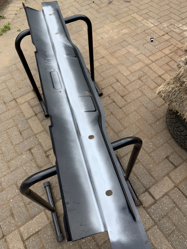

All the old rusty parts are out and gone, the frame rails, wheel wells, rockers are welded in. The car is cleaned of any rust, deagreased, rust protected and over coated with POR-15 and weld primed. I used bedliner in the inside of the quarters by upol, I like the textured finish inside the quarters and I also like that it is a quality product, and that it plays part in deadening sound. It splurged a little but il sort that tomorrow by flattening then going over with a light coat, and make it look pretty! The holes for the passenger side welds are all now made and that quarter should not need to come off again. Il do the right side tomorrow.

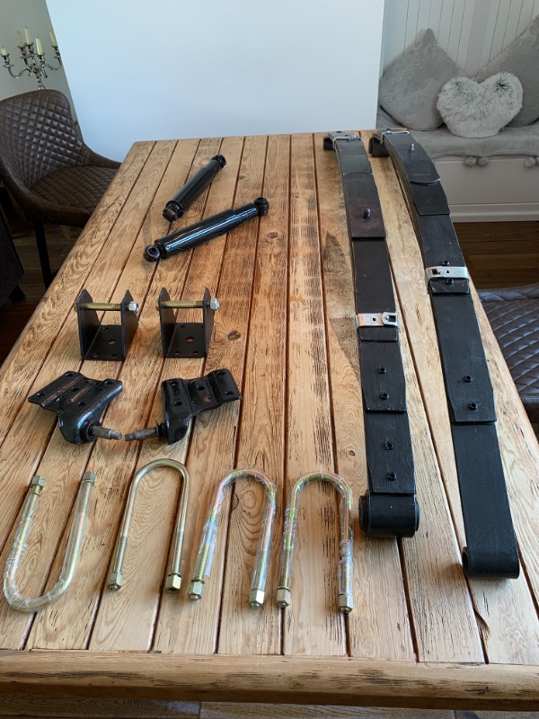

I also had have blasted and prepped my suspension parts. Rebuilt leaf springs ready for re installation. I did not get them tempered, I feel this may be something il live to regret. Il decided what to do with this part of the build after the car is running.
I also need to order a plenum for underneath the deck lid and trunk gutters, I seem to have missed these when I ordered my parts aaaargh!!
All I can say is have huge respect for people who do this for a living. It is honestly a test of ones patience, passion and stamina. Just thinking about it gets tiring sometimes
Hence, Matt H, I make you right. An hour or two a night is the way forward when feeling in inspired. Although the car is currently taking most of my weekends
Enjoy the pics, and thanks for reading! Il add more tomorrow with real good progress!

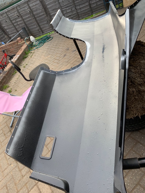

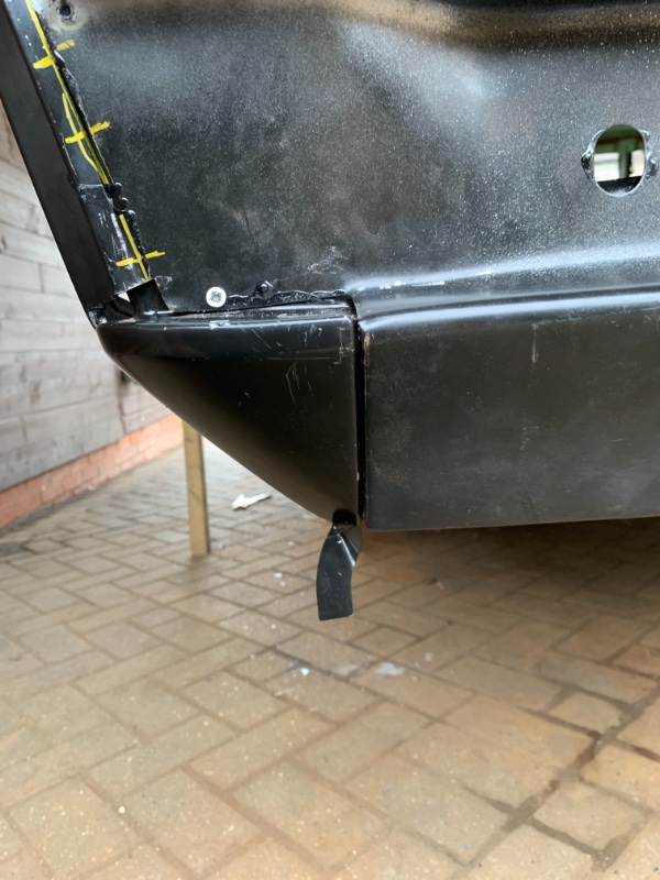

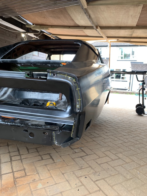

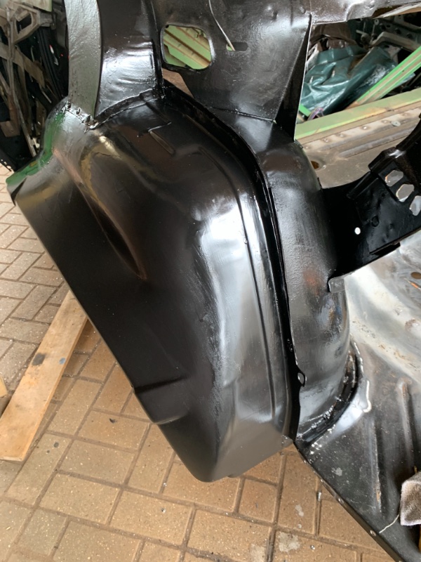

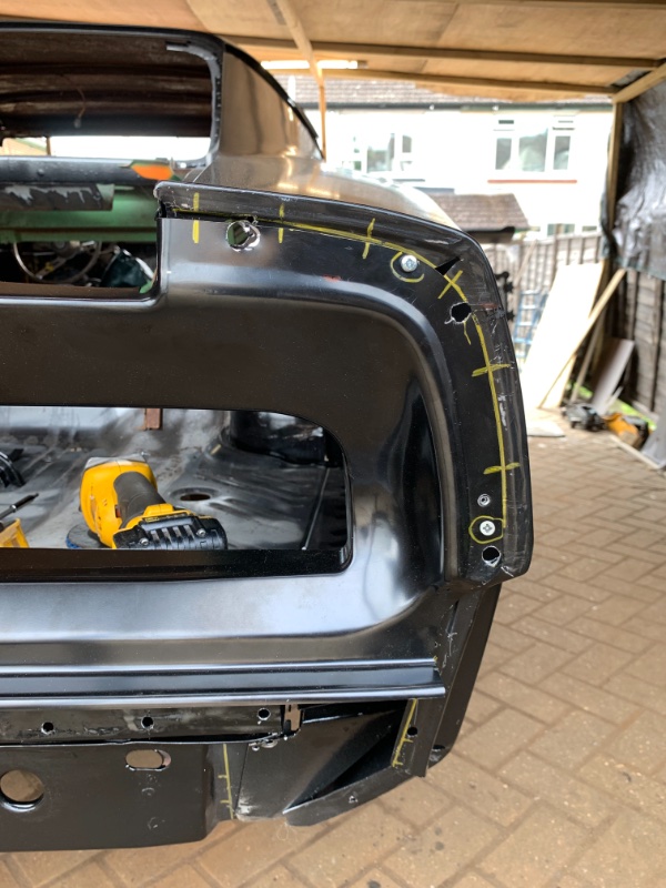

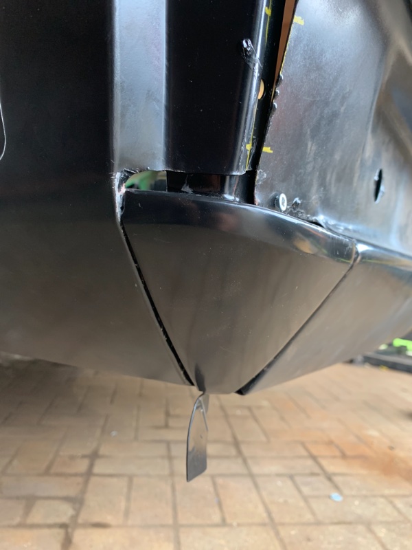

Re: Restoration thread 1969 St Albans charger
Wow, thank you all so much for your wonderful comments! I come here to share my build with interested and like minded people as I’m struggling to get that from family and close friends. I never realised I was also signing up for inspiration and drive because honestly, your comments I making me try just that little harder each day!
From the bottom of my heart thank you so much for the kind words written.

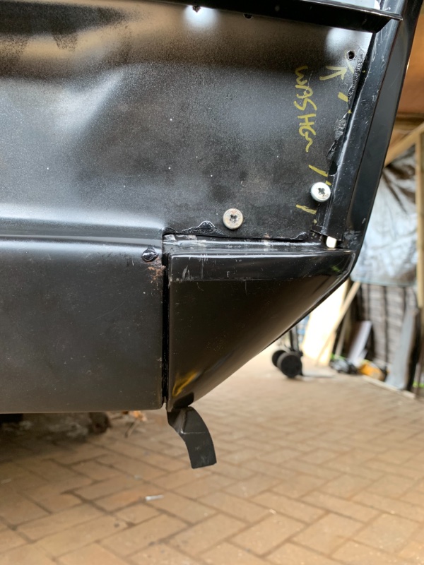

Today was final Adjustments and test fit, ready for welding. I have propelled this thread now to bring up to date. In days that I can’t get to work on the car, il revisit jobs Iv done just to keep this thread going and interesting, as there is so much been done that I have not covered yet.
Next up....
VALENCE CORNERS!!!
And rear arse test fit
from this point I’m hoping to not have to re take any panels off.

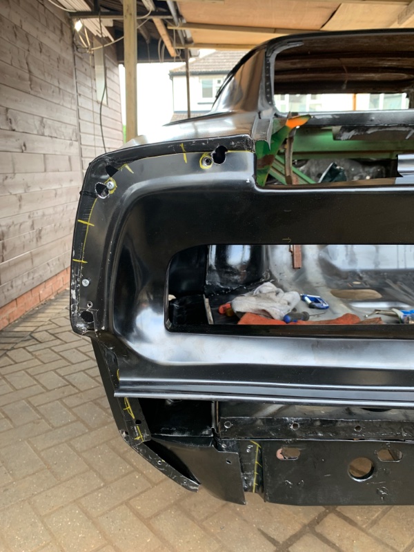

Valence corners.... Huge topic worthy of a thread of their own. Basically, nothing gets finalised until these little guys are sitting happy. I was incredibly nervous about this stage, as if these guys sit wrong, it means Iv been doing it wrong. Besides, dodgy corner valences stick out like a saw thumb, don’t they?
My plan is to weld back from this point after welding these in correctly fitted only to the quarter or the rear valance. It seems that, if I was to weld and finish them in place then il be restricted to get right the trunk extensions, so by only welding them to either the quarter, or the rear valance, I should still have ability to flex in order to get the rest of the arse of the car lined up.
Today I drilled out weld holes and por~15 the inside of all panels installed. I used u~poll raptor bedliner for the inside of the quarters and painted the inside of the rear valence, trunk extensions, rear light cluster and valence corners with por-15. I also primed all holes for welding using u~polls no 2. I hope I have done enough to have confidence that this car exposable to the elements to atleast some degree! I won’t be driving in the wet, and the car will be kept in a barn but I would like to know that it can withstand some degree of weather abuse if it needs to!
I will be doing a little adjusting to get the bottom of the outer wheel wells to meet the quarter panel n the lip of the arch as it doesn’t seem to want to meet. I know it’s in the rights place as every thing ales is on point so I’m going to assume this is either a build issue with my car, or a pattern part stamping issue.
Also, some of my welds were really not nice to look at today. It was spitting and splattering on a few of the welds. Sometimes I think my welder has a mood of its own. They were strong welds so it’s all good and thank god they will remain under the quarter so that’s that!
Anyhow, enjoy this pics, and thanks for being interested and reading my post
Next up....
VALENCE CORNERS!!!

Pattern panels never do fit each other without some amount of massaging, AMD are as good as it gets but even their stuff needs some degree of work. I can accept that but what really drives me mad is other reproduction parts that don't fit or don't look correct, there's just no excuse for that. I can understand now why high end restorers insist on NOS parts at whatever cost. Biggest issue I've found with welders is the electrical supply, you want a good stout cable that's as short as possible, no doubt you already know that.
