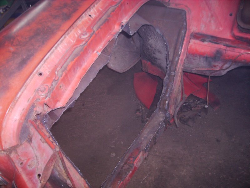

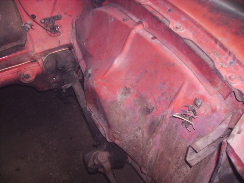

today after checking the inner wing/chassis area we decided to make a bit more room. there was no way the big block would fit between the bulges of the inner wings where the upper wishbones bolted up.
so........ before and after, lol.
neil.

we cut through the column above the steering box as it's set up for front steer and the steering arms have to go rearwards to keep the ackerman angle somewhat correct. we'll use one of the suzuki jeep boxes i have in stock as they work front or rear. the column will get a bush turned up to keep the inner central and a splined end fitted inside it for joining to the upper uj.
once the box and column are out of the way we can 'trim' the drivers side inner wing out too.

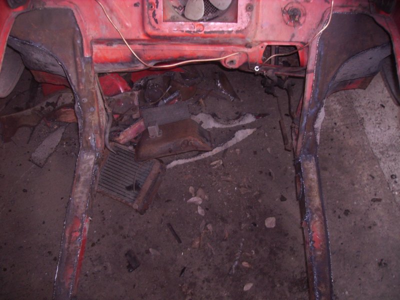

that's the other inner wing/s out of the way and the strut top bit too both sides. also we removed the engine bay side of the heater assembly. it all needs a big grind up now then some welding of edges together for strength. the engine bay's much wider now, we'll need to have a measure up to see if it's long enough next.
neil.
ps you can see the big pile of sheet metal on the floor too.

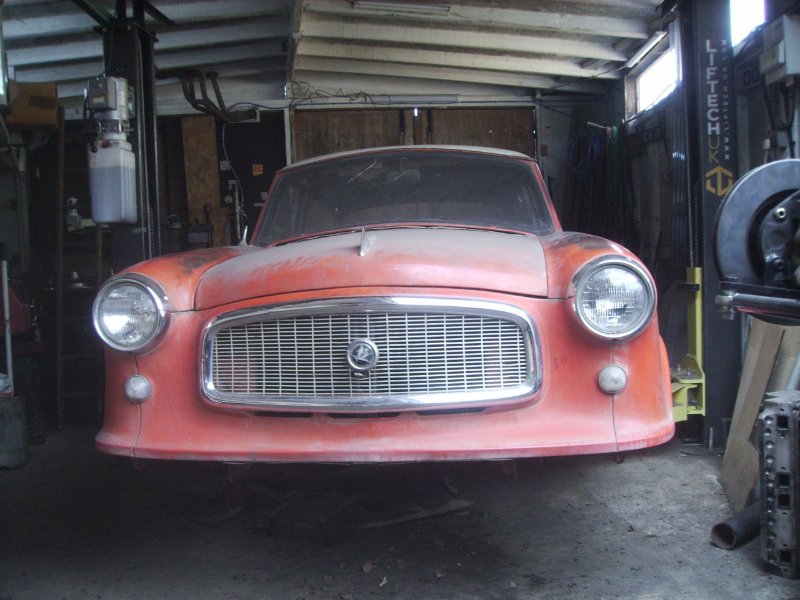

i forgot to add a pic of the car without the front bumper, doh! so here's a before and after comparison and apart from the likeness to a hovercraft i prefer it without. anything other than a gasser/street racer look i'd refit it but.......
neil.

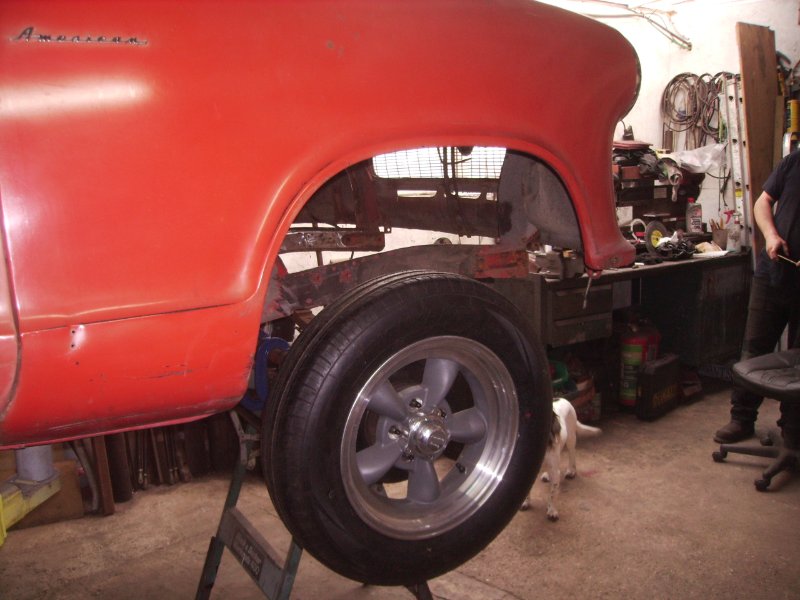

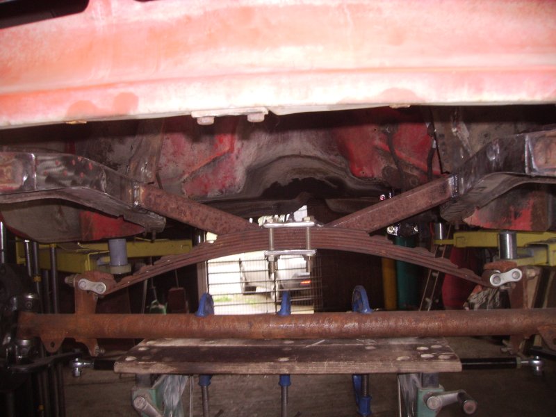

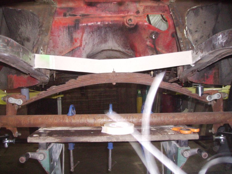

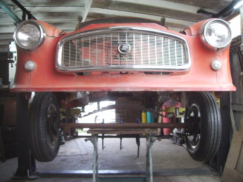

today ash came here and we got a fair bit done. we cleared all the scrap metal under the car and swept up before making more mess by grinding all the cut edges smooth ready for some seam welding. then we clamped the front axle on the workmate and dragged it under the car, measuring, moving, measuring, moving. measuring.......... finally it's where it needs to be so next job is to make a spring crossmember between the chassis rails so we can clamp that in place.
neil.
ps i couldn't resist resting the front wheels in place, lol.

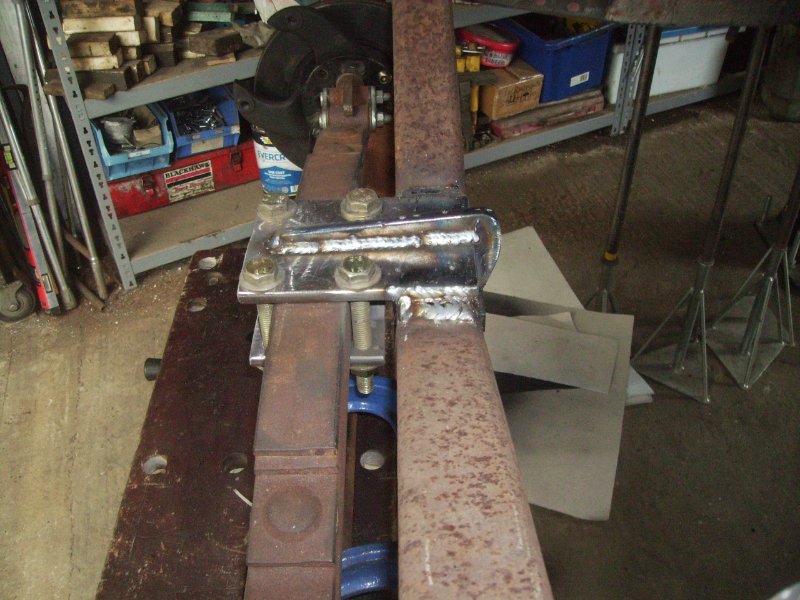

we spent a little while playing with cad today. the first design we felt would be too close to the sump so mk2 is looking favourable.
neil.

today we went ahead with cad number 2 in steel. once welded in place we made top and bottom plates, the top going back over the crossmember. last job was a strengthening 'rib' from behind the crossmember up and forward on the top plate. the bolts are only temporary before anyone says anything 😉.
neil.

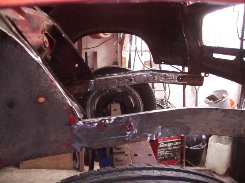

we offered up the hairpins today and as the brackets are set on the axle the hairpins get closer together as they go back under the car. usually not an issue for bracketry but on the nash the 'chassis' rails sweep out from under the bulkhead to form the inner sills then in again to go over the rear axle and on to the back of the car. so above the rod ends there is only floorpan. anyway with the aid of some more cad we've designed a tapered 'box' that welds to the inside of the chassis running out across the floor to above the rod end. it's rear corner butts against an outrigger (should that be inrigger, lol) to further strengthen it. one side's made ready to weld in place once the floor and chassis are cleaned up and the other side's marked on the sheet ready to be cut and folded. the plan is that the gearbox crossmember will bolt to the inner ends of the 2 boxes to complete the strength full width.
neil
