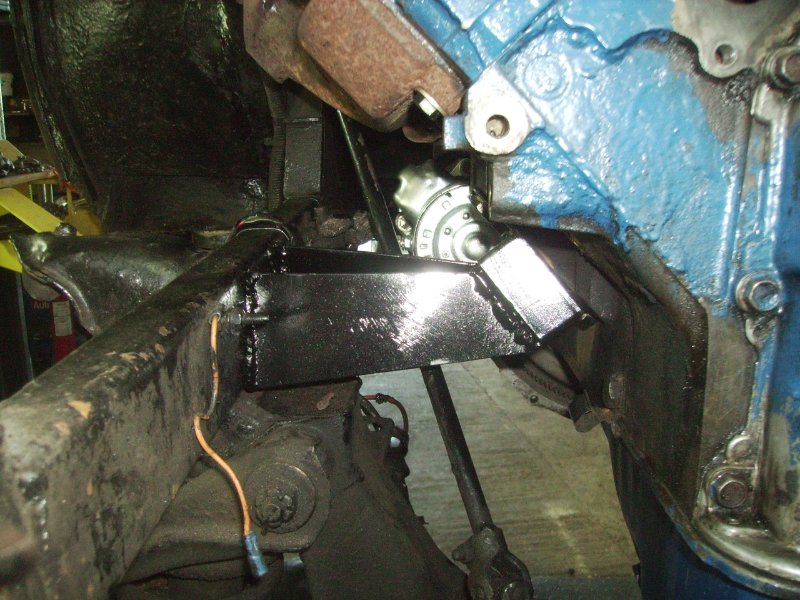

we made the chassis side of the mounts for the engine today. 3/16" plate so nice and sturdy and we even remembered to cut/slot the mount holes for any engine removal later on. we offered up some stock cast exhaust manifolds as we don't think we'll have time to make headers. luckily we have 2 sets and it looks like the 2 centre-ish outlet ones fitted upside down will work just fine. the down pipes needed will be sort of fenderwell-ish so they'll be ok. still can't pics to load, i need someone much younger than me to show me how. problem is the pc did an update recently and pics won't load to the pc now, or if they do they're hidden and i can't find them, lol.

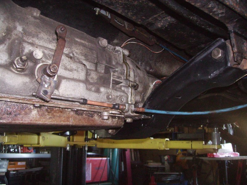

today's job was to sort/make a combi shift lever from the ford bit on the box and the b&m lever from the th350. we've sussed how it'll be cut n shut and welded to make it work but in doing so another problem arose. the box won't engage park internally. so with the pan dropped and nice clean bright red oil everywhere (doh!) we found the park rod hanging down as the end that engages the park pawl has broken off. so i've ordered a gasket kit from rock auto (17th today and delivery date 20th!) as the tail housing needs to come off to retrieve the bit of rod before it destroys the box/casing later in use. so tomorrow the valve body and tail housing will come off to get the rod out and almost certainly we'll weld the broken bit back on. it only presses on the pawl to engage it with the park gear when stationary so no load on it, it'll be fine.

we had a good day today, the park rod is welded and refitted which is good. then we moved back to the shifter bracket at the box end after some more trimming and trimming and trimming of the ford shift lever, each time clamping the b&m lever to it and checking the travel matched the shifter itself. finally we had a match and welded the two parts together, that's that done. now once the gaskets arrive we can refit the tail housing (with a new seal of course) and sump pan followed by the 'new' crossmember.... again.

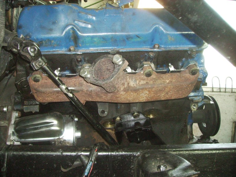

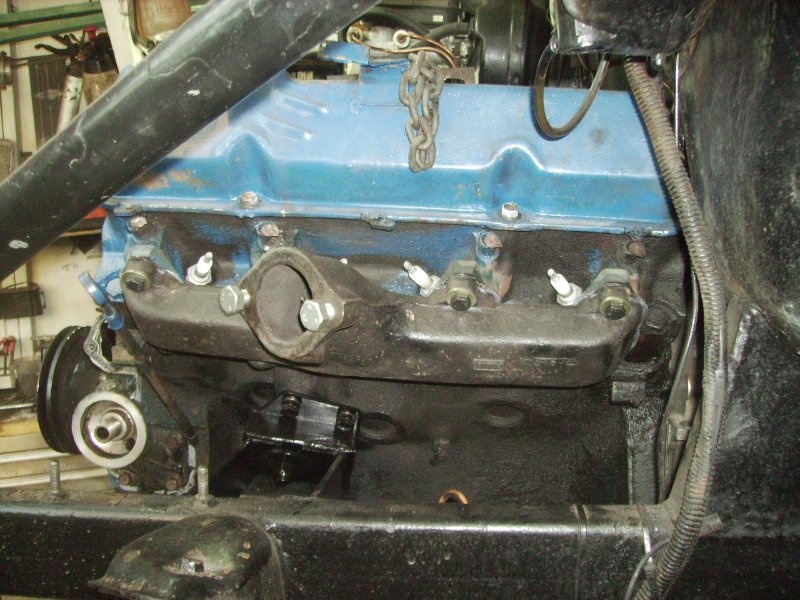

today we cleaned the mating faces of the exhaust manifolds and the heads, removed a snapped bolt from the n/s head and the 2 rusted studs from one of the manifolds. couldn't find any 7/16" unc bolts or studding so drilled and tapped the downpipe (up in this case) holes to m12. then we trimmed the new bolts to length, sorted washers and bolted the manifolds to the heads with new gaskets coated both sides with silicone for a good seal. we took the old water pump off, cleaned the threads in the block and painted the new pump ready to fit. i got terri my daughter to work out how the updated pc will allow me to find and post pics so i'll throw the last few days pics on here.

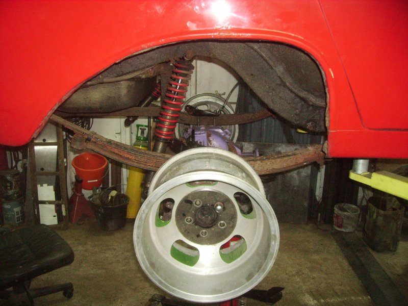

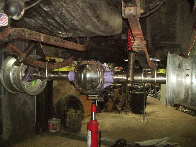

today we made spring perches for the exploder axle. we knew the axle needed to sit slightly rearwards from stock with bigger wheels on a mk3 so we drilled 3 holes 3/4" apart in each perch for the spring centre bolt to go in. we lifted the axle upon my trans' jack with the perches in place choosing the centre hole 3/4" back from stock as a starting point. then ash' knocked the wheel studs out of the old long halfshaft and fitted them to the new 2nd short shaft. we fitted both shafts, c clips and pin in the diff' and resealed the (once was) chrome cover back in place. after measuring side to side to locate the axle between the arches i dug out my digital inclinometer (angle finder) to set the pinion angle to match the engine/box, which are now both at 3 degrees. lastly we welded the spring perches in place, sat the wheels back on it and stood back to admire our work, lol. the one other thing done today was to straighten the gearbox dipstick tube, bend the bracket to suit and weld it to the tube. a new o ring with a smear or silicone (belt and braces) and that's done. we have to dig out all the bits of propshaft from over the road so we can make a new one up next.
