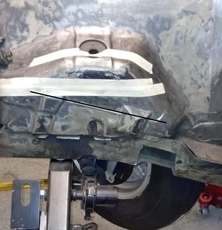

Moving on, here is the next cut now that Motor is out again for the next phase of surgery...... you can see where we had to take a bite out of the Chassis rail too!! That will be boxed and plated and the forward bars of the cage will also ensure the structural strength of the car.

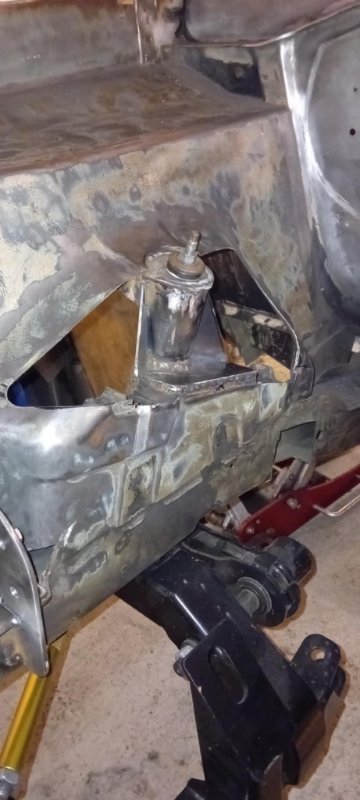

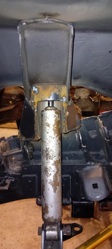

Big day, and time to grow a pair and buckle up.
No magic formula, but patient trial fit, measure, cut; repeat as necessary.
.. and quite a bit of lateral thinking...
Pass Shock tower modification.jpeg (53.55 KiB) Viewed 10485 times
Pass side Inner Fender tube installed.jpeg (50.46 KiB) Viewed 10485 times

Very clever, neat solution. 8-)
