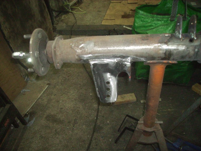

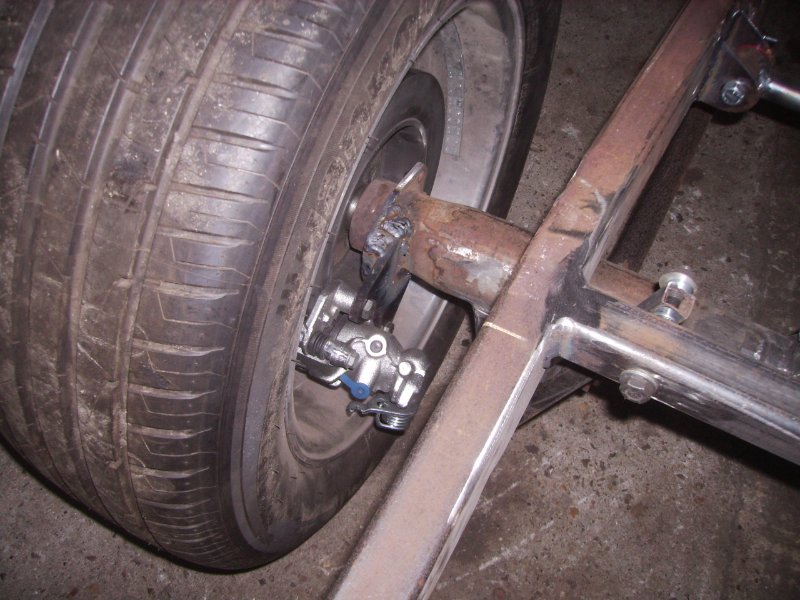

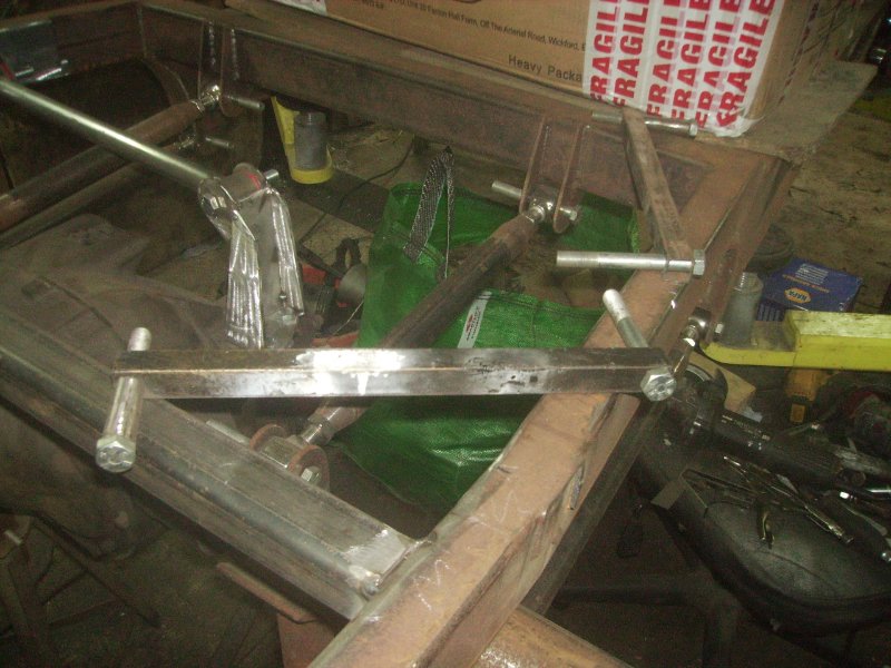

back to the model 'A', last night i collected the polybushes and sleeves for the panhard bar from my mate at rally design. it's handy as i call them and he brings what i need home, i give him the cash to take in the next day and i haven't had to go to the other side of whitstable myself. the problem with me collecting them is mcdonalds is just round the corner from rally design so it adds £20-30 to the cost of the parts .
so today we made a 'tower' to bolt to existing holes on the exploder diff housing with brackets attached. then chassis brackets so the bar could be measured and everything tacked together. lasstly we found a bit of old thin box to knock up a couple of mockup coilovers set at the right length for ride height.
neil.

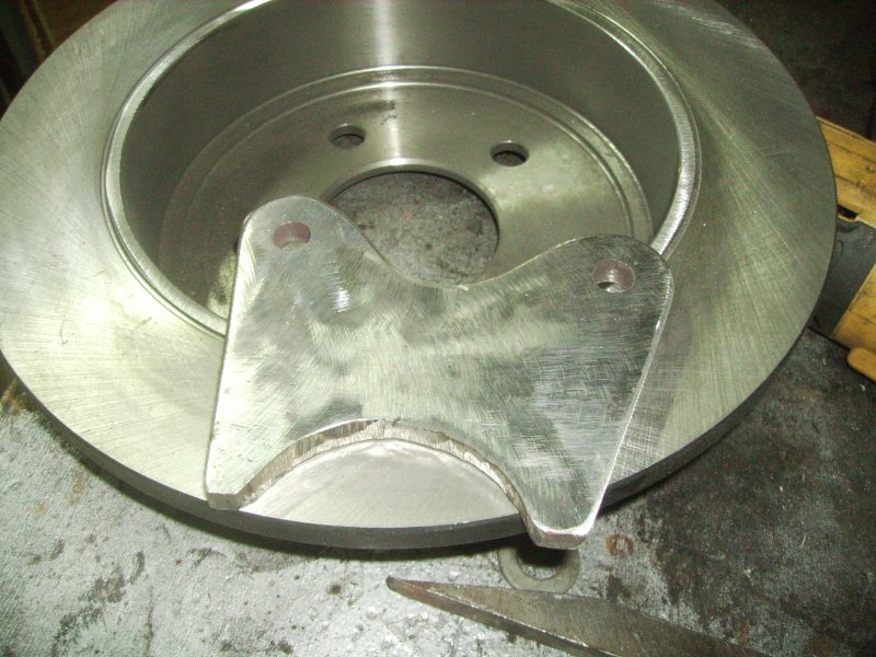

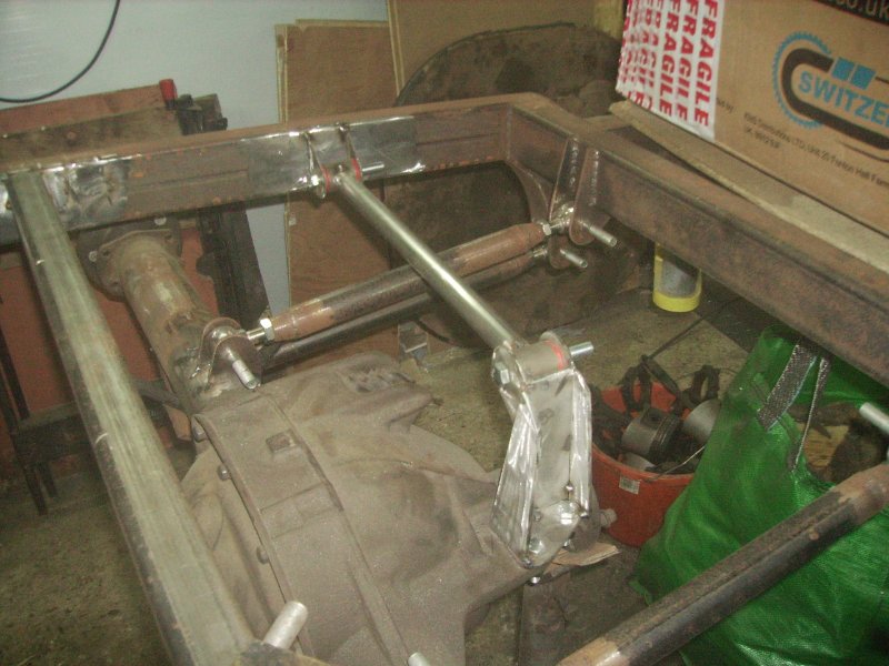

today we made the coilover mounts, top's are a length of tube through the new crossmember and bottom the usual 3 hole hang off the back of the axle deal. we incorporated the lower 4 link brackets into these to reduce the amount of brackets a bit. we need to weld the chassis ends and the panhard bar ends now and that only leaves the caliper brackets to make. the templates will be handy as i'll use them for my nash which is getting the same setup.

today we finished all the welding...... well nearly all. we can't make the 2 caliper brackets yet as we (me) forgot to order brake pads which hold the caliper centred over the disc while the brackets are templated, doh! oh well 2-3 days the ebay ad says, so we should still have them made and the rear axle refitted so the chassis can go back this weekend coming. i'll try to tie up dropping this off with collecting the 32 coupe that's next.

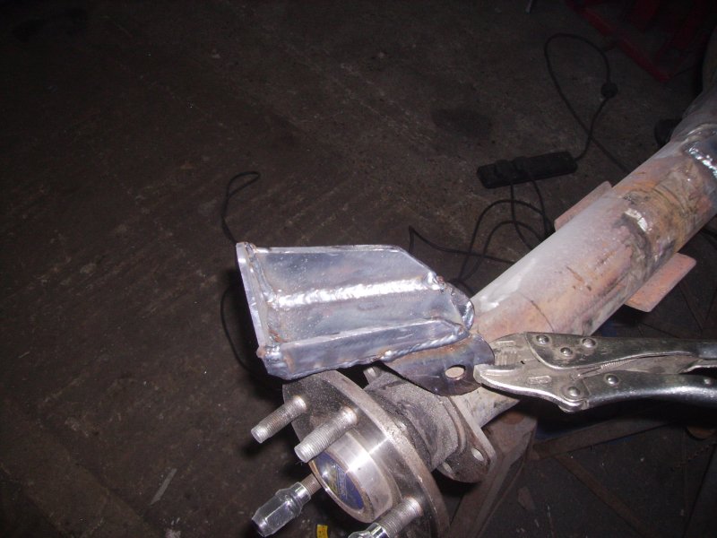

the brake pads didn't arrive so all we got done was the spacers etc for the coilovers and hung the axle back in place. never mind, it all needs doing :D

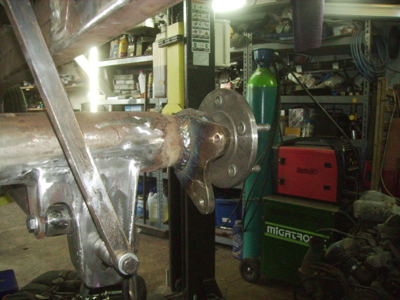

that one's all done ready to go back tomorrow. we welded the other caliper bracket in place and reassembled both sides. a quick sweep up and put all the tools away and that's that for today.
