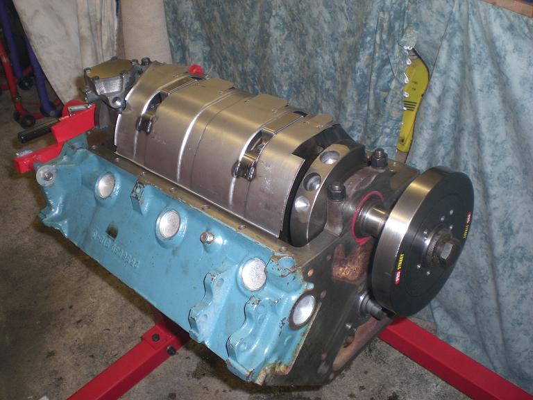

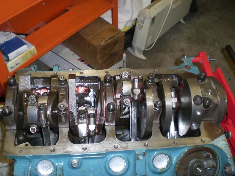

I managed to get in the garage this morning and managed to fit the cam, crank,pistons,rod and windage tray with oil pump so things are moving on well.
the cam was a bit tight so I used 2000 grit wet and dry to ease the bearing and now it spins well.
I fitted the main seal and the crank and once that was all torqued down i started to install all the pistons and rods and once that was complete I had to fit the oil pump and found it fouled the main studs so I had to cut the main stud thread down till it cleared. I was trying to install the timing chain but ran short of time so this is as far as I got today.
Windage tray installed
Crank and rods installed

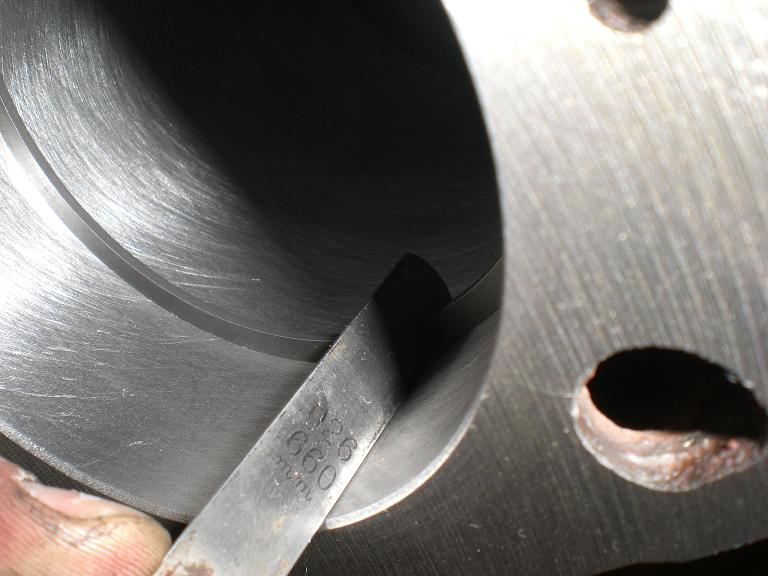

Gapping the rings
Gapping the rings

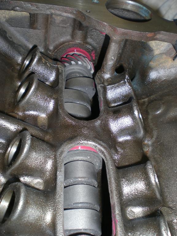

Cam installed
Cam installed

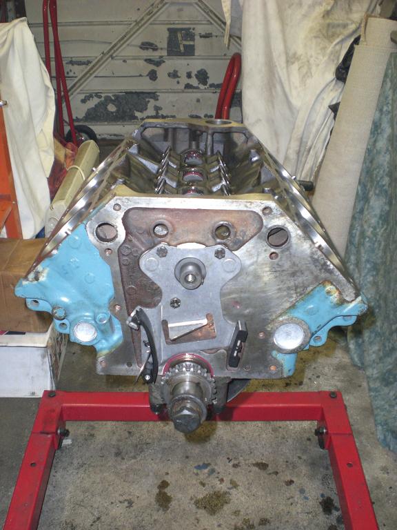

More
Cam chain tensioner installed but no time to finish the timing

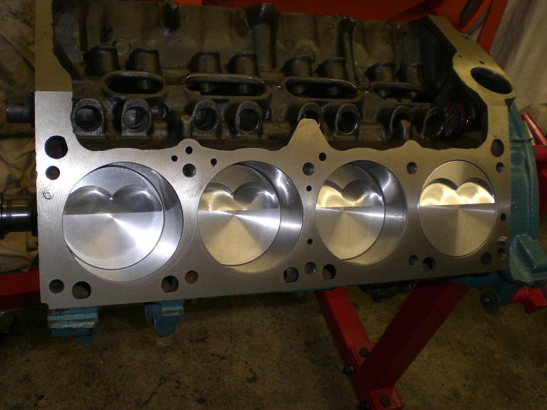

Pistons installed
Pistons installed

What`s the manufacturer of that oil slinger plate / timing chain ? I don`t recognise it
ANTON
Posts: 2046
Location: Sutton,Surrey
Post by ANTON »
Hi Jon
The oil plate is from macini racing and the timing gear is comp cams double roller set up.
Kev
Posts: 13955
Location: Brisbane, Oz.
Post by Kev »
Hello Fella! Progressing well. 8-) That bottom cam thrust plate bolt HAS got a hole in it, eh? (Just checking :thumbright: )

Kev wrote:Hello Fella! Progressing well. 8-) That bottom cam thrust plate bolt HAS got a hole in it, eh? (Just checking :thumbright: )
Yes Kev it does have a hole in it. By the way Kev I think you need a new MMA t-shirt as the one you a wearing with Matt is very faded!! :lol: :lol:

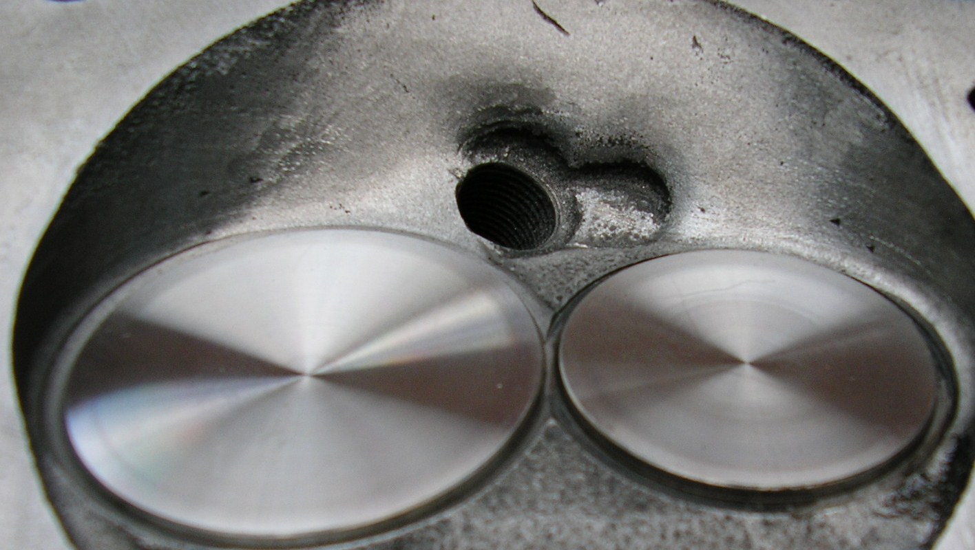

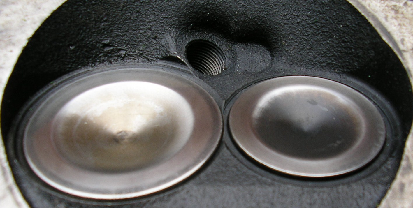

Hi Anton,
How's this for valve and sparkplug deshrouding for 340/360 heads?
Second piccy has the Ferrera Nailhead valves to up the compression.
First piccy shows stock-chamber with stock 2.02's with dishheads.
Bacca.
340 re-shaped chamber.JPG (211.55 KiB) Viewed 1185 times
340 standard chamber.JPG (204.38 KiB) Viewed 1185 times
