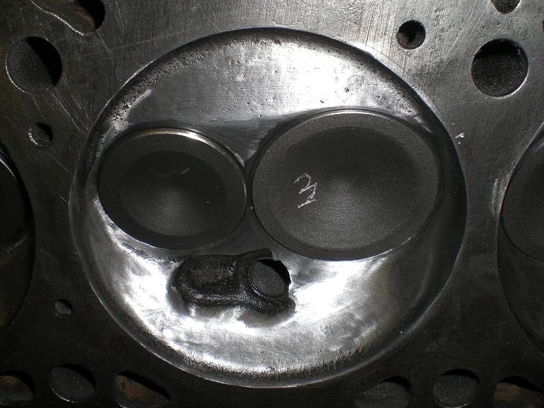

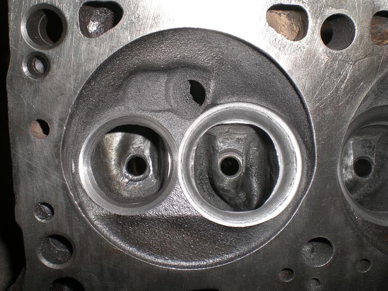

The bowl work in picture two is what Len (cylinder head shop) told me is very important to do to de-shroud the spark plug. Hopefully my valves will be totally de-shrouded by the 5 angle valve job I having done at the moment. I will post pictures once I get the heads back.
ANTON wrote:The bowl work in picture two is what Len (cylinder head shop) told me is very important to do to de-shroud the spark plug. Hopefully my valves will be totally de-shrouded by the 5 angle valve job I having done at the moment. I will post pictures once I get the heads back.
Nothing to do with the spark plug. De-shrouding gives more room around the valve for better airflow close to the side of the chamber and the top of the cylinder. For better airflow while the valve is not fully open. You can match the chamber shape to the head gasket in this area around the back of the valves.
When you de-shroud the valves you should also chamfer the top of the cylinder to match. Again using the head gasket as a template but only go half way down to where the top ring stops.
Or am I getting mixed up with valve reliefs? :?
Perfect explanation Dave. :thumbright:
Anton , are you opening the chamber around intake valve? , as Dave says gasket match the chamber , notch the bores & dimple the pistons , maybe think about grooving the chamber between int/ex valves out towards the squish pad (helps regards knock) , what is the reasoning behind cutting around spark plug area? , maybe something to do with keeping this area clean & free from carbon build up?
Spark plug type will play a part regards cutting chamber around spark plug area , if using the projected type plug (as most do) i don't think you will see any benefit.
Good to see all the hard work you are putting into this new build , can only net good results , keep on keepin on.

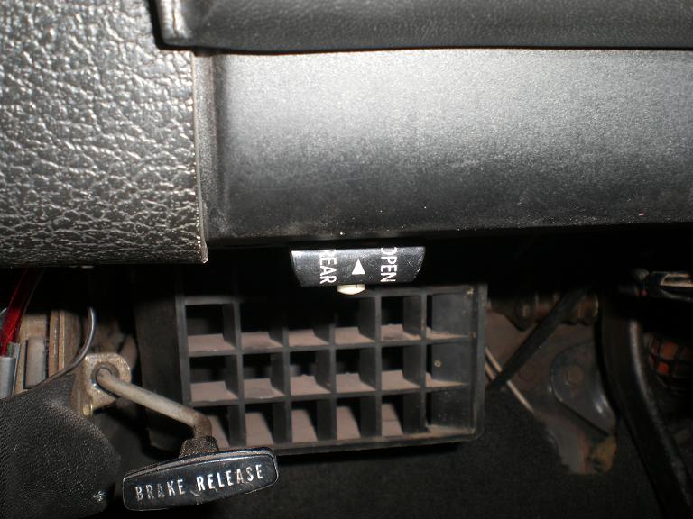

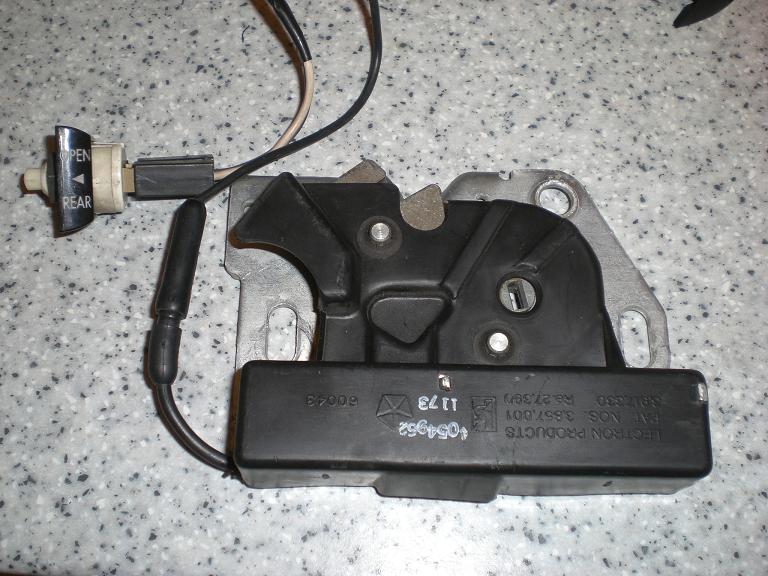

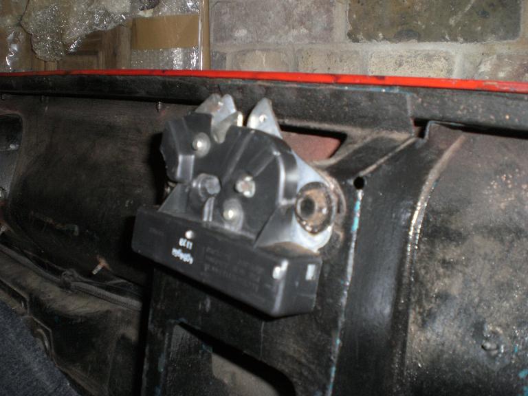

I have added a touch to my car to make it easier to get into the trunk when the car is warming up and should stop the chance of locking the keys in the trunk.
Here is a video of it working
Button hidden under dash
electric trunk release
latil
Posts: 12076
Post by latil »
Nice touch :thumbright: Mine has a solenoid/rod setup that may or may not be original although the chrome centre console button looks correct!

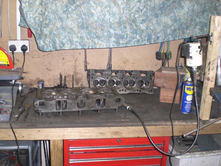

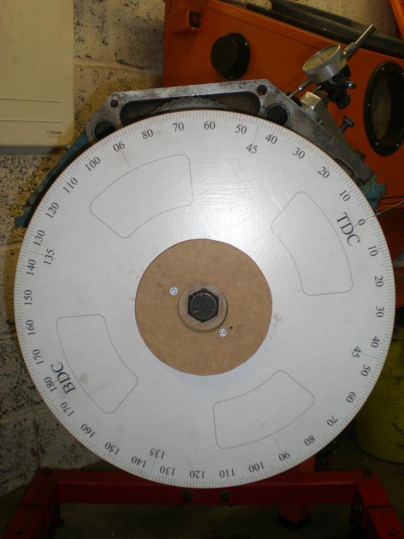

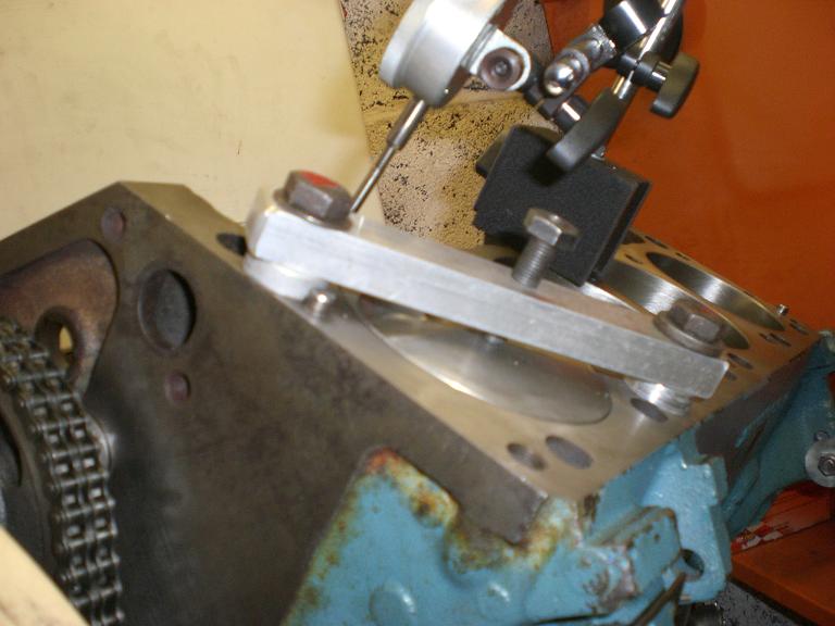

since I last posted I have dialed in the cam. The comp cam chain and sprocket I was using caused all sorts of problems. When installed correctly the timing was out 6 degrees so the only way I could get 106' centre line as the spec sheet said was to set the sprockets up to full retard and then move the came on tooth on the chain and then it was perfect. I wasn't happy to do this so Baccaman brought a spare chain and sprocket kit over that he had and we put that on and it was 105' first time so I traded some bits with baccaman for his chain and sprocket. Now with the timing done and the heads ready to go and have the new larger valves installed.

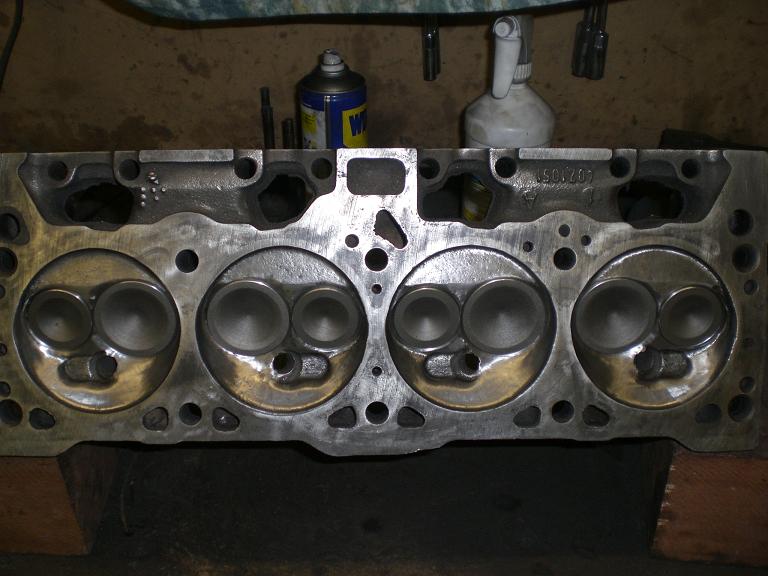

I got the heads back last Monday and and Len(Cylinder head shop) could only do a 3 angle valve job as the 5 angle job would have cut into the exhaust valve seat. I been porting the heads and doing the bowl work and I should be done tomorrow and the Baccaman and cc the heads and skim then till I have 60cc chamber and then I can build the heads up and finish the engine.
Back to the dirty job of porting the heads. I will post pictures of the finished article.
Heads back with new larger inlet valve and 3 angle valve job
home made piston stop to get perfect TDC
Large Home made degree wheel for better accuracy

Thats some degree wheel you have there :shock:

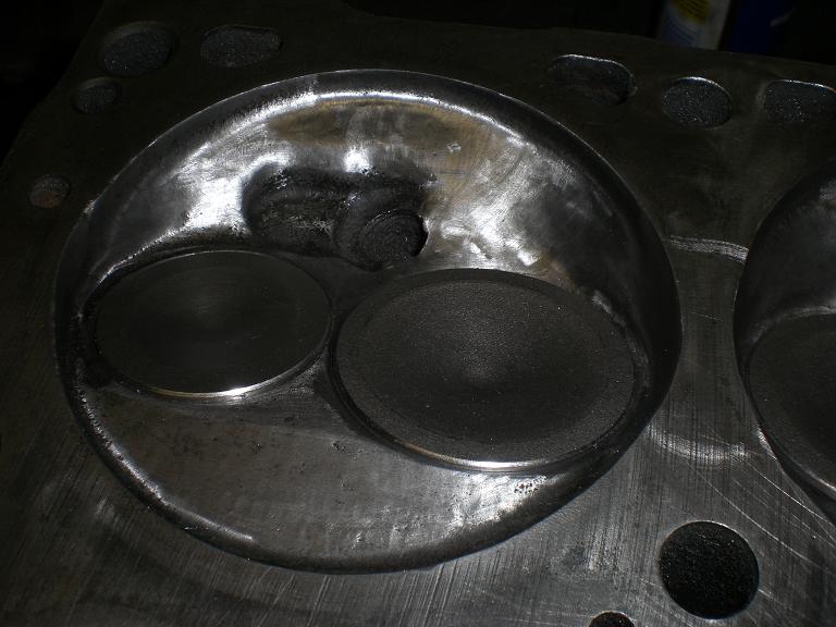

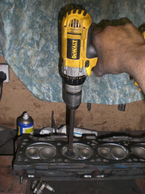

I finally finished porting the heads and doing the bowl work and lapping the valves in. It is such a dirty job but very for filling when it is done and here are the photos of my handy work. I total the porting has taken about 40-45 hours to get to this stage and lots of cartridge rolls of all grades. All that if left is to cc the cambers and skim the heads till the chambers are 60cc's
Lapping the valves with the help of a cordless drill to speed thing up

Guy wrote:Thats some degree wheel you have there :shock:
I didn't want to waste money on buying a degree wheel that I would use one or twice and while I was making one I made a big one.
