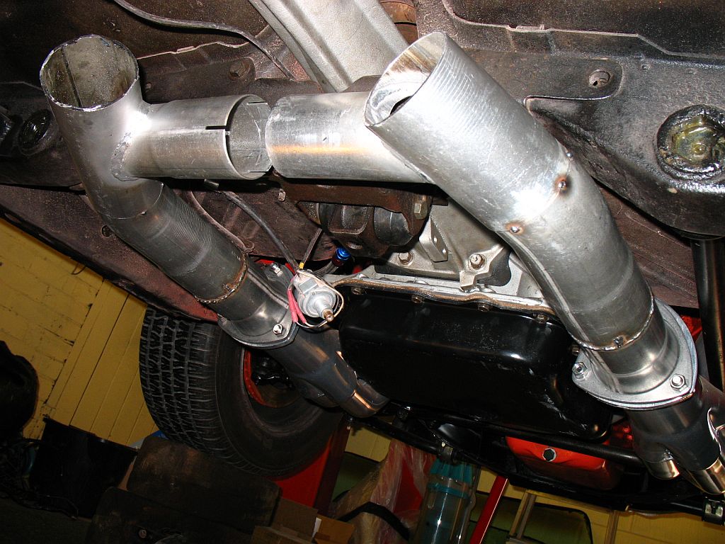

My 3inch EX pipe would have hit the G/V but i was lucky that the 400 block dropped it down enough for some clearance.
Just keep at it, with what you got if your budget is tight. personally i love making exhaust systems up

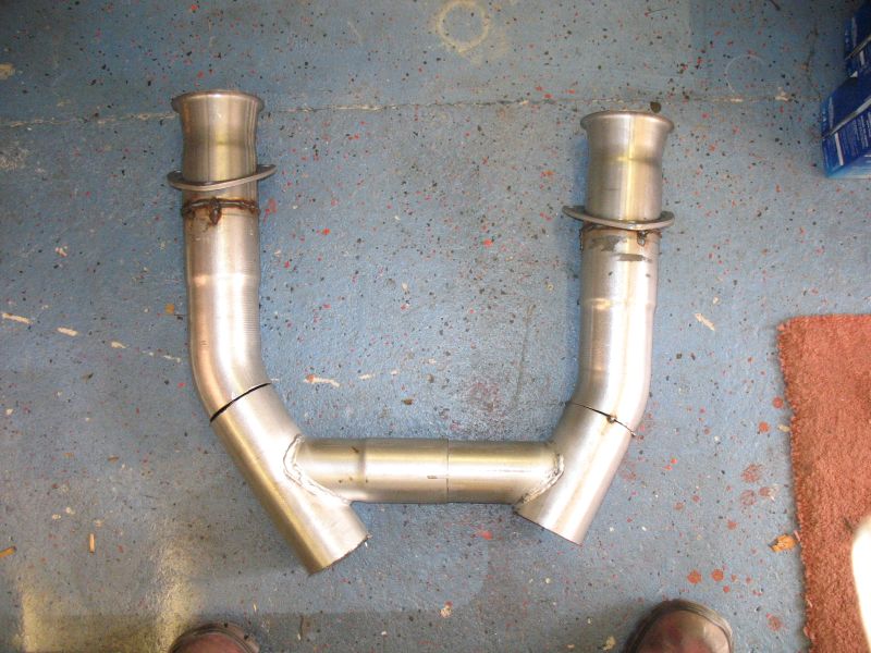

Mine needs more than a slight drop as the pipes run almost alongside each other right where the GV is.
So I have to make the pipes run wider either side of it.

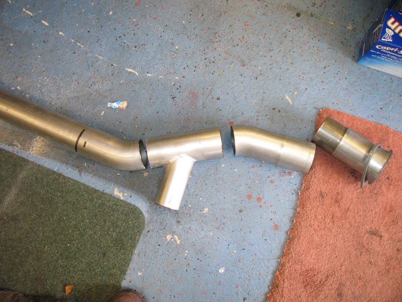

I made a start this afternoon but it felt odd cutting a brand new exhaust system up into little bits.
Although I have the ballance pipe together in the photo below (so that they will line up when I weld it) they actually need to be seperated and an extra length of 2.5" pipe welded in.
Since I don't have a bit of 2.5 pipe handy it will have to wait a few days until I can find a scrap bit somewhere.
I am going to have to drop the mufflers about a half inch for the pipes to clear the prop loop and because that will then lower the tail pipe I will have to cut a section out of that too so that the tips fit in the vallance cut-outs correctly.
Not easy work when you suffer fatigue easily but it has to be done.
