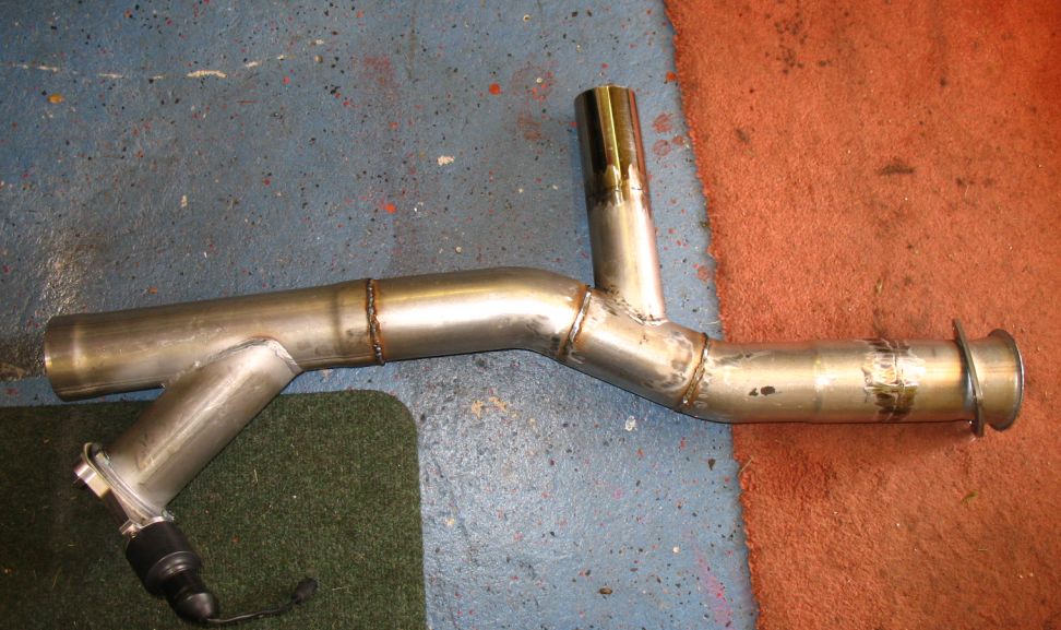

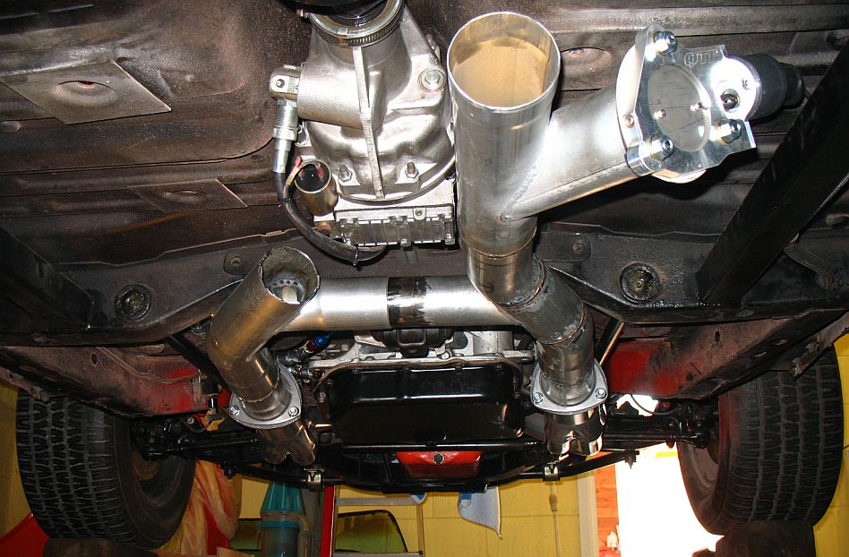

4 hours work on the exhaust today and not a lot to show for it. But I only have 18 inches to get to the muffler.
However there is going to be a tricky angle for that bit. I am in two minds about the positioning and angle of the mufflers.
Now coming alongside the overdrive sump and angled slightly down to clear the prop loop. Completely the opposite to the angle up to the muffler I need.
Six sections - five welds so far.

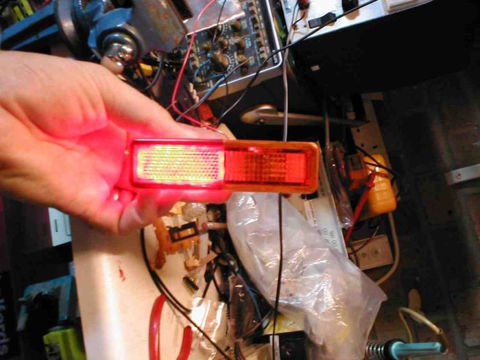

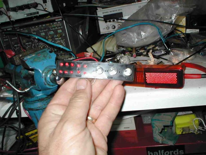

Further to that, Dave, I had this email yonks ago from a guy who has a Landau (luxury two door Ford hardtop). He is an electronic whiz, does stage lighting and stuff.
His comments may be of interest/use.
"With LED's there are lamps avilable which plug directly into the existing socket (see pic).
I tried some on the Landau with mixed results. Yes they wre brighter, but, they have a 20 degree beam angle and so put a definate blob of light only in the middle of the red rear light lens. The Fresnel lenses on the red perspex filters are designed to focus a filament lamp (radiating in all directions) to a parallel beam. So off centre where theres no light in the 20 degree beam the lenses look dull and unlit. I'm going to get around this basically by making a flat PCB which fits behind the lens, cover it in red LEDs on two circuits. One for side lights one fore brake lights. Run one circuit at a much higher current (20mA) than the side light one (5mA).
Another thing to remember is that on older cars the flash rate is set by a bimetal strip type of flasher controller. The rate dependent upon the load, lose a lamp and it flashes quicker. With LEDs the current they draw is so small it wont even warm the bimetal strip and so wont flash. You'll need to use one of the modern 3 terminal relays which have a timer chip in them to set the rate regardless of load. Thats whats in the Landau since the bimetal can gave up (bad contacts)"
For his side marker lights he made up a 10 led set up of 20mA LEDs (see pics)
10 leds in lens.jpg (65.29 KiB) Viewed 812 times
10 Leds.jpg (73.91 KiB) Viewed 812 times
