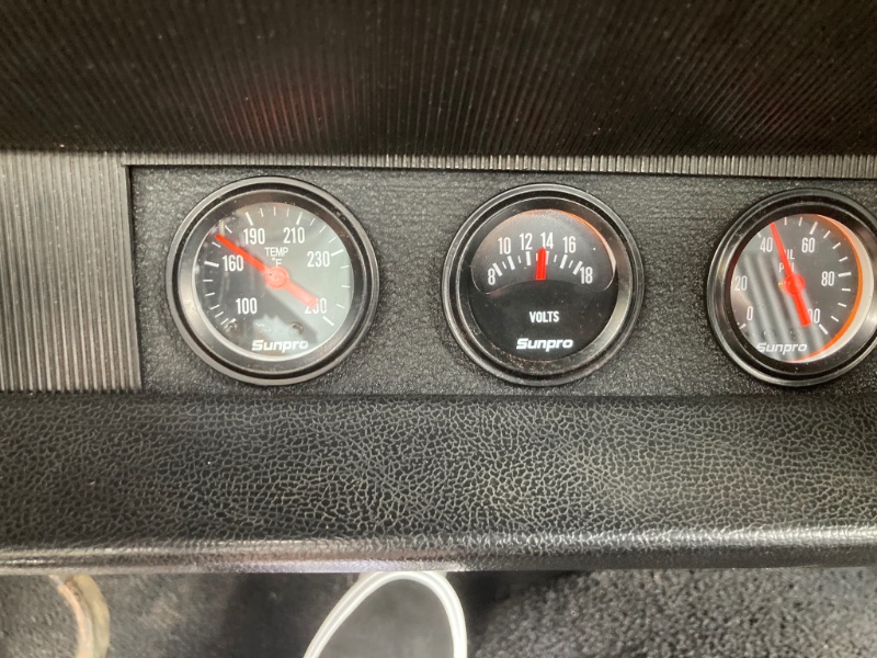

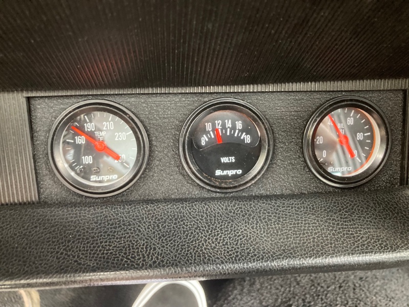

Happy to report no fuel leaks and battery overcharging woes seem to have gone thanks to the borrowed voltage regulator. :thumbright:
Went for a spin after having a bit of a game setting the float level on the secondary bowl and although it was running a bit rough, didn’t have any real issues. :rr:
Picking up vacuum gauge on Wednesday and will try and get it running right, but seemed to stutter under gentle acceleration so clearly haven’t got the mixture right. Alarmingly big jolt into drive and reverse too.
Overall, pleased to have learned a hell of a lot and put my ignorance and fear of carbs behind me. Now planning some plumbing upgrades for the near future and have plenty of time to do the alternator conversion at my leisure now. Props to Scotty Dave for the loan of the VR. :thumbright: :salute:
Happy gauges at idle and with a bit of throttle in the pics. 8-) :working:

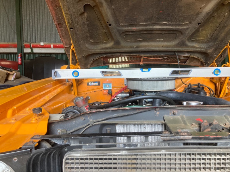

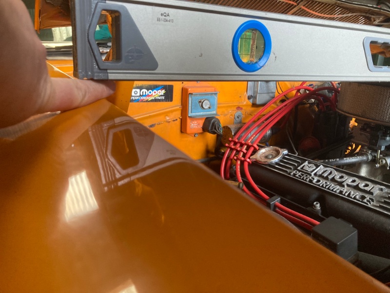

Next jobs on the list. The top of the air cleaner housing is getting scuffed on the edges, which led me to believe it was fouling the bonnet under vibration, so spent some time trying to peer through gaps with a torch and think I only have about 1-2cm clearance, so going to order a drop base and refurb the top that I have. Bit of hose fettling needed, so with that and changing the alternator, thinking it’s a good enough time to swap out the electric fuel pump for the mechanical one and do some plumbing upgrades.

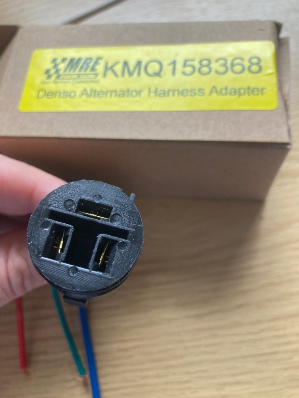

In good news Monday, Mancini order arrived this morning, so will figure out how to plumb that in through the week and see if I can get the job done at the weekend!
Can’t fault that service, less than a week to my door. I’ve ordered stuff from uk suppliers who “have it in stock” and still been chasing three weeks later. :roll:
Posts: 14435
If the kit doesn’t come with one, the correct multiplug will be available on eBay for a neat installation.

Blue wrote: Mon May 16, 22 11:52 am If the kit doesn’t come with one, the correct multiplug will be available on eBay for a neat installation.
This one? :)
Thanks Dave. I’ve no idea if anyone reads it or not or finds it useful or if I’m embarrassing myself, but it is what it is and maybe one day I’ll have stopped it all dripping everywhere and trying to set fire to me every time I go out. :D
Hopefully one day I’ll be able to go for a drive without sweating that I’m going to break down in a fantastically inconvenient place. :working: :lol:
Posts: 14435
Yes that's the one!

I know you have it sorted now, plasticine is always hand for checking clearance where you can’t see the gap
Keep up the good work :thumbright:
Posts: 7121
mopar_mark wrote: Tue May 17, 22 3:51 pm I know you have it sorted now, plasticine is always hand for checking clearance where you can’t see the gap
Cheers Mark. That’s a great tip, can’t believe I didn’t think of that! I’ll have to raid daughters craft draw and see if I can find some. :lol: I’ve been trying to find a drop base that will fit the same filter as the top, as I’d like to keep it matching the rocker covers, but not having much luck finding one the right size that I can guarantee will clear the transfer tube. Looks like Mancini may do one, but was hoping to find one in the uk as I just got my last order for them so a bugger to pay more shipping. #-o
