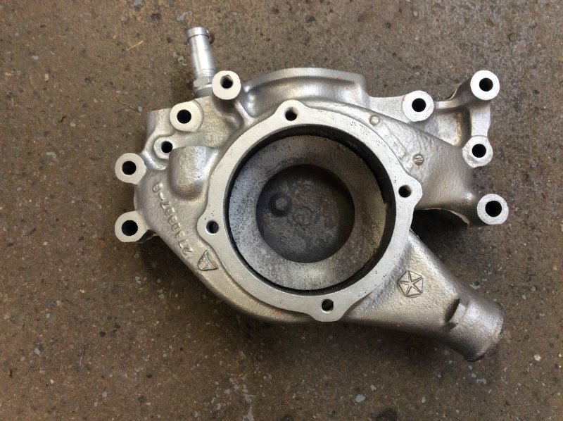

fit FlowKooler water pump,

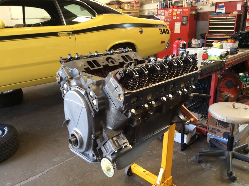

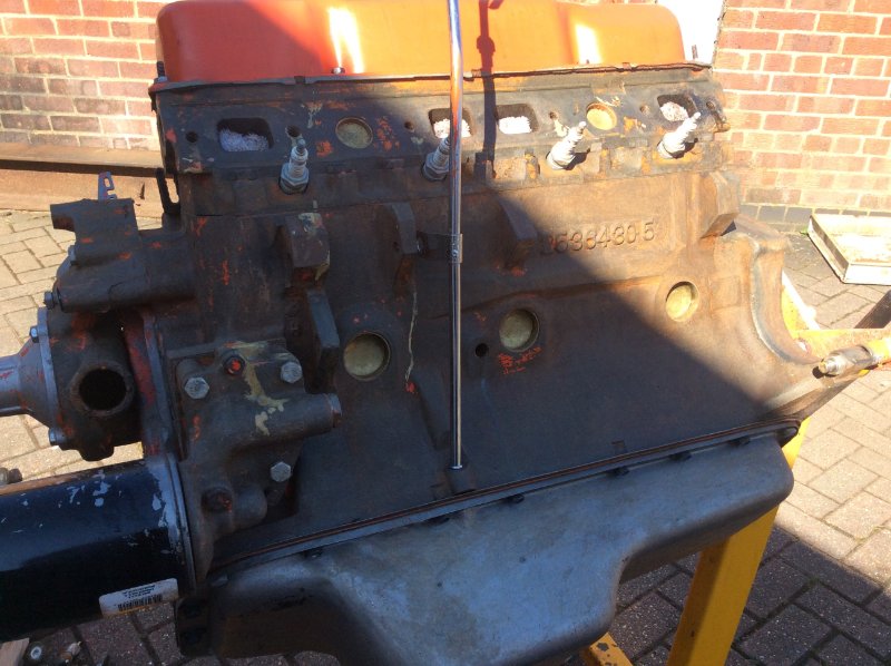

Engine out, pre-strip down. More oil leaks than first realised! And no, I don't know whose cuda that is!

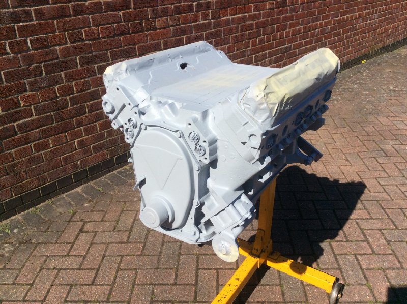

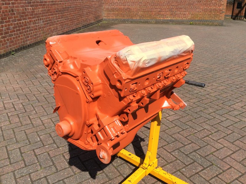

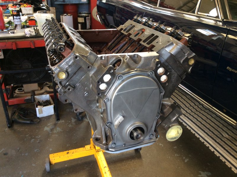

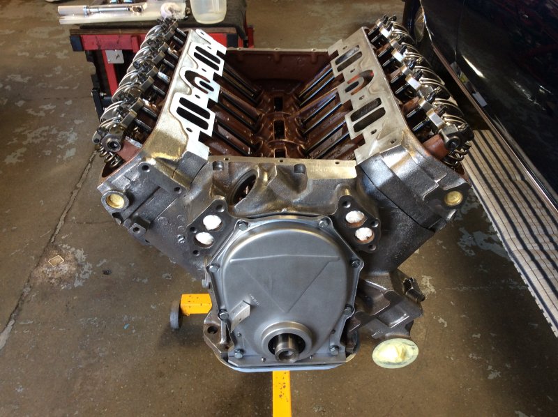

To fix all this and achieve a paint finish that we and Martin would be happy with, we agreed for him to strip what was already on there and start again.

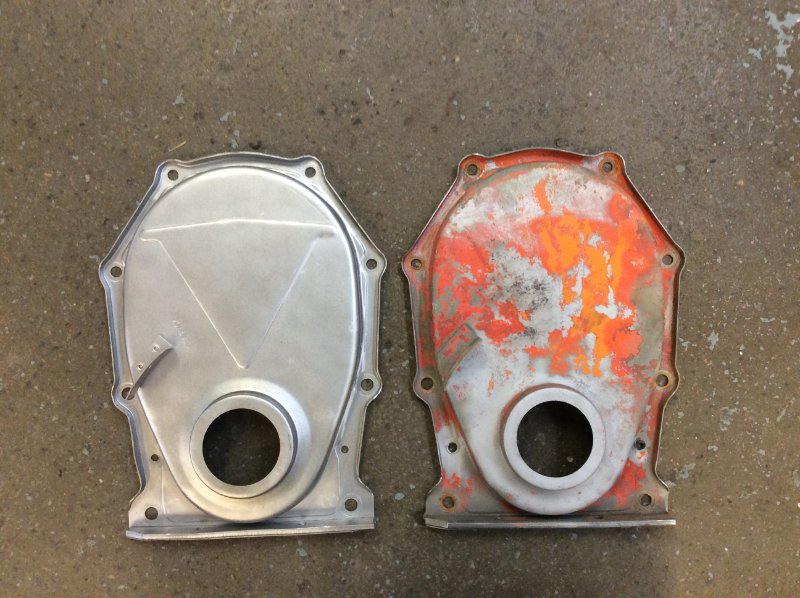

Back when Koffel were building the engine they fitted a chrome timing cover, despite knowing we wanted a stock-looking engine. So we asked them to change it for a plain steel one which would be painted over here anyway. Once Martin had stripped all the paint he found that the timing cover they fitted looked at best second-hand, and was leaking oil. Luckily Martin had a spare.

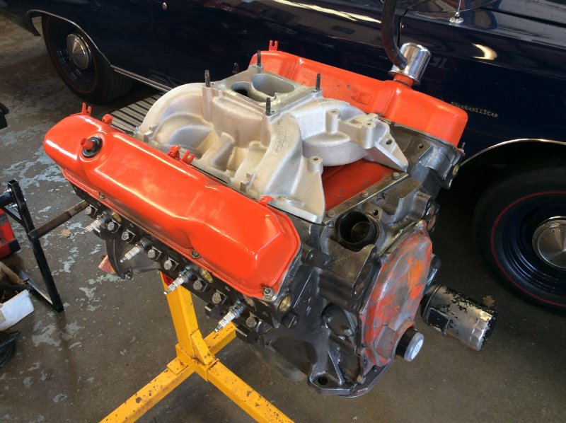

Partly stripped, timing cover horrors becoming apparent
Inlet blasted
Inlet blasted
Out with the crappy old, in with the nice old

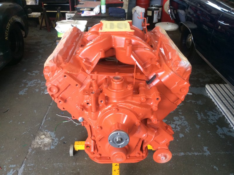

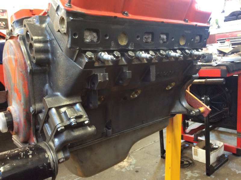

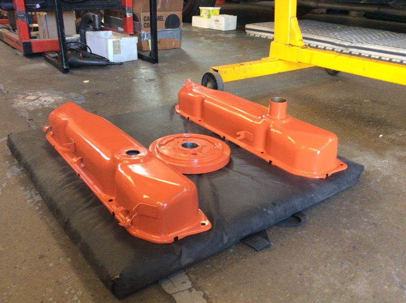

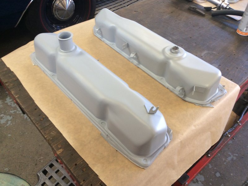

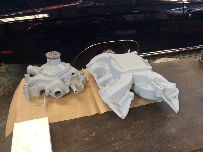

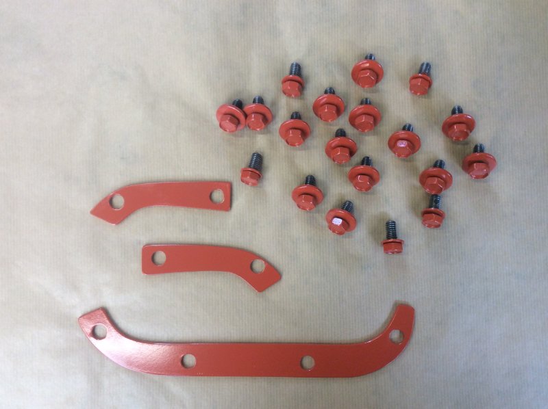

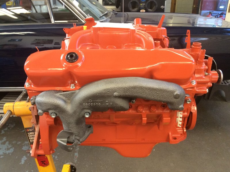

Other places that needed re-sealing were the inlet manifold, sump, and of course the valve covers we’d had on and off a few times.
Other issues included the fuel pump not sitting flush on its mounting surface, so some of the casting needed grinding away.

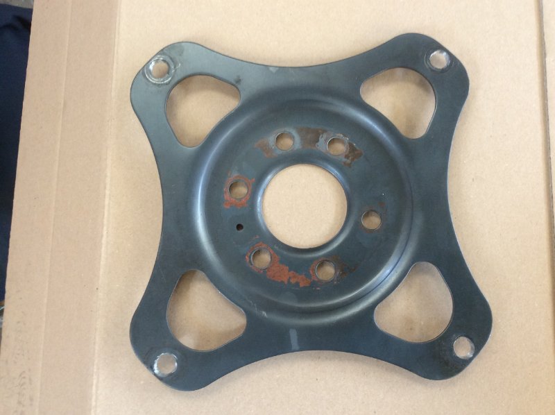

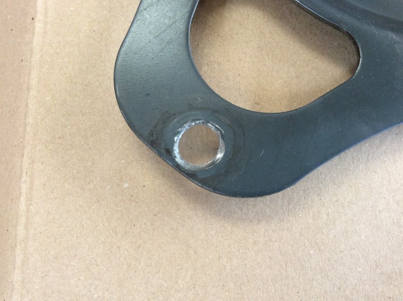

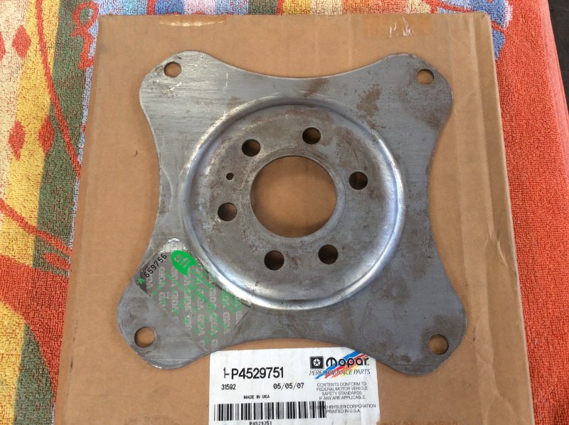

Flex plate holes had been enlarged/elongated badly so needed to be replaced. New replacement supplied by Geof Hauser.
Butchered old flex plate
'NOS' replacement from HRC

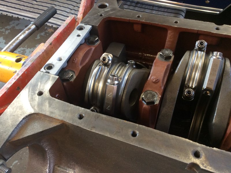

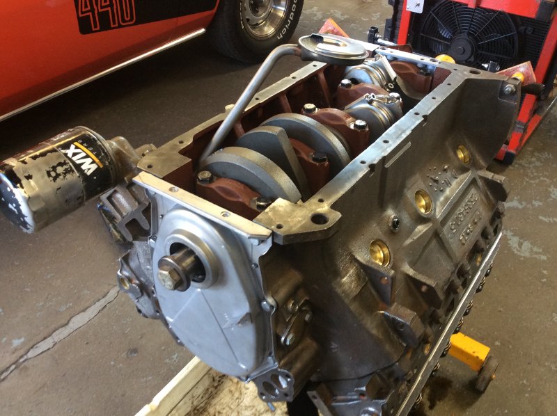

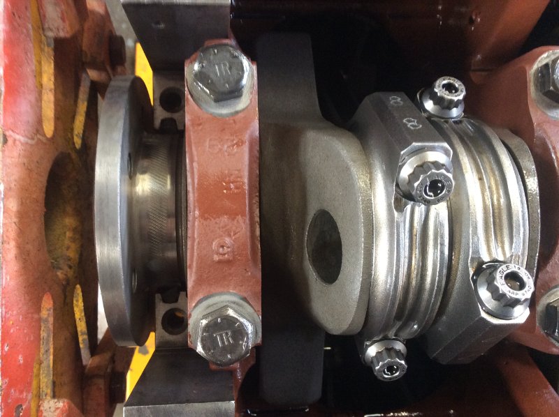

I hadn’t noticed when Koffel sent photos of the build but Martin pointed out that they had used standard main cap bolts; not upgraded to ARP.
No oil slinger had been fitted.
And contributing to, if not causing our rear main leak, Martin found that the knurling on the journal where the seal sits was more pronounced on one side than the other, plus overall it was a lot more pronounced than usual. Koffel hadn’t fitted the side seals properly so had used a lot of sealer to compensate, but still hadn’t managed to make it seal.
Another disappointing discovery was some scoring on the rear main bearings, not terminal but a sign that something has passed thru the system. The oil pick up screen had a fair amount of gasket material in it.
Enough doom and gloom, back to the stripping :shock:
Rear main seal knurling

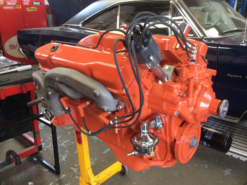

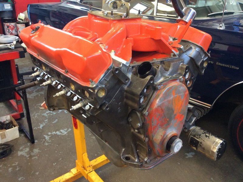

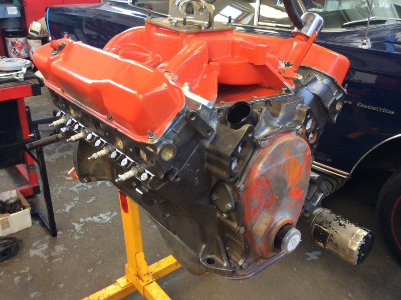

Ancillaries & bolt-ons....

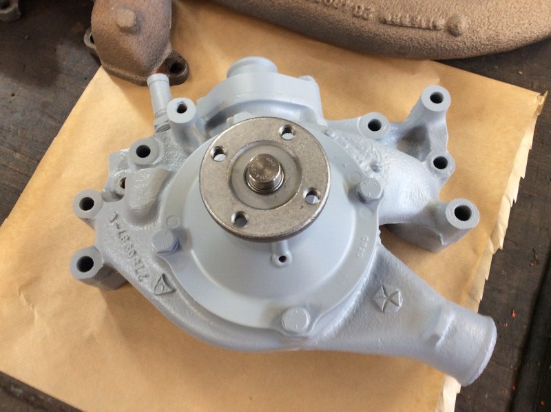

FlowKooler pump fitted, etch primed

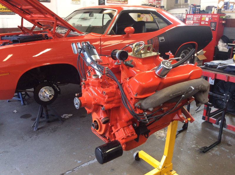

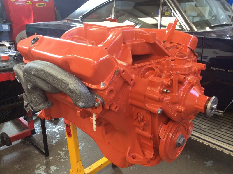

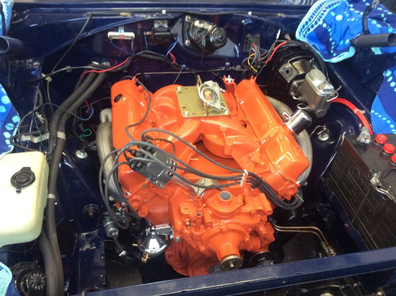

Luckily the weather was kind back in April, plus it helped having an empty car park so no complaints about over-spray!
Ready to go back in!

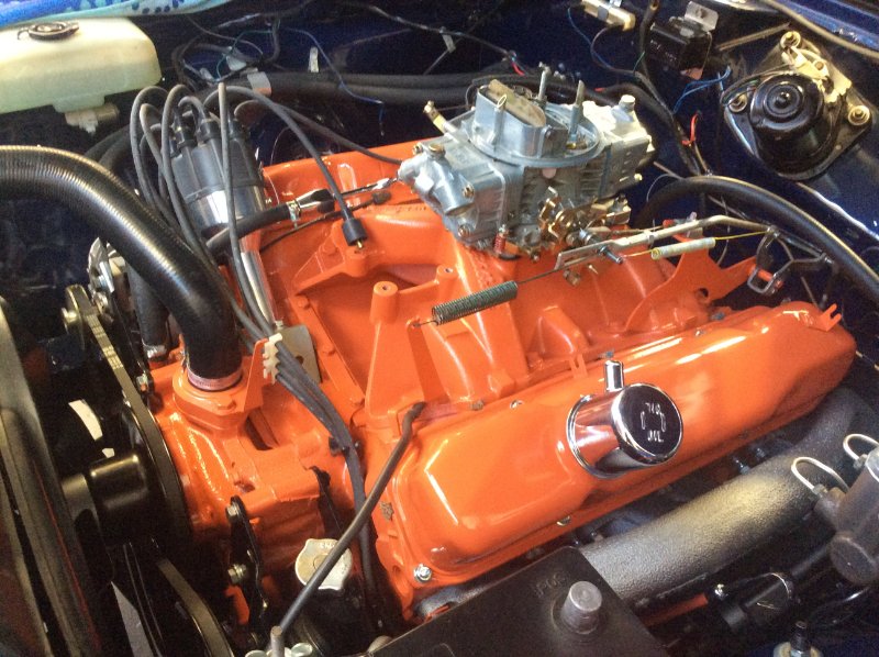

Then on May 13th... :thumbright:
On the home stretch :D Almost :?
So the big question was has the rear main leak been fixed? After running the car up on axle stands for 20 mins, going thru the gears, no leaks were detected. But after road-testing for a few miles, the pesky rear seal started leaking #-o

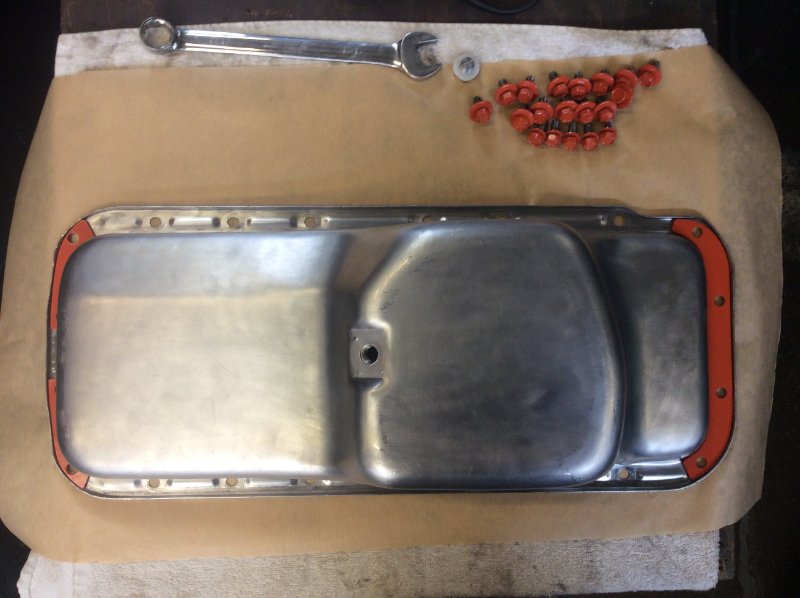

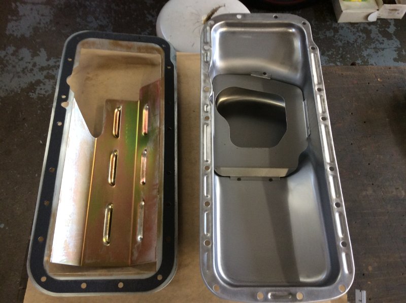

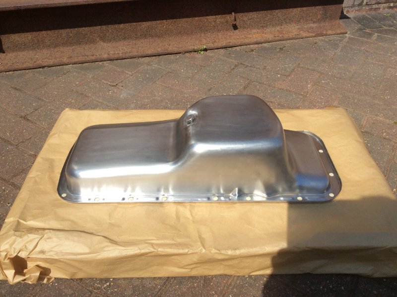

Martin also noticed that the sump wasn't sealing very well and blamed that on the fact that the lip around the mounting holes on the aftermarket piece were too close to the perimeter lip so there want enough room for a washer to sit flat, so he made up some reinforcing plates to spread the load:
Which cured the sump leak :thumbright:
