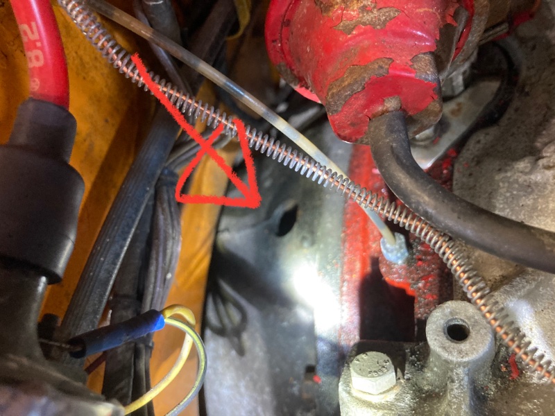

Still looking for recommendations on the gaskets, but in the meantime I noticed another hole I’m unsure of… I say noticed, as in narrowly avoided a bolt I dropped falling into it and never noticed it before!
Is there meant to be an exposed hole here on top of the trans?!

... and relax... normal.
Van / Motorhone Trans... wait for the oracle to confirm....

Yes, that's correct. Vans & 'homes had the timing marks on the convertor visible through that hole due to less than Bananarama! all visibility under the bonnet. They have a "doghouse" over the engine which you remove for engine access inside the vehicle. Bracket racers in the States also cut a hole like that in the top of the bellhousing, they run a hosepipe in there to cool down the torque converter between rounds. The stuff you learn here...

Seems like an odd idea to have a hole there that can collect fluid. Guessing it drains somewhere? Suppose I’ve not noticed it before because I wasn’t watching a bolt bounce off the lip of it before.

The bottom of the bell housing is open so anything going in the top will fall out the bottom...

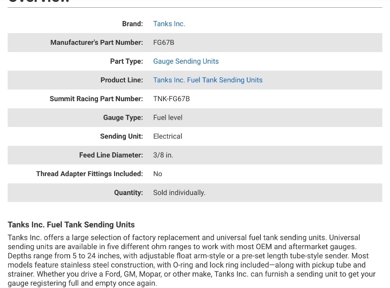

RE fuel sender, getting confused as to what I need. Does this look right?
Shopping list so far :
3/8 sender
3/8 front to rear fuel line - steel seems to be about all I need? Any need to go stainless for twice the price?
Er… think that’s about it? All the front end stuff seems easy enough to source from the UK, unless I’m missing anything desperate?

If that’s for an E body then yes it’s correct. Just get a roll of cupro nickel off eBay and make your own fuel line, steel or stainless needs a serious tool to bend or flare, you can work cupro with cheap tools.
Unless you are doing a resto, there’s no need to go around the houses with a million bends like the stock fuel line does. Bends restrict flow, the tighter the bend the more restrictive it is so as straight as poss and keep the 90degree bends to a minimum. I’ll post a pic of how I run them later.
