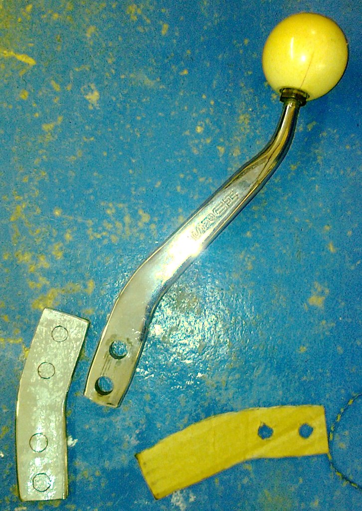

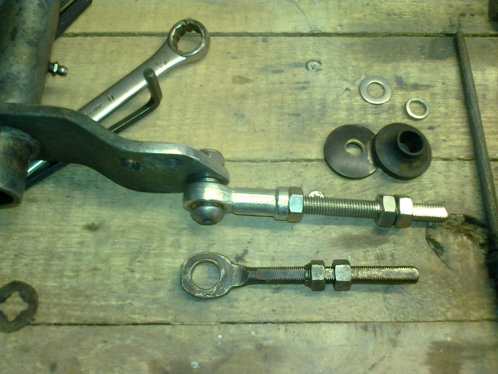

I made a longer and much improved clutch adjuster rod- i can now select gears with the engine running!
My gearstick was wrong so i made a plate to lengthen and angle it further back- this is all hidden inside the rubber boot.

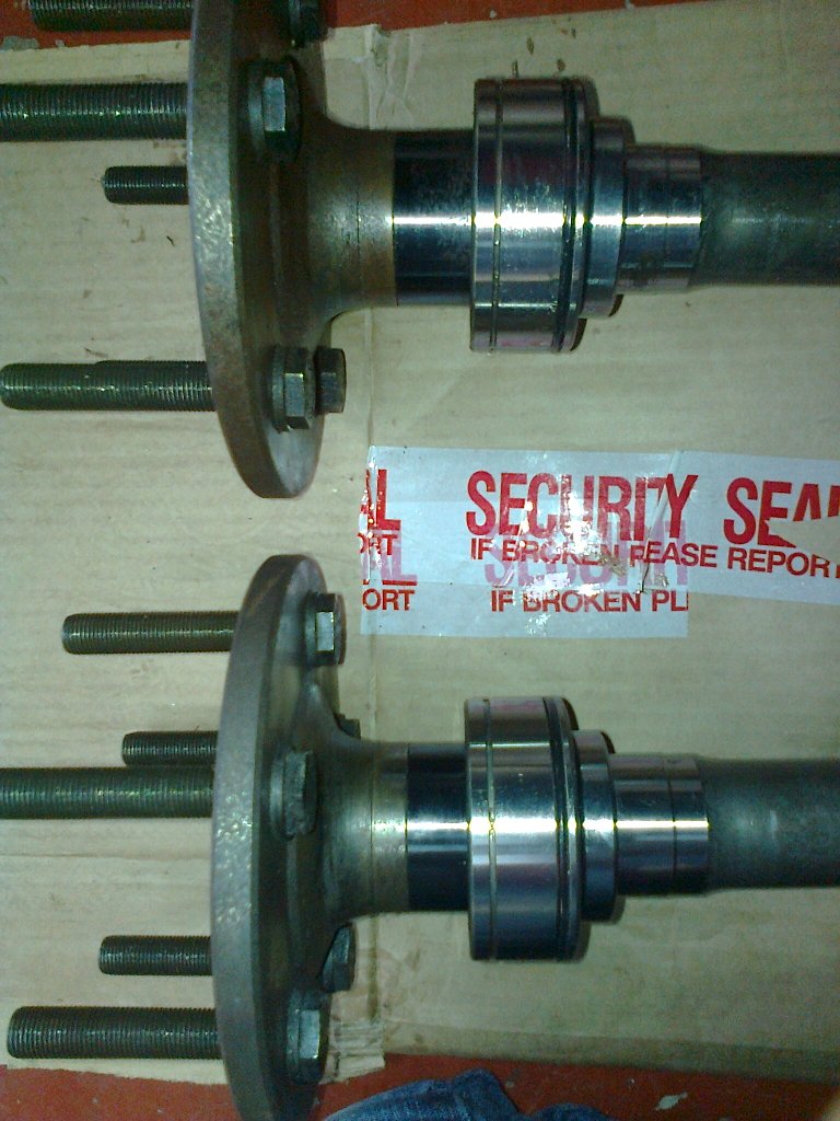

I've worked why I had one binding rear brake.
It baffled me for a while cos when i measured between the drum and backplate, the brake shoe was wider than the space ...
How could this be??? The only way this could happen is if the bearing was too far onto the shaft, not possible!
So, more investigating... i pulled both shafts out and bearing on the GOOD side wasn't on properly- Didn't make sense til i realised the retaining collars should be in front of the backplates- i'd fitted 'em behind. It was a case of two wrongs making a right
Anyhoo... all sortd now
