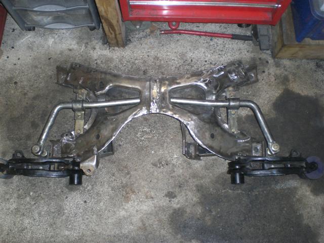

ANTON wrote:As in a previous post i was looking for a 1970 b-body k-frame as i wanted to fit the 1970 anti roll bar to my charger and as i didn't want to pay what they cost i decided to modify my 68 k-frame with John's help. I popped round John's work last week and with the use of his oxy acetylene he heated up the area and I then put two big dents in the k-frame in the correct location to allow the anti roll bar to fit thought the k-frame. I only took 30mins to do and turned out well.
I will also get the k-frame re-powder coated at the same.

I spent a couple of hours in the garage today and with the modification I have already made to the k-frame to accept the 1970 anti roll bar I have also now fully welded the seams all round the k-frame and full welded the steering box mount to strengthen the whole k-frame. This along with the other modifications I am making should improve the handling of my car.

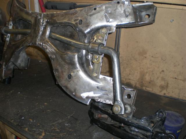

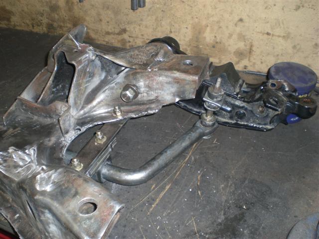

I spent the day in the garage and finished the anti roll bar set up on the k-frame and I also painted the brake master cylinder, wiper motor and coil.
I also cleaned up some more bits ready for powder coating.
Here are some pictures of how the anti roll bar set up came out.
finished article
finished article
CIMG7503 (Small).JPG (62.78 KiB) Viewed 1104 times
CIMG7515 (Small).JPG (58.9 KiB) Viewed 1104 times
CIMG7511 (Small).JPG (53.05 KiB) Viewed 1104 times
