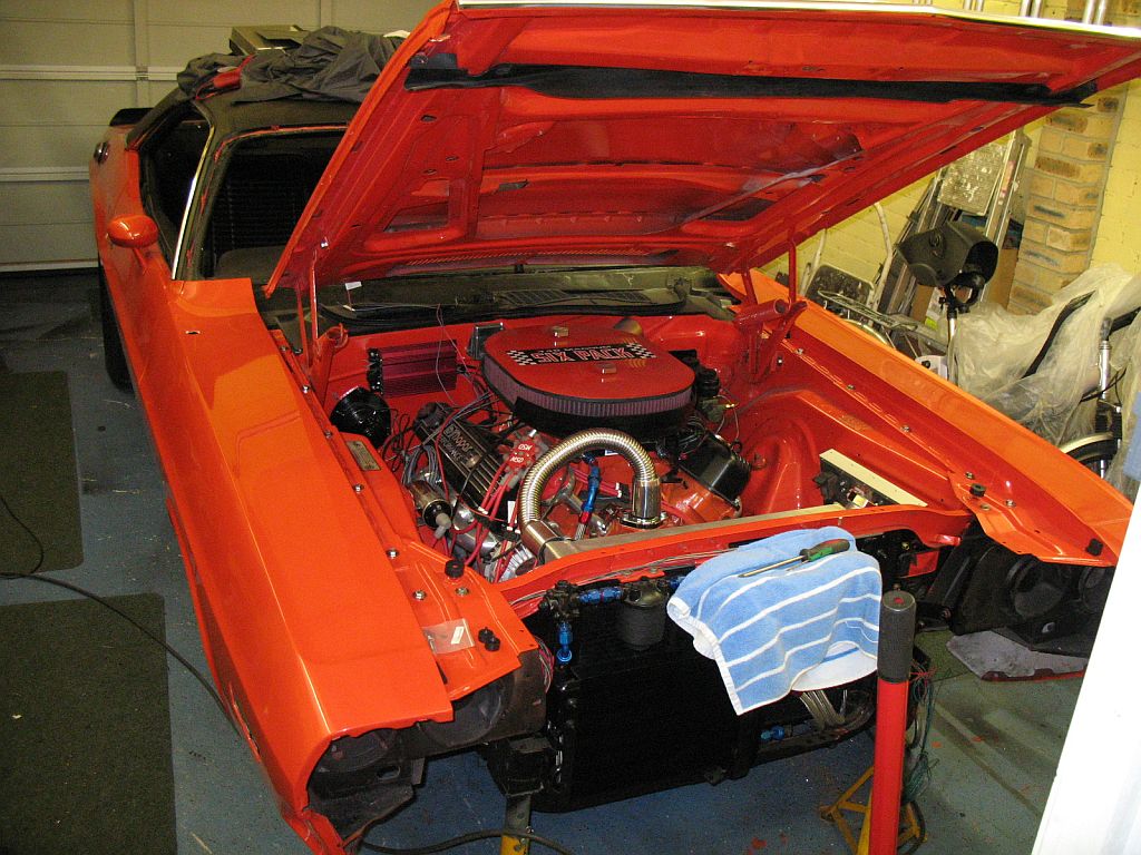

challenger wrote:the way you have the bumper bracket bolts in is identical to how the factory ones would have looked , just captive nuts on the inside of the chassis thats how mine are anyway ;)
Ah! Thanks! ;)
I almost did them as studs because two of them had been cobbled on like that and I thought maybe that is how they should be. But then I realised that captive nuts would be better so did it that way.
Sorry Pete. Didn't have time to clean that relay tonight. :lol:
Decided to have a argument with wor lass instead. :roll:
It looks better with the fenders on again. But still weeks of work to do even if I can keep well enough.
BTW I hate that bling top hose thing. But my cobbled together rubber one looked even worse. Not sure what to do with it. :?
Looking good Dave. 8-)
Love the idea to mount a fuse box and relays, think when i have the wiring on the charger done in the winter a may do something simalar under my battery tray.
Oh, Dave lose the bling top hose, cant you get a flexi rubber one for now?
Don't like flexy rubber ones either. They remind me of a sex toy a rather large girl in my old local demonstrated for us once. :roll:

Sorry if I'm being thick as usual :geek: but what's wrong with a std (rubber) rad hose? Is it cos of the non-std rad requires a longer hose?
Praps go the Adam/Alan in-line filter route..... :-k :D
Yes the top hose is longer than stock.
I have got around this in the past by butt joining two hoses together with a bit of steel pipe and a couple of jubilee clips.
I think I will put that on again. But a short length of exposed stainless steel tube might look better.

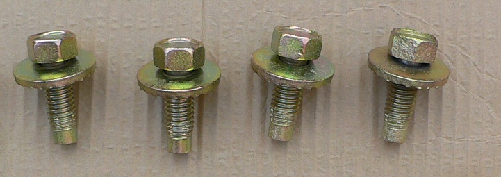

FWIW, here is a pic of the original bumper bracket bolts - as mentioned they had captive nuts inside the chassis rails. Note the teeth on the washers and the thickness. I'd plan to duplicate the latter at least
bumper bracket.jpg (110.16 KiB) Viewed 763 times

My problem there is that I already have a fan switch screwed into the water pump housing where one of the heater pipes would have gone.
Just a nice bit of stainless that sort of length would do. I can weld on a lip at each end to grip the hose.
