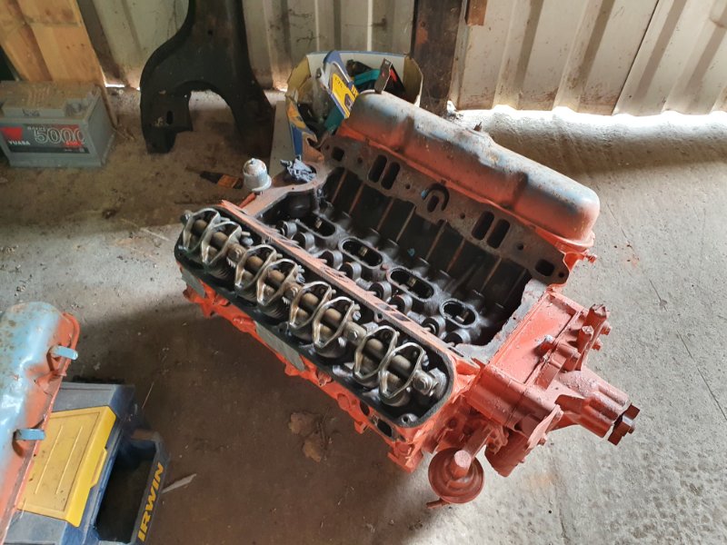

Motor time.......
First big piece of the jigsaw has been procured.

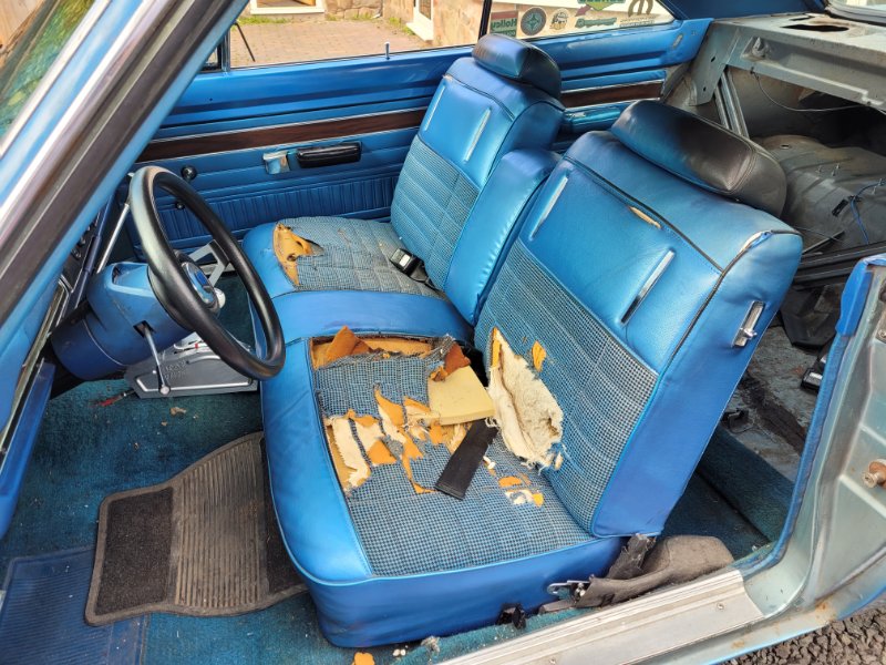

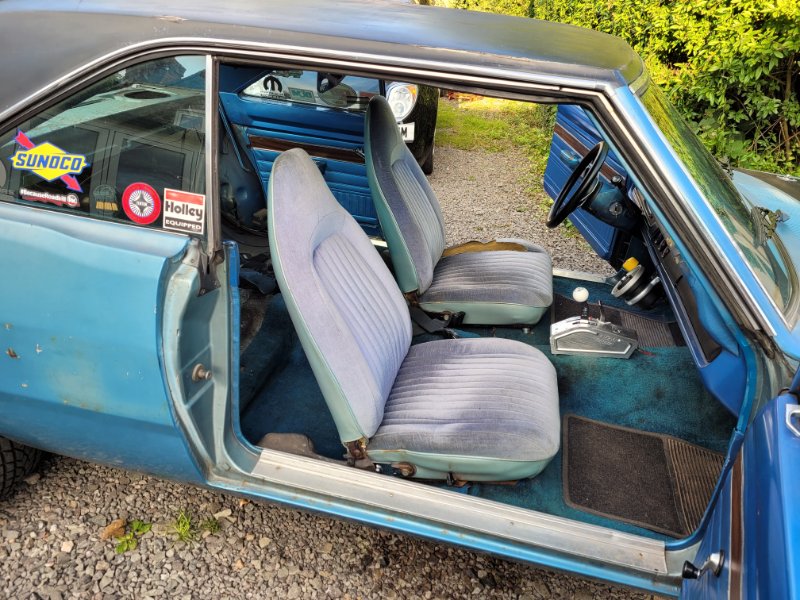

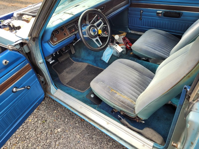

Next update..... Picked up some Challenger seats of Matt at the Nats so decided to get them in today. Recon I could do it in 4 hours........7 hours later.
Lost is messing around to get the seat hight correct left to right. Had to drill the floor pan for the additional bolts for the buckets, which is always nerve racking. Overall happy but have a query I will post else where.

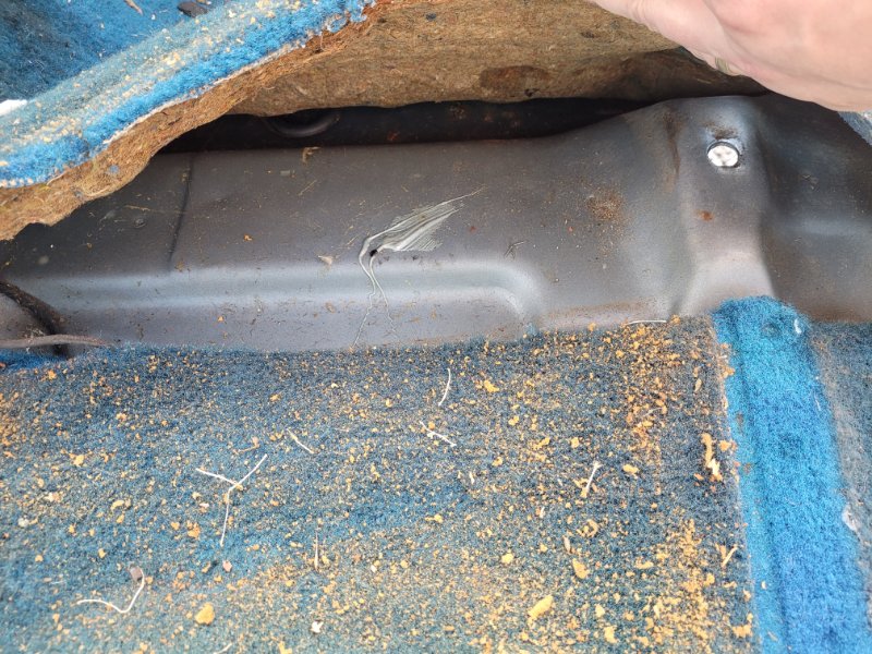

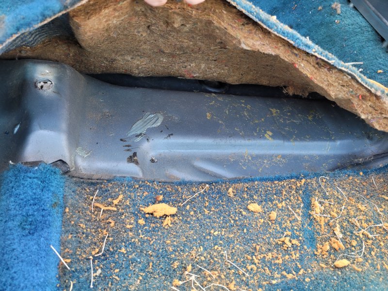

The floorpan was in great condition......

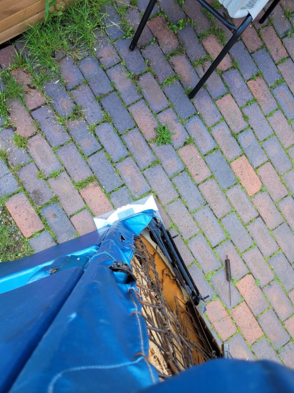

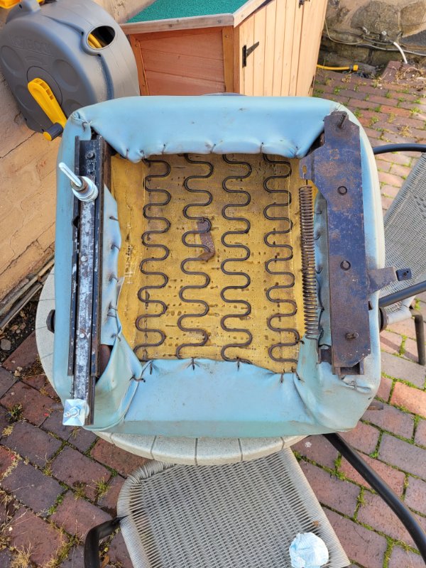

Decided to check out what morning from a bench to buckets would do for the car. Weight saving is just under 20kg.
49.4kg vs 15.4 (30.8)

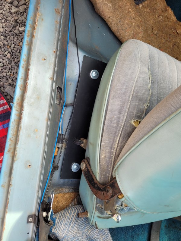

If its worth doing, it's worth doing twice. Strengthening plates measure and ordered to fill the recess and a large plate to offset from the factory hump.

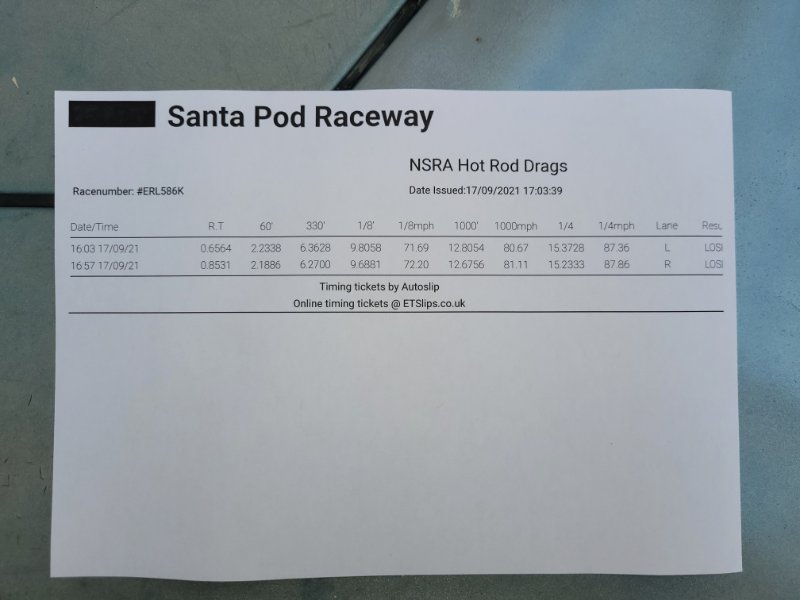

Well HRDs weekend was 250 miles and 2 runs deep. Car behaved very well and the Challenger seats are great long distance seats. Very soft and comfortable.
Big test was changing to electric fan. Lots of watching the gauge over the trip with average air temps in the low 20s. Hit 200, fan on back down to 185, so happy that it can look after itself full time.
So seats saved nearly 20kg and the removal of the static fan,
according to Engine masters could add circa 30HP at high RPM. I'll take 15 to 20 as mine doesn't go above 5k. I should add at this stage that I'm carrying some 'Covid' weight and nearly 1st heavier than my last runs in 2019. The above are the only changes.
Last run was 15.58 @ 87.35 mph in 2019.

Time
- 20210917_170557.jpg (71.27 KiB) Viewed 4219 times
Re: Dave's 72 Dart
First run fluffed the gears and shift light changing past 5.2k rpm when the car nosed over.
Second run got the shifts bang on but was deep in the beams and don't think I had the throttle buried.
I could of done with 5 runs like I did last time, with the aim of a few consistent times and putting it all together. Oh well.
Honestly i think the car has a 15.1 in it, maybe could even sneak a 15.0, just ran out of track time.
