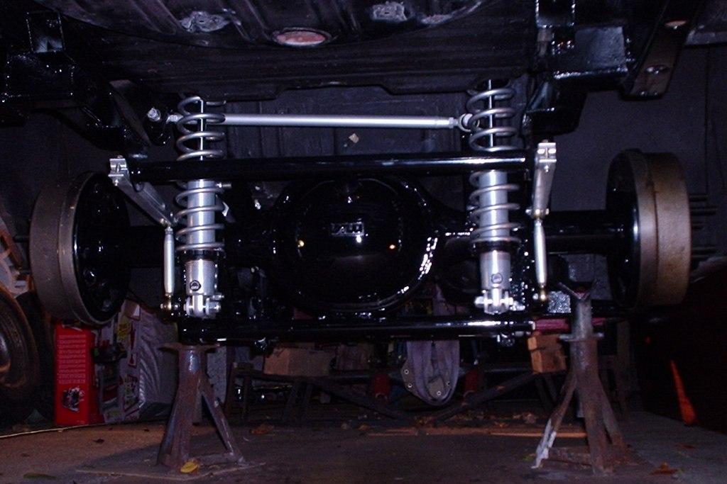

Mark, I assume you mean the diagonal bar between one of the front suspension mounts and the opposite axle end mount (as per a ladder bar)?
I agree that they are absolutely essential to control suspension movement safely.
When the Dart hit the wall at the Pod, this locator bent due to the force and the axle was free to move lateraly, scary stuff!!!!!

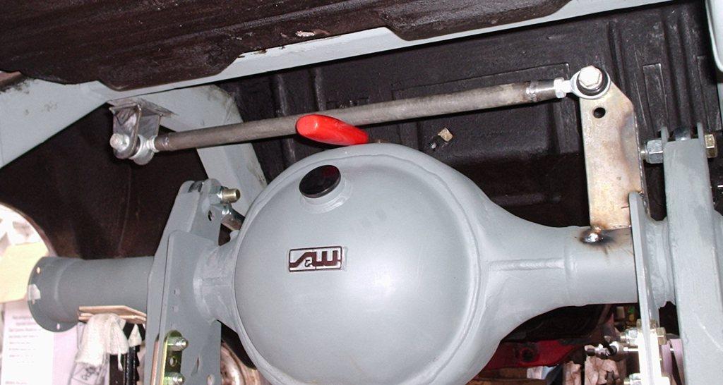

Posts: 6738
Not on my pc,as i would of posted a couple of pics from my set up, this link should help show what I mean
http://image.carcraft.com/f/techarticle ... guide+.jpg

I think we are on the same page!
Worry not... I have a Panhard across the top of the axle.
I got it from S&W along with the axle, so i know it's up to the job.
The clearance between brace and prop is about an inch, that's with the axle hanging at full shock extension. I can easily move it lower down if you think thats too close.
Do you think I need any more metal anywhere?
Axle rear view.JPG (91.65 KiB) Viewed 1183 times
Fitting Panhard.JPG (86.15 KiB) Viewed 1183 times
love the side exits 8-) 8-) 8-) 8-) :thumbright:

DB - good news on the pan hard rod :thumbright:
An Inch should be OK, based on full extension. If it's a real easy job, then more clearance is better for that just in case,unlikely scenario . . .
Cheers Mark i can tweak a wee bit more clearance :thumbright:
I just realised- I have to unbolt the shocks and drop the axle right out when I want a rear wheel off.
There's no way i can put that bar below the prop unless i unbolt the UJ every time :?

db wrote:I just realised- I have to unbolt the shocks and drop the axle right out when I want a rear wheel off.
Me too, hence my slightly longer brake pipes.
db wrote:There's no way i can put that bar below the prop unless i unbolt the UJ every time :?
Don't put the bar under the prop . . .
I ran braided from the front mount, along the upper link bar to the axle T.
Yeah, glad i twigged before i welded it in!!
It'll be a lot harder to go over. It'll be tight between the prop and the tunnel and it'll test my pipe- bending skills :shock:

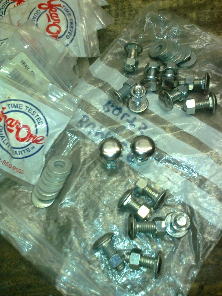

Anyone got any bumper iron bolts? I've only found 3 :(
Bumpers still wrapped.jpg (129.25 KiB) Viewed 1059 times
Bumper iron bolts.jpg (135.05 KiB) Viewed 1059 times
Bumper dome bolts.jpg (183.22 KiB) Viewed 1059 times
