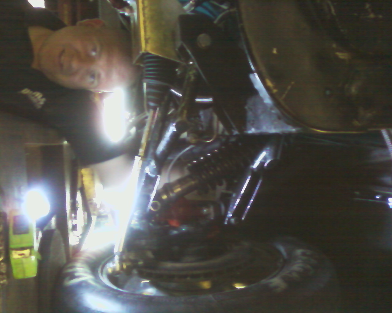

The last thing to bug me was the alignment of the new purpose built front end, it was giving some serious bump steer and after 2 days of trying to set the castor camber and toe on a set up that has never been done before was proving a real headache.
A good friend mentioned a small garage that could possibly help me and after a couple of calls I trailered the car all the way to the other side of town not 10 Min from my house.

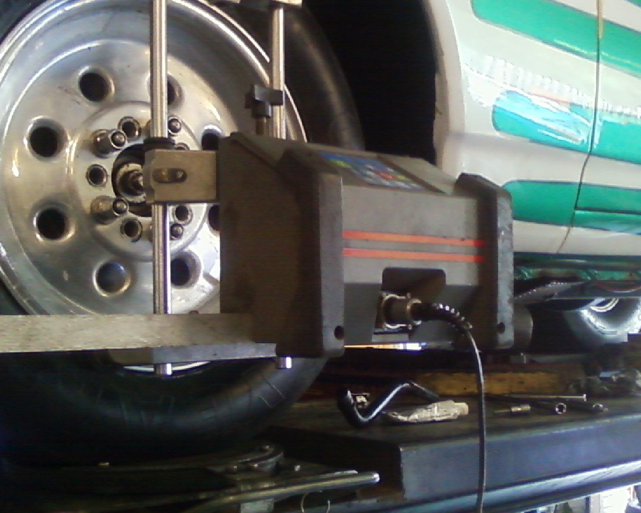

Wayne the operator got stuck in to the job and spent most of a day getting his head around my design and understanding the adjustments available which were basically a rose joint at the end of each A frame some top ball joint shims and the original Chrysler snail cams on the upper wishbone which I had assumed I would not be required and set them to max out position.

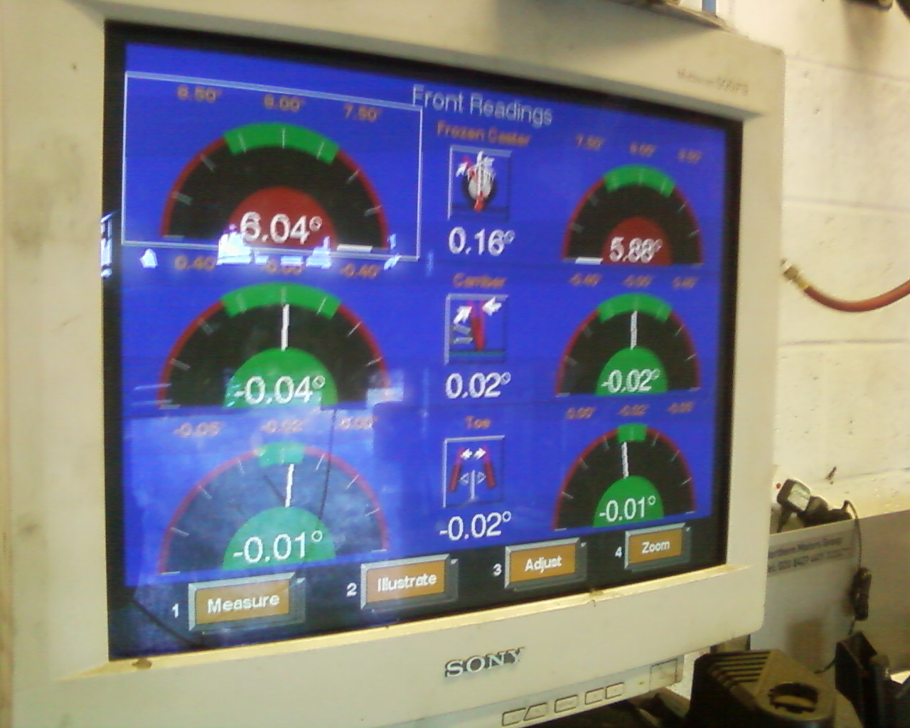

The rig he has utilises an attachment on each wheel rim and each attachment reads the others and talks to a computer.
It was a revelation to see the three axis come up on a screen and to see the effect tweaking each component has in real time, it was just fantastic.
To cut a long story short the drop down brackets I fitted to the front of the upper A frame were inducing the bump steer and making it impossible to get a starting point from which Wayne could dial in the front suspention.
So I removed the leveling brackets and all my adjustable rose joints were wound right in and locked off.
The good old Chrysler snail cams did the rest, those boys certainly knew what they were up to, the front cam did the castor and the rear cam set the camber.
Finally had to cut 10 mm off the passenger lower front a frame to induce a bit more castor and she now has 6deg of castor 0.2 degrees of camber and a smidgen of toe in, and almost no bump steer.
In addition raising and lowering the ride height, does not change the settings significantly.
