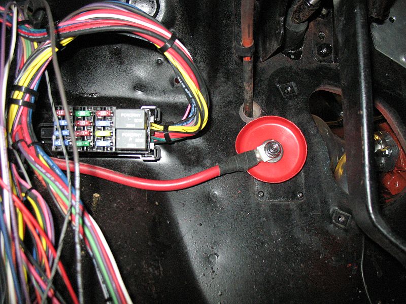

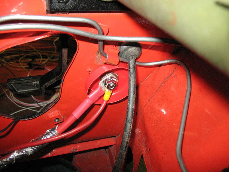

The battery is in the trunk and the battery cable used to route directly to the starter motor through a hole in the bulkhead.
I decided it would be more useful to make a terminal here that I could route extra equipment from rather than use the BATT terminal on the starter relay.
So I installed a large rubber grommet in the bulkhead that had only a small hole through it and installed a stainless steel stud.
On each side of that I placed two cut-down spray can lids as safety insulators.
So my battery now connects to this on the inside of the car and a short cable runs from the other side of this to the starter motor.
The alternator attaches directly to this point also.
The starter motor and alternator connect to this side.
Battery cable to the inside under the dash. Two smaller (fused) cables will go on here too.

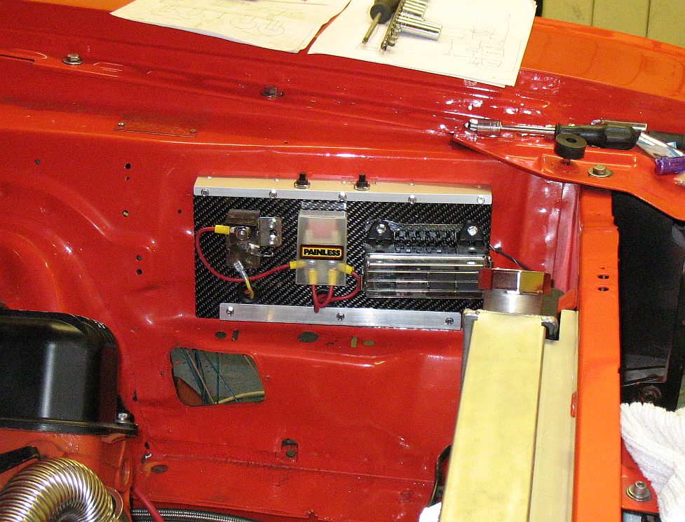

This is my main electronic board for the engine bay. It houses the starter relay, main 50A Fuse, two 30A circuit breakers (fan and headlights), and three relays (Fan, low beam, high beam). This bit is now fully wired except for one wire that will go to the neutral safety switch.

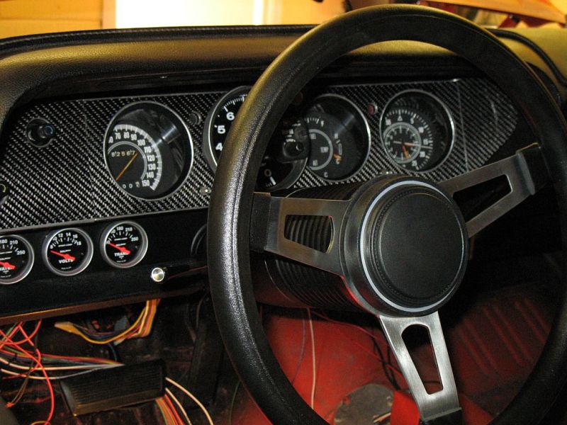

Cannonball wrote:yep onwards davey boy, the dash looks great, and i always liked your row off smaller dials low down,
Yeah but three each side of the steering column was a bit OTT so I have replaced the right hand three with a decent wireless. I fitted one of those dual voice coil speakers in the dash center and two on the parcel shelf.
The 50w RMS power output sounds very nice. :D

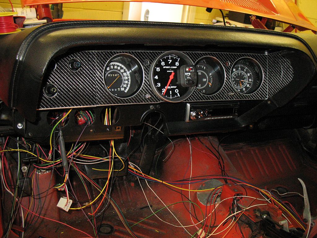

I am so tired though. I have been trying to wire up those three gauges and tie in the cluster wiring from the dimmer so everything dims as it should. But I am tired so i keep getting confused. I am still not well enough to work like this.

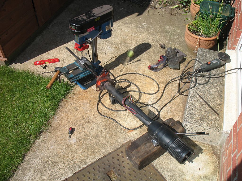

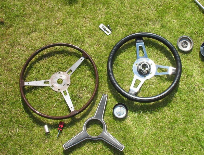

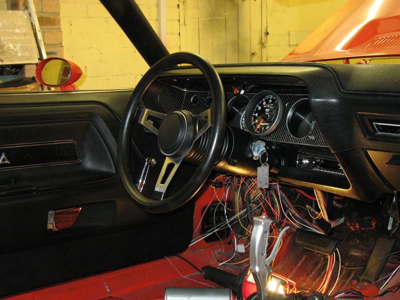

I painted the steering column today and fitted the new Grant Steering wheel which I like very much!
It feels much better in the hands than the original wheel. I have to wire up the steering column next and start a tidy up on the wiring I have done under the dash so it all tucks neatly (I hope) out of sight.
Old vs New.
Old vs New.

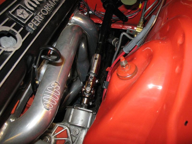

Fitting a Flaming River steering coupler in my sophisticated fully equipped workshop.
