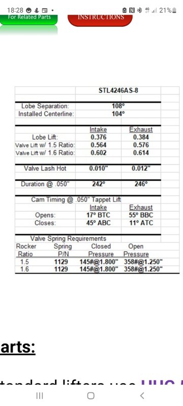

Re: Dave's 72 Dart
Here you go Blue:Blue wrote: Tue Aug 16, 22 9:16 pm Converter needs to match your cam choice and you won’t be choosing one that needs 5000 stall speed unless you’re going radical…

Re: Dave's 72 Dart
oh similar to to mine
109 LSA
248/252 at 0.050
284/289 adv.
centre line 106
this was no.2 in a list of 6 performance grind solid flat tappet cams for my hemi 6 getting more extreme as the numbers went up . grinder inisted that a considerable CR hike from standard 8-9:1 , webers and 3.5:1 gears were the way . shifted the power and torque up the rpm range 2700+ it was marketed as a street/strip cam
thIs grind was no.4 in the list for v8 if applied to a V8 cam shaft
why 1 grind should be considred a little more fruity across two engines i never worked out.. potentially CC/cylinder or due to rocker ratio (1.72:1 standard for me) and intalled height. dunno. i do have an engine where it would be extremely hard to get a valve to hit a piston......maybe thats it, no piston crown-valve clerance work necessary to fit???.
dynamic CR is key....

Re: Dave's 72 Dart
Thanks chaps.
I was thinking Hughes 3000 or 3500, so the numbers you suggest Blue are where I expected it to be.
Dynamic CR is around 8.2:1 by online calculation Dave, with the above cam.

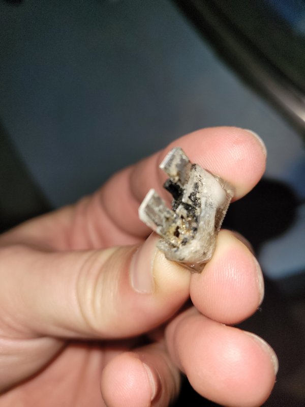

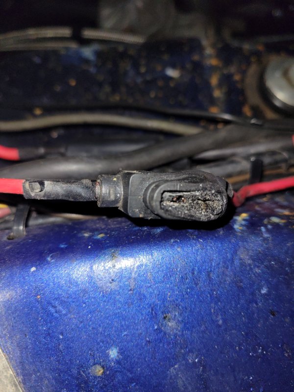

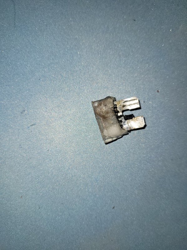

So decided to take it out for a quick trip down to Ludlow to get some V8 goodness. Usual thing is to hold it on the starter for 10 seconds to get a bit of oil circulated. It kicked once and died. Tried the key again and nothing. Opened door and noted interior light was no longer on.
So guessed it was the fuse not the 6 month old battery.
Got rid of the old fusible link when wiring 6 years ago and replaced it with a blade fuse. Took off the protective cover and found this......
Think that's a long term heat buildup, not a freak from today, its just finally blown. The fact it melted into the holder is a bit concerning.
Couldn't find my spare fuse holder, so online shopping for tomorrow delivery. I will drop the new one in with another 25A fuse and keep an eye on it. Need to check my AA cover and fire extinguisher is still good.

Re: Dave's 72 Dart
have a look at maxi fuses and holder mate, plenty on ebay etc

Re: Dave's 72 Dart
Agree, I’d at least use a midi fuse for that kind of job.
