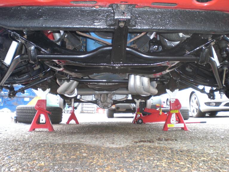

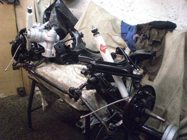

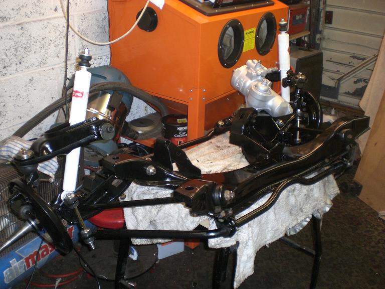

Spent the whole day re-assembling the axle and front suspension and here are some photos.

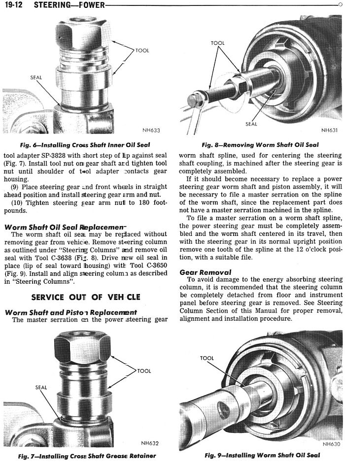

Dave any advice on replacing the steering shaft seal on power steering box as after i put it back in the car it started to leak and now i have to take it back out to fix it. I love all these set backs

You can do it with the box in place but you still have to remove the steering column. Not actually ever done this job myself though. It is called the worm shaft seal.dawesapd wrote:Dave any advice on replacing the steering shaft seal on power steering box as after i put it back in the car it started to leak and now i have to take it back out to fix it.

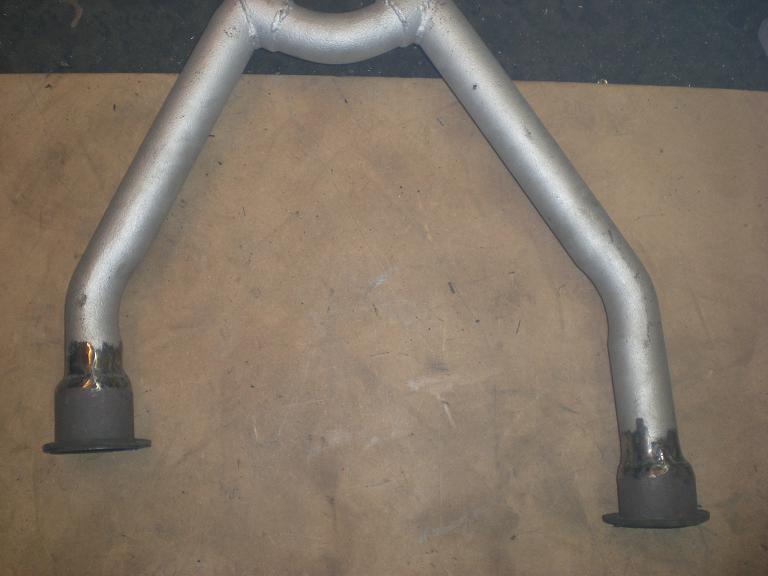

problems with exhaust link pipe

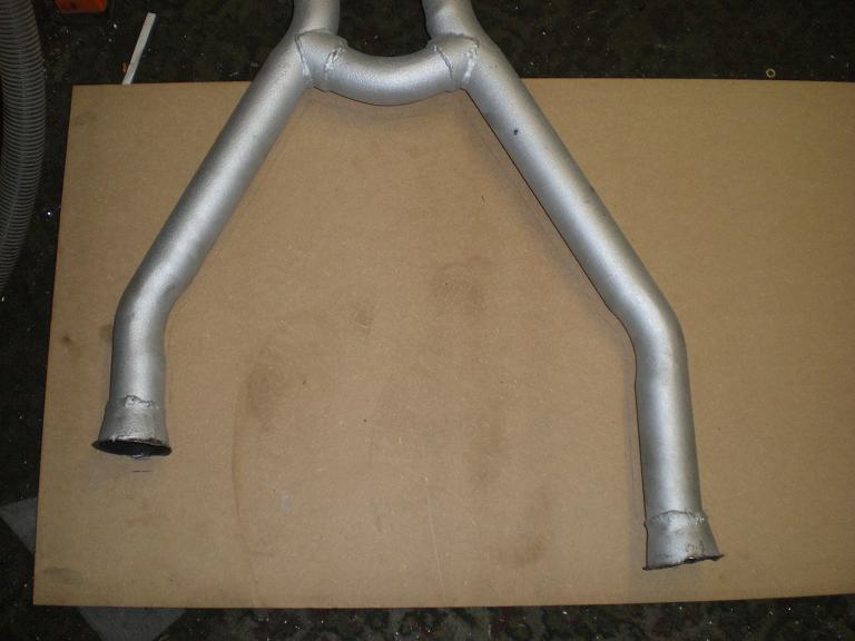

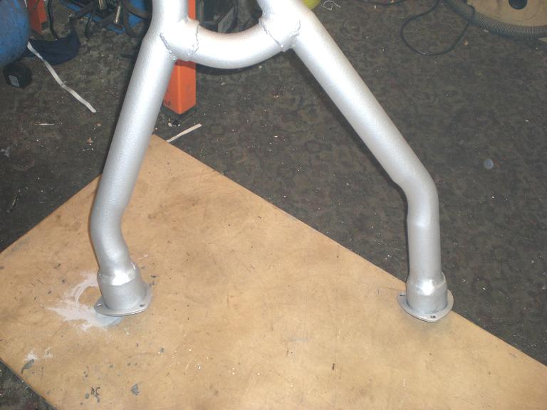

I got a new set of header off Baccaruda and fitted them yesterday and when i went to fit the link pipe to the silencers i noticed that the link pipe was running off center to the car and realized that one side was about 20mm longer than it should be. to fix the problem i cut off the old connectors on the link pipe and the cut the end and flared out the end. i the cut the collectors off my old headers and welded then in place making sure the short side was 20mm longer and problem solved i hope.

- new coat of paint and job done
- 3.JPG (86.5 KiB) Viewed 2115 times
- old header collectors welded on
- 2.JPG (65.65 KiB) Viewed 2115 times
- before with old home made connectors on
- 1.JPG (68.56 KiB) Viewed 2115 times

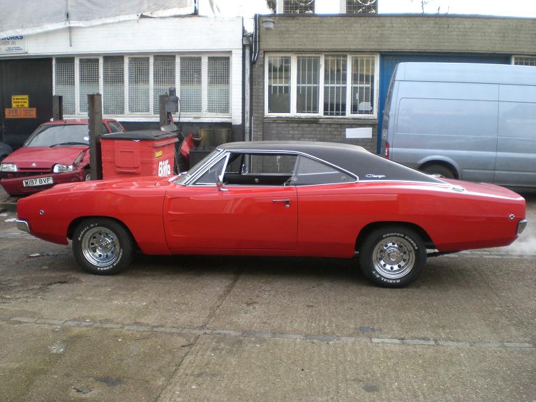

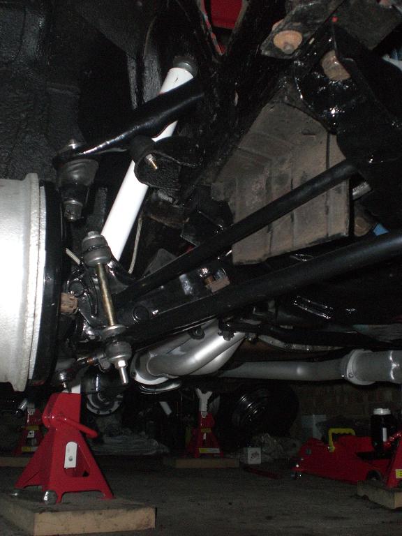

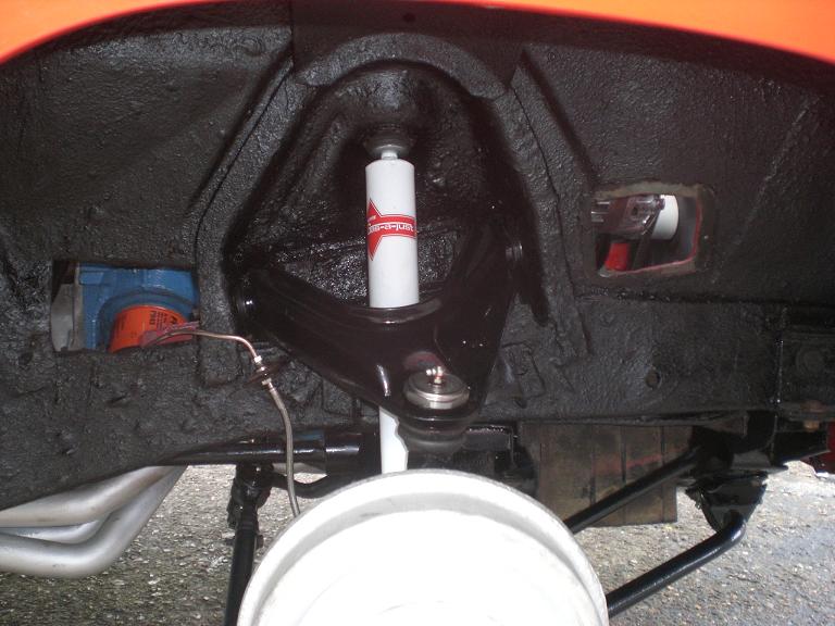

The car is all back together and back on its wheels.
I'm still waiting for the steering box seal which will hopefully be hear next week. the ride height is perfect and my drum brakes are far better than they have ever bean.
- Back on her wheels and boy i like hear stance
- 10.JPG (114.1 KiB) Viewed 2066 times

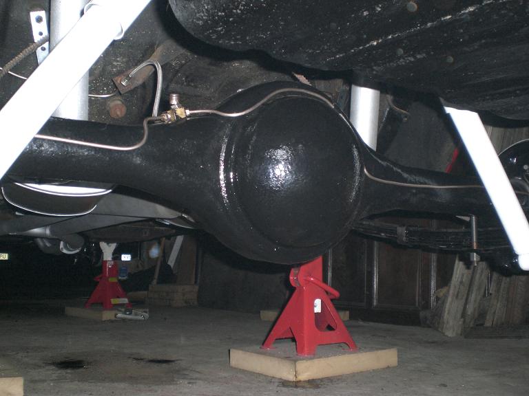

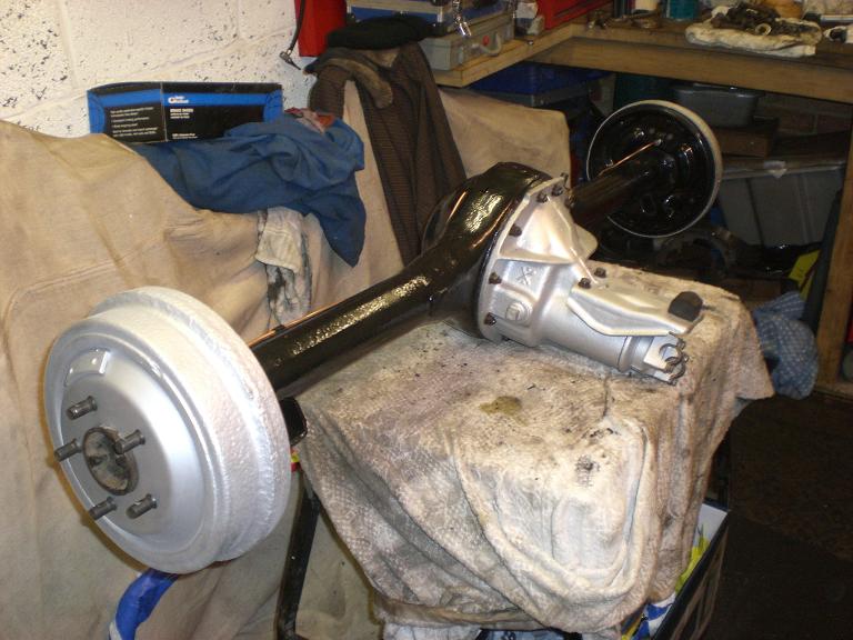

- rear axle
- 6.JPG (92.14 KiB) Viewed 2066 times
