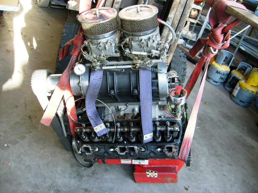

Dave Dillyboo is still building a 408 stroker for me but that won`t be ready for some time due to waiting on some of the bits.
So I grabbed this to put in the Valiant short term. Needs a bit of a tidy up ; new sump, new gaskets, new water pump, new msd dizzi, new blower belt then it`s good to go. Will have to temporarily move fuel lines and radiator to accomodate this.

whats that been in and done jon ???? size
Is that the 360 that was for sale recently?

dunc
light duty, was in a road going 32 ford hotrod, owned by a 70 year old guy so wouldn`t have seen any hard life.
360 c.i. + 6/71 blower + twin 600 carbs ... nicely built with all crower and manley bits

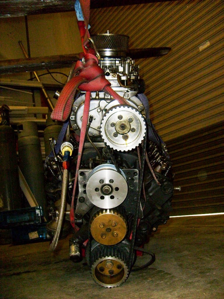

Need to check pulley alignment too as the belt seems worn on one edge .. don`t know if this is normal ?

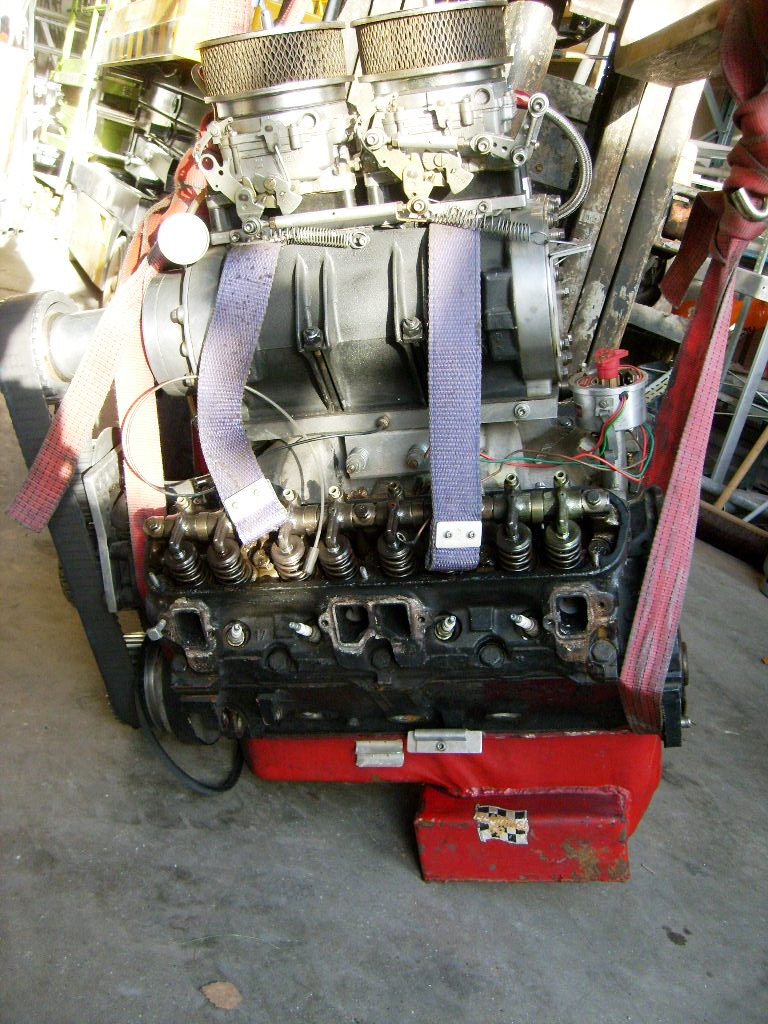

Either 273 or T/A rockers there, or are they after-market??
ANTON
Posts: 2046
Location: Sutton,Surrey
Post by ANTON »
Pete wrote:Either 273 or T/A rockers there, or are they after-market??
Look like 273 rocker as I have a set to go in my new build.
Either 273 or aftermarket rockers, T/A ones are offset. Unusual looking 2 piece blower case, 6/71's I've seen before are one piece, not that I know anything about them. I didn't think you'd be able to resist that one Jon!

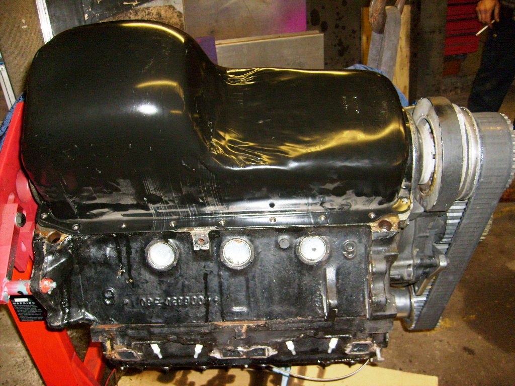

Started making my new sump today to clear everything, starting with a new passenger car sump. Will be adding my own baffle plates and remaking oil pick up tube.
Hope to get the engine in next week or just after Christmas.
Don`t let anyone tell you smallblock stuff is cheap or easy, always seem to have to modify stuff to get it in
