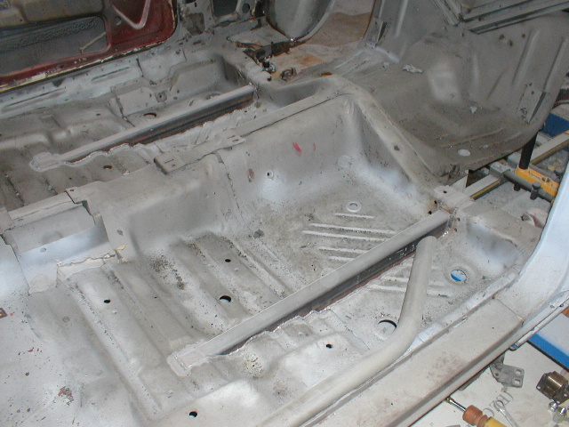

spent the weekend measuring and cutting, have removed the rear chassis legs, will put new rails in from torsion bar crossmember,ready for new suspension.
no rails.JPG (147.59 KiB) Viewed 1634 times

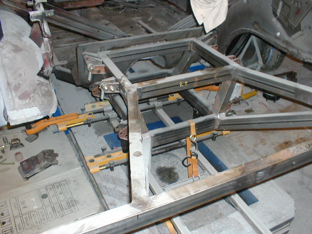

74challenger318
Post by 74challenger318 »

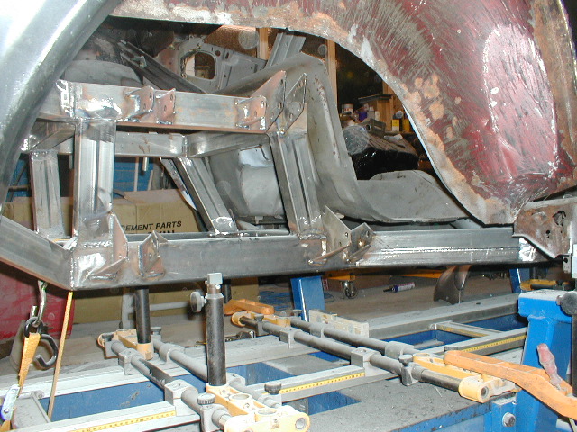

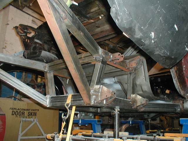

update on progress,not done much due to other priorities, frame rails are in and started to build up the rear frame and suspension pickups,
did some research on the btr differential which i was going to use at first on a n/a engine, and now with the extra power decided to go with the viper diff.

74challenger318

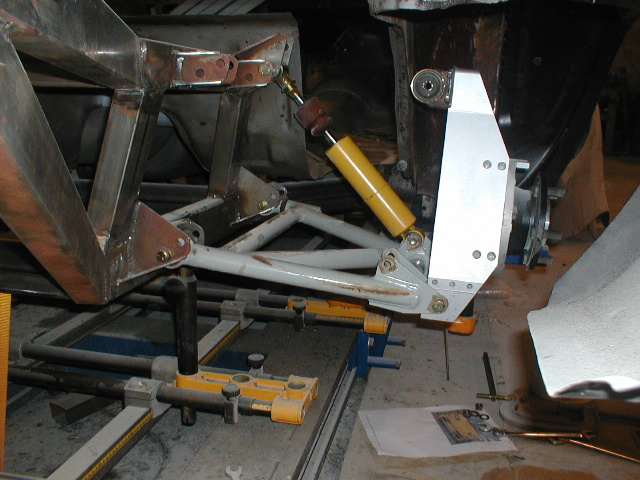

finished suspension pickups on one side, just need to fab up some upper arms.will get some better pictures and clean off the bog dust, when i can get round it :)

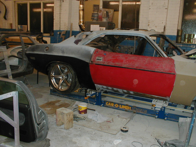

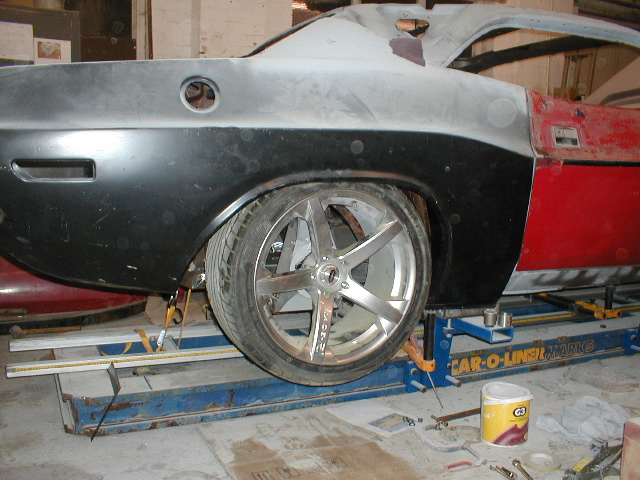

74challenger318
rear wheel mounted, this will be the finished ride height , have left enough clearance arond frame for wider wheels, these are 10x19 with 285 tyres will go to 315 or 355, dont really want to raise it as the way i have angled the upper and lower arms the centre of gravity is 1 inch above ground height.
