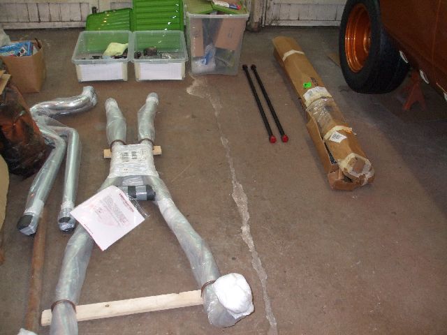

more stuff to fit! Sadly i started with the torsion bars - which is as far as i got.

Aftermarket torsion bar fitment abandoned. I found the originals, cleaned them up and painted them.
Fitting time - 10 mins :) Aftermarket tat to the bin!

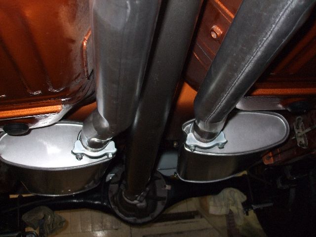

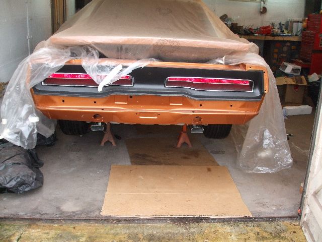

Time for some pics :)
Exhaust and assorted other stuff fitted underneath. Sore neck now :( I remember why i have ramps at work!
Anyway with that all done it was time to drop it back on its wheels for the first time in over 11 years!!!!!
Little low at the front at the moment, (needs adjusting) little high at the rear (lack of weight).
Damn camera shows up all that dust underneath. Will have to get the duster out.

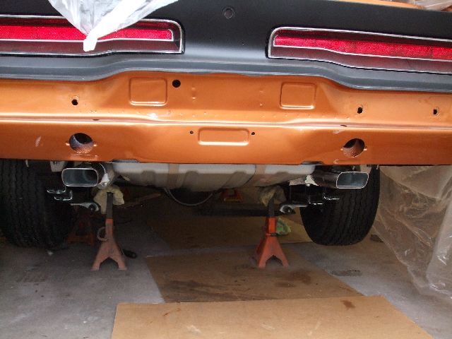

Close up of finishers

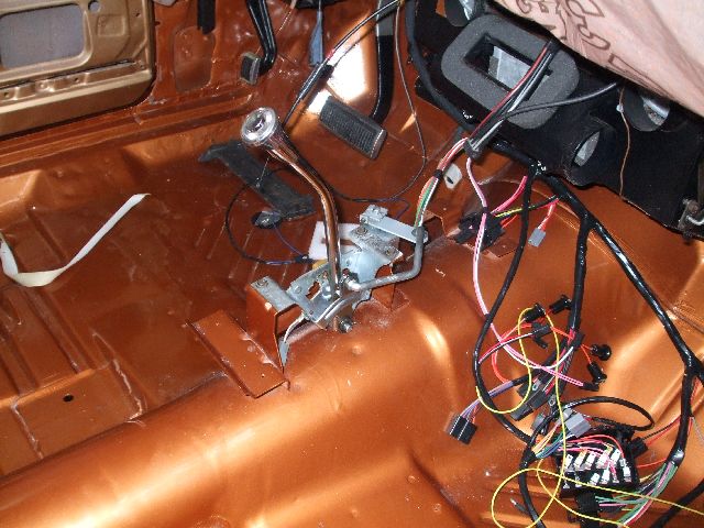

Knob fitted. Knob polished :shock:

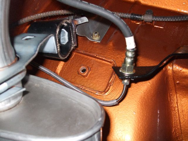

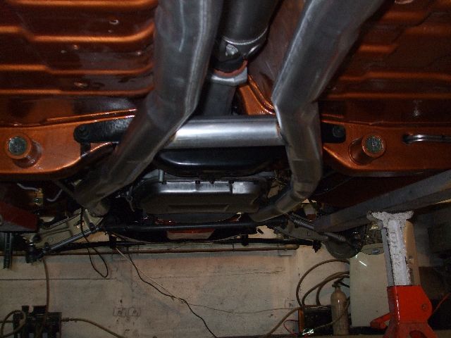

Exhaust

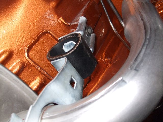

Posts: 868
Post by Roger »
hanger

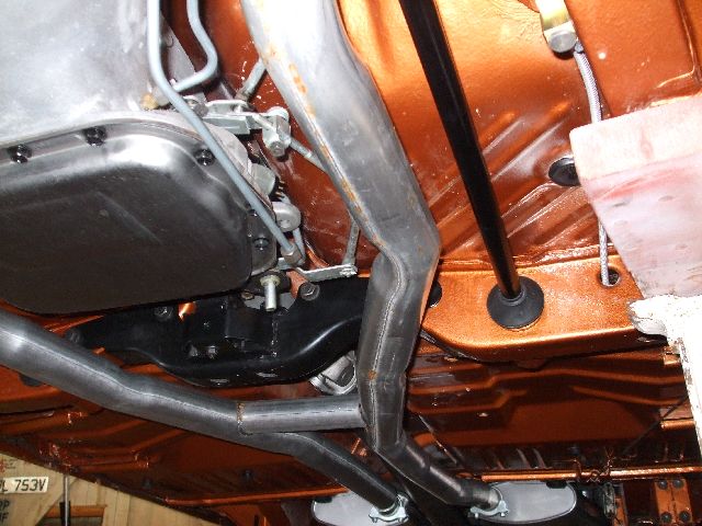

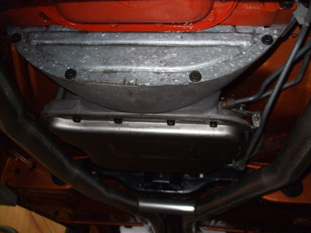

Shiny new gearbox oil pan. A nice repro.
