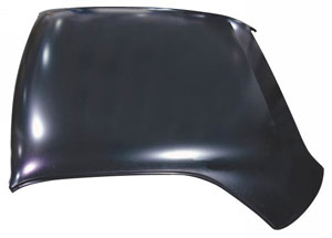

Matt...............................get a new roof skin from AMD and put it on :roll: :roll: :roll: $550.00
Posts: 5893
A new roof skin is a nice solution, but not in my budget, and I do like the idea of keeping the sunroof as it was factory or dealer fit.

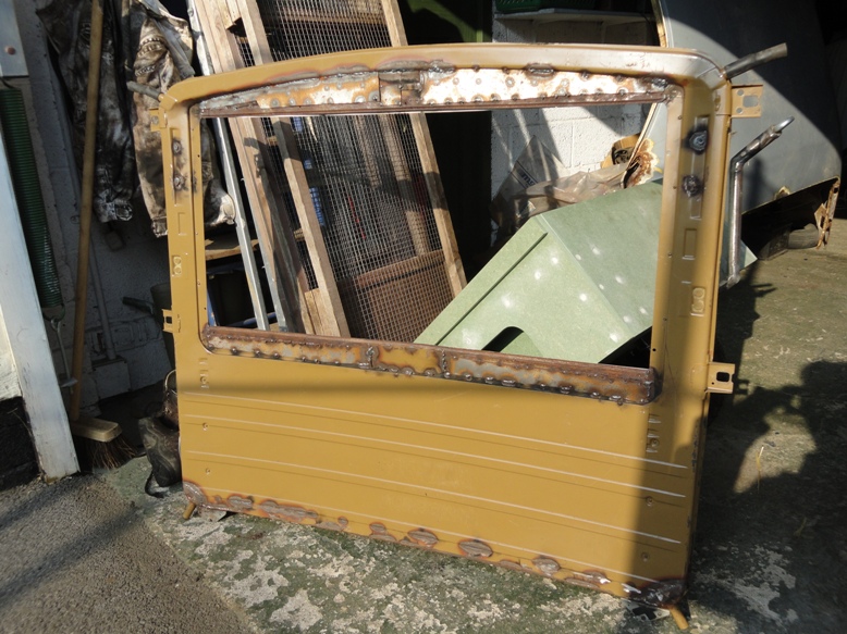

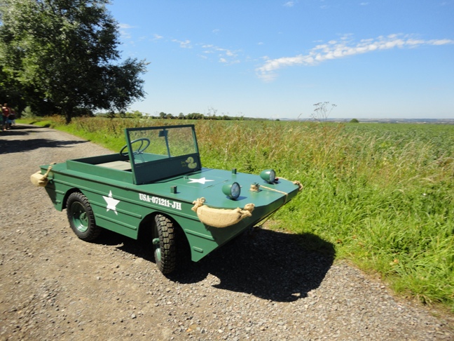

Matt whats the Green thing under the blue sheet can i have it i think i would like it ;)
Posts: 5893
autofetish wrote:Great work keep the pictures coming
Its a battery powered 1/2 scale Ford GPA. Its basically Toylander running gear with a scratch built body by Jack and I to look like a WW2 amphibious Jeep.
http://www.toylander.com/

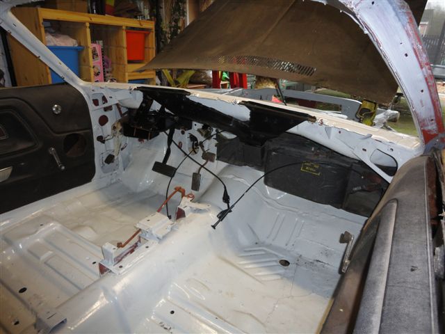

Done a little bit more in the cold snap. Sunroof tray is now all seam sealed, painted with smooth Hammerite and bolted in place, slide mechanism all greased up and re-fitted.
All de-rusted with wire brush wheel in the grinder (messy!), seam sealed and painted prior to tray install.

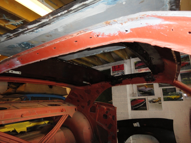

Showing adjustments to Rover tray to fit Challenger aperture.

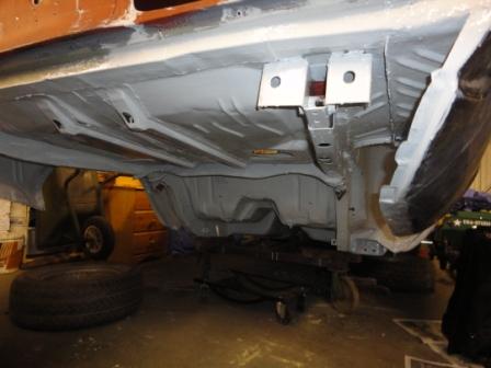

Underneath mostly topcoated in light grey now, shell welding all done.

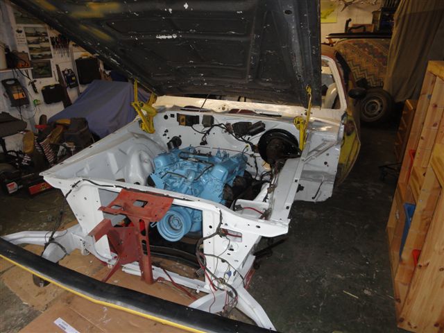

Posts: 5893
More progress. Engine onto K frame and bolted on, awaiting transmission.
Heater box in, dashboard next.
