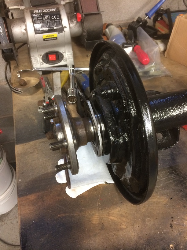

last one for now, new Green bearings installed and hubs cleaned up, threads chased, except the ones which go the other way as I don't have the right die for them!

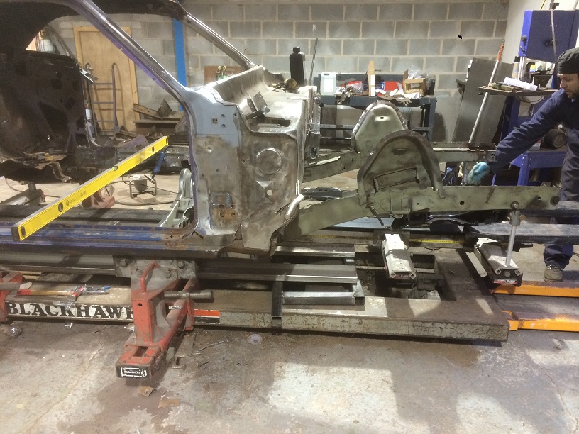

so that's all for now, plan is to clean firewall up and fit the last patch panel, inner sills are repaired and need filing down and prepping. Radiator support and cowl are away for blasting, subject to anything more than dust coming back from the blasters they will be patched and spot welded back on.
The frame rails are going to be tacked in place and front end assembled somewhere down the line so I can put the measuring jig back under and make sure they are perfect before fully welding them back in.

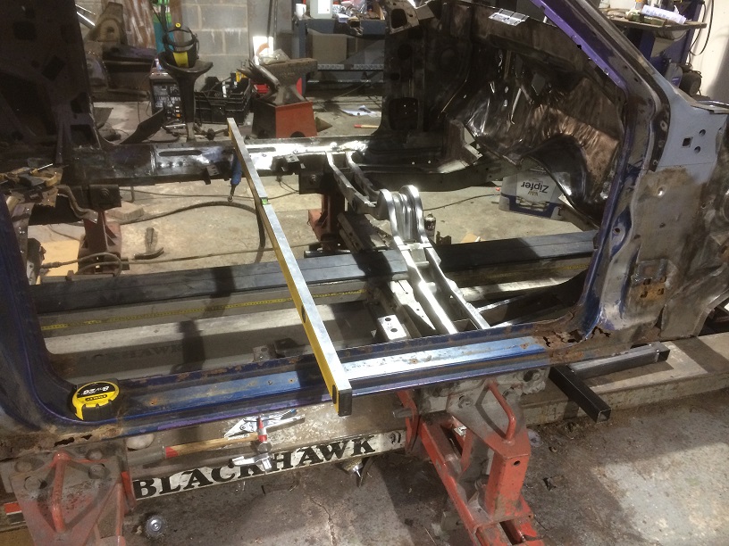

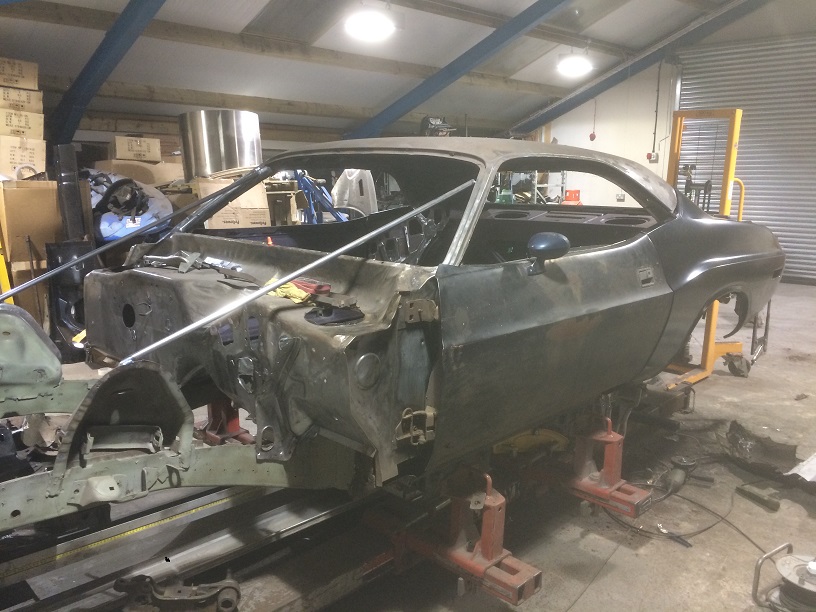

More progress photos, been so busy with the car that I've not had chance to post!

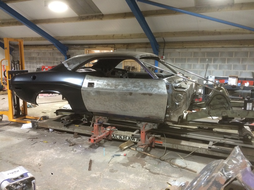

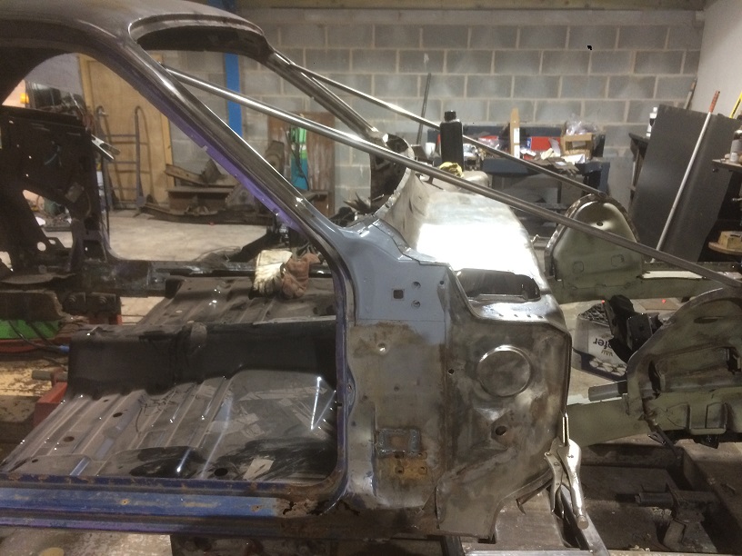

Engine is now away for rebuild, doors and quarters are on to check alignment before welding everything up. Front and rear chassis are tacked/clamped in place whilst every panel is fitted. Then I'll measure the chassis, hope that everything conforms to the drawing, and then weld everything up.
Most of the rust is gone although I am starting to think it might be easier to find a replacement drivers door than recreate the bottom 4 inches of it!

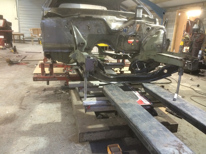

some measuring
some measuring
testing the fit of the new front frame rails

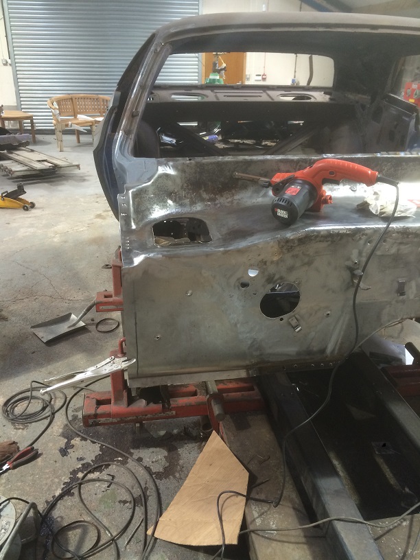

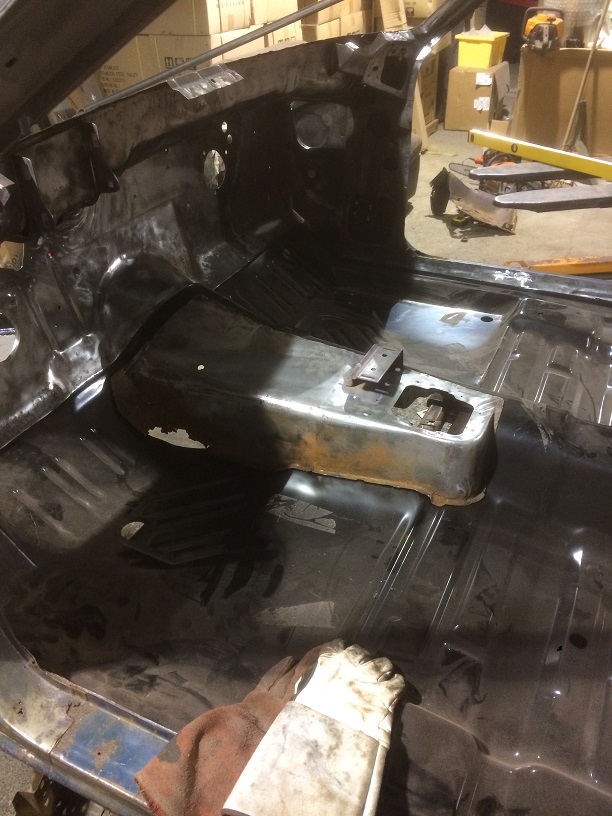

cleaned up passenger side of firewall, waiting to be welded to door post

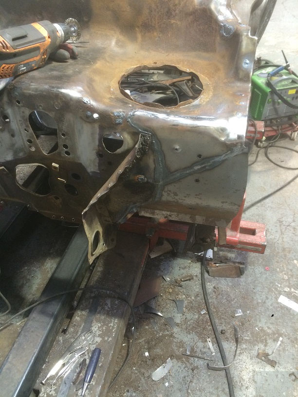

Repair to firewall on drivers side

test fit of floor pan, fortunately it fits!

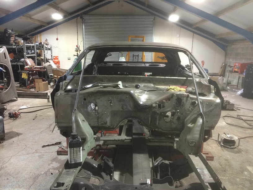

interesting set up at the front to add some rigidity whilst measuring even more

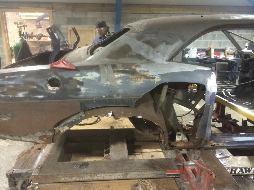

getting rid of rusty old quarters
more measuring
more measuring

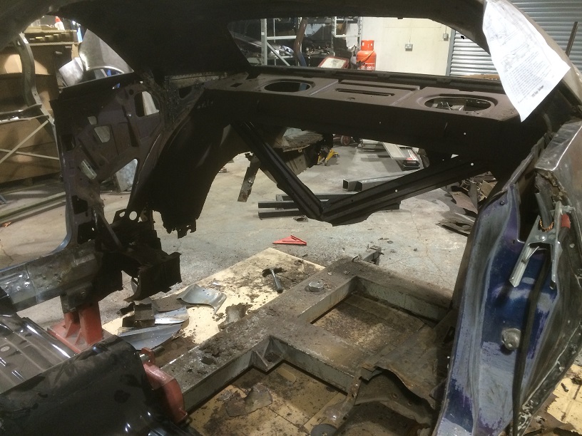

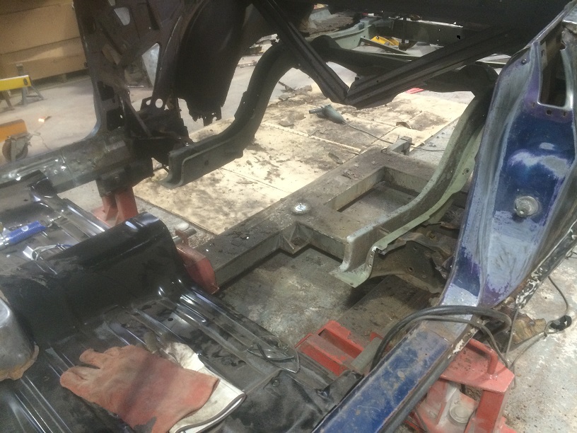

test fit of rear frame, with new wheel tubs, trunk floor, underseat floor, tail panel etc. Really feels like I'm getting somewhere, although it all has to come off
new frame repaired, brackets welded on and trial fitted
rear floor removed
rear floor removed
