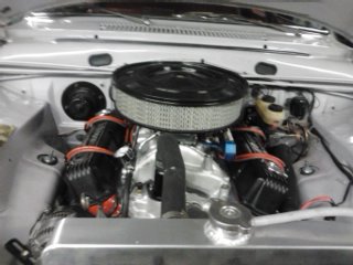

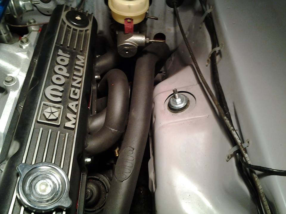

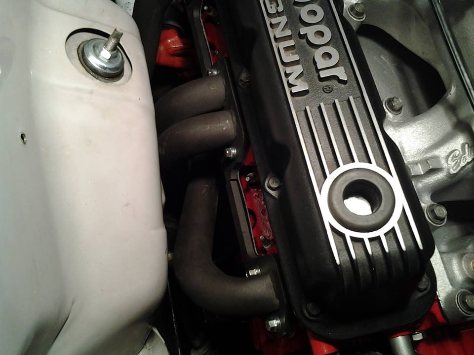

Post by terryr »
is there such a thing as A body sickness ,coz im getting that way ,since Christmas eve when the dart landed ,every bit of my spare time has been taken up ,and its getting me down now ,,but anyway headers are in and done ,air filter even clears the bonnet ,now to get the zorst sorted ,im going to farm this job out as I cant be bothered to roll about under it much more,still a never ending list of stuff to do ,but I need to make it move now to give me a kick up the arse

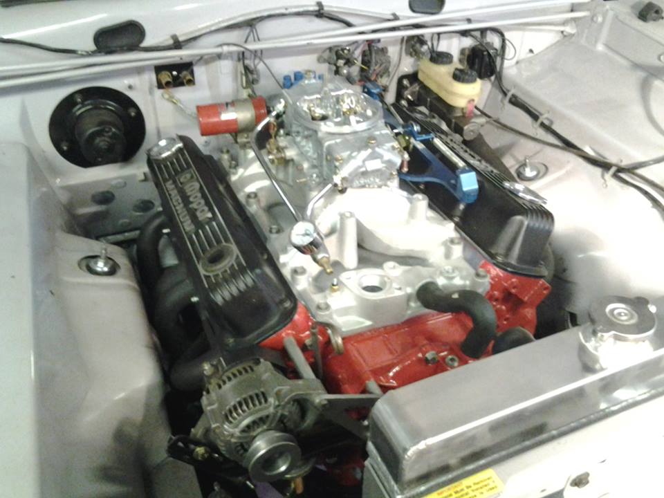

The battle goes on..gonna fire it tommoz..seem to be takeing more apart than putting together at the moment
