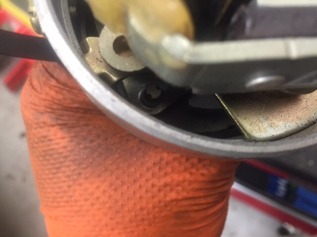

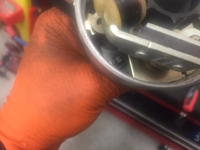

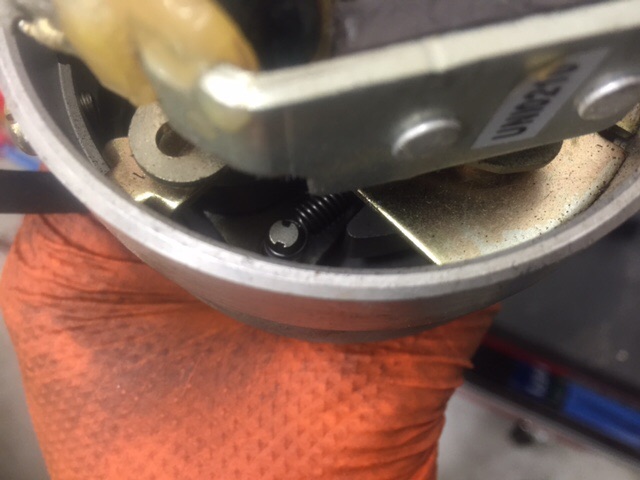

If I had to guess I'd say a spring is missing.😱
I took the dizzy out there are no marks. It looks like I have to remove a roll pin on a plastic collar on the bottom of the dizzy to get at the weights and springs.

Other side
Posts: 22109
Yes, looks like a Spring is off / missing, and you are correct that you need to knock the roll pin out.
The spring means it introduces more timing quickly, but there is a chance that there will still be too much disparity between initial and total advance, and the quickest fix while the Dizzy is apart is to put a restriction plate in......
